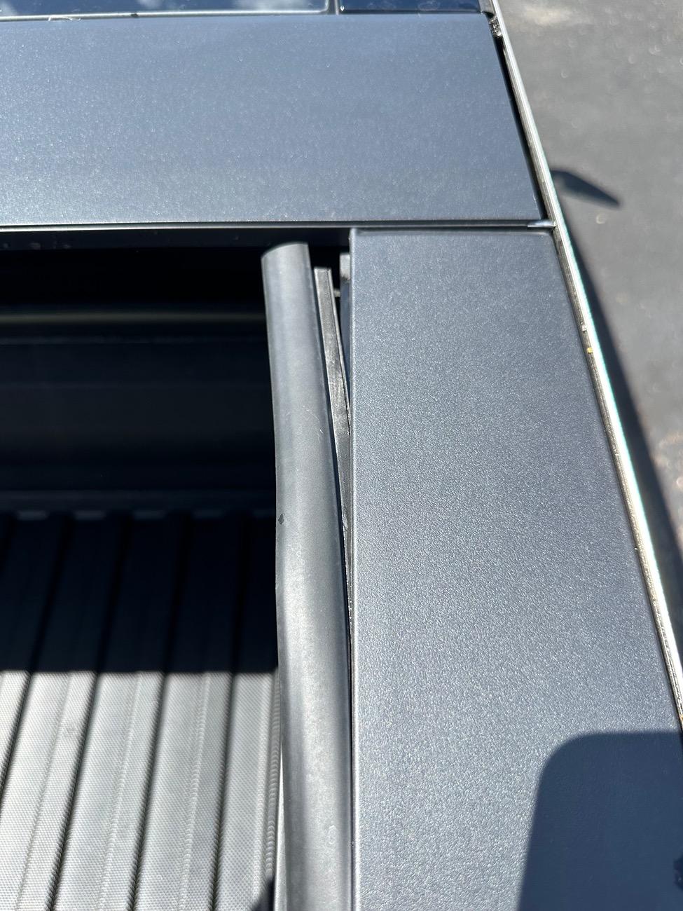

I saw the posts from @Stickercity about their textured precut vinyl plastic protection wrap. Sure many of you have seen the post here: https://www.cybertruckownersclub.com/forum/threads/?-new-diy-bed-protection-kit-for-cybertruck-toprotect-cargo-bed-surround-vinyl-wrap-kit-?.22158/
To start I really don’t like the OEM plastic trim, not that it looks bad, but it just scuffs way too easily. So I wanted to try to protect the trim around the bed and rear bumper.
Install was super easy, actually surprised how easy I was able to do it by myself. Took me like a total of 30 minutes to do all both kits combined. I was expecting it to be harder and take longer to get j use right with no air bubbles. I simply cleaned the plastic, then sprayed each piece down with water as well as the vinyl wrap. Apply and align. Finally squeegee water and air bubbles out.
Looks, I like it. I think it added some much needed depth and detail. Feels better protected now.
Overall very happy with the purchase. The only negative I have if any is well, it’s just a wrap, while thick, still won’t last that long should get 3 years from it. So wish there was a more permanent solution at a similar price, but for now this will due and I’m happy.
