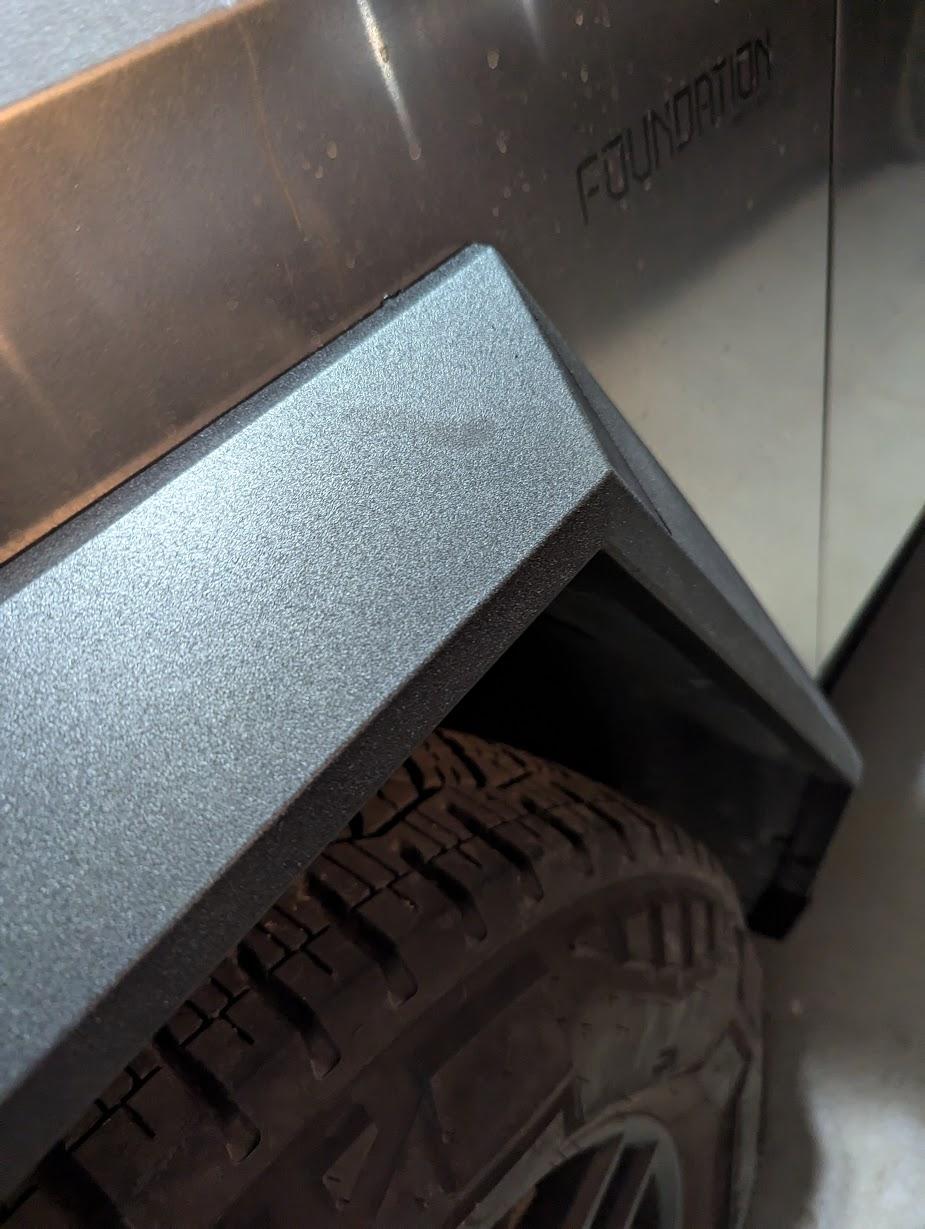

ooh, looks nice! (what's that rectangle in the 3rd pic)

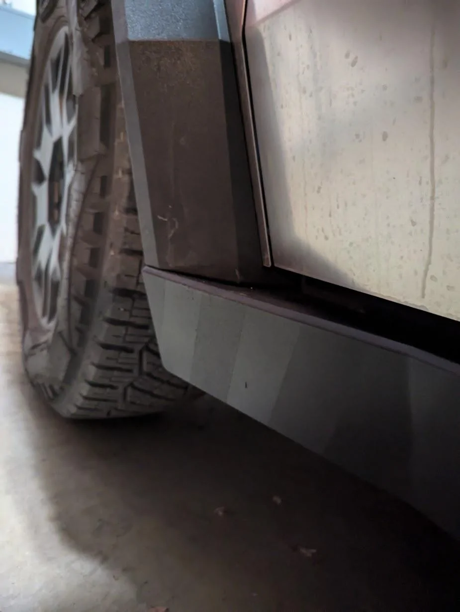

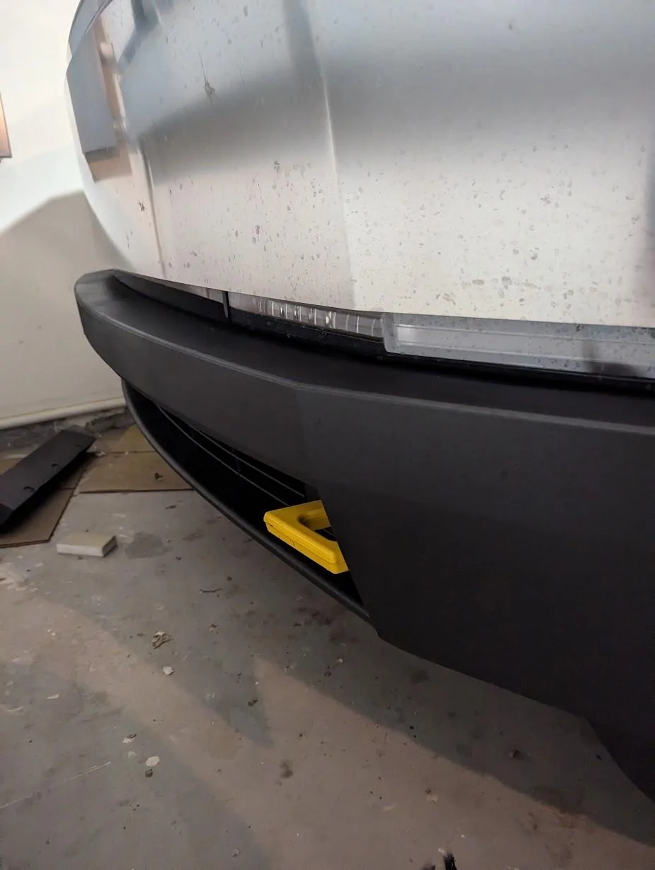

Interesting way to go. Considering how easy to remove all the all the plastic trim is, I just got some spray-on bedliner from home depot, threw all the plastic pieces on the lawn, and sprayed the hell out of them!
Do you have pictures of this on your bed surround?
jonesw67
Warren
Jul 9, 2024
288
378
AR
FS Cyberbeast
Sure, attached.
The bedliner is designed for plastic adhesion and cures as a very rigid "rubber" coat. By rubber I mean that is extremely hard to chip. Sure, you can scratch and gouge it like anything else, but it's much much tougher for things like sticks and branches that mark up the plastic easily. Will it make bumpers damage-proof? Of course not, but it does make them immune to basic cosmetic scratches and rock pitting that plastic is very sensitive to.
As for the look: without actually touching it, it looks completely OEM. But the texture is very rough and diffuses light nicely. I would compare the texture to used medium grit sandpaper, weird but that's the background I have to work with :ROFLMAO:
As for the stripes on the bottom trim, that was done intentionally with tape after a failed experiment.
Out of curiosity, I sanded the back bumper lightly and reapplied the spray bedliner in a location that didn't require me to remove the bumper. I am VERY happy with the repairability results. I can't tell that it was sanded and redone at all.
Here are the products I used:
https://amzn.to/3YUhsev
Cheaper option that I wish I did because it works just as well for this application:
https://amzn.to/4dXOZZC
Even cheaper option that, I'm told, is tougher and more long lasting, but requires know-how to work with:
https://amzn.to/3SZXWta
warning: don't do the clear coat liner, it doesn't sand/repair well. Stick with black or opaque color from whatever product you decide to use.
Cheers!
-t
Edit: Don't judge the dirty truck! I'm not a "wrap it and wash it 5x a week" type of truck user... Got a vineyard to run here.
Also the next image makes the dirt look like damage to bed liner. To be clear, I've been running very rough roads for about 2 weeks now with this setup, no scratches or even pitting on the wheel aero covers yet. Better than raw plastic so far.
