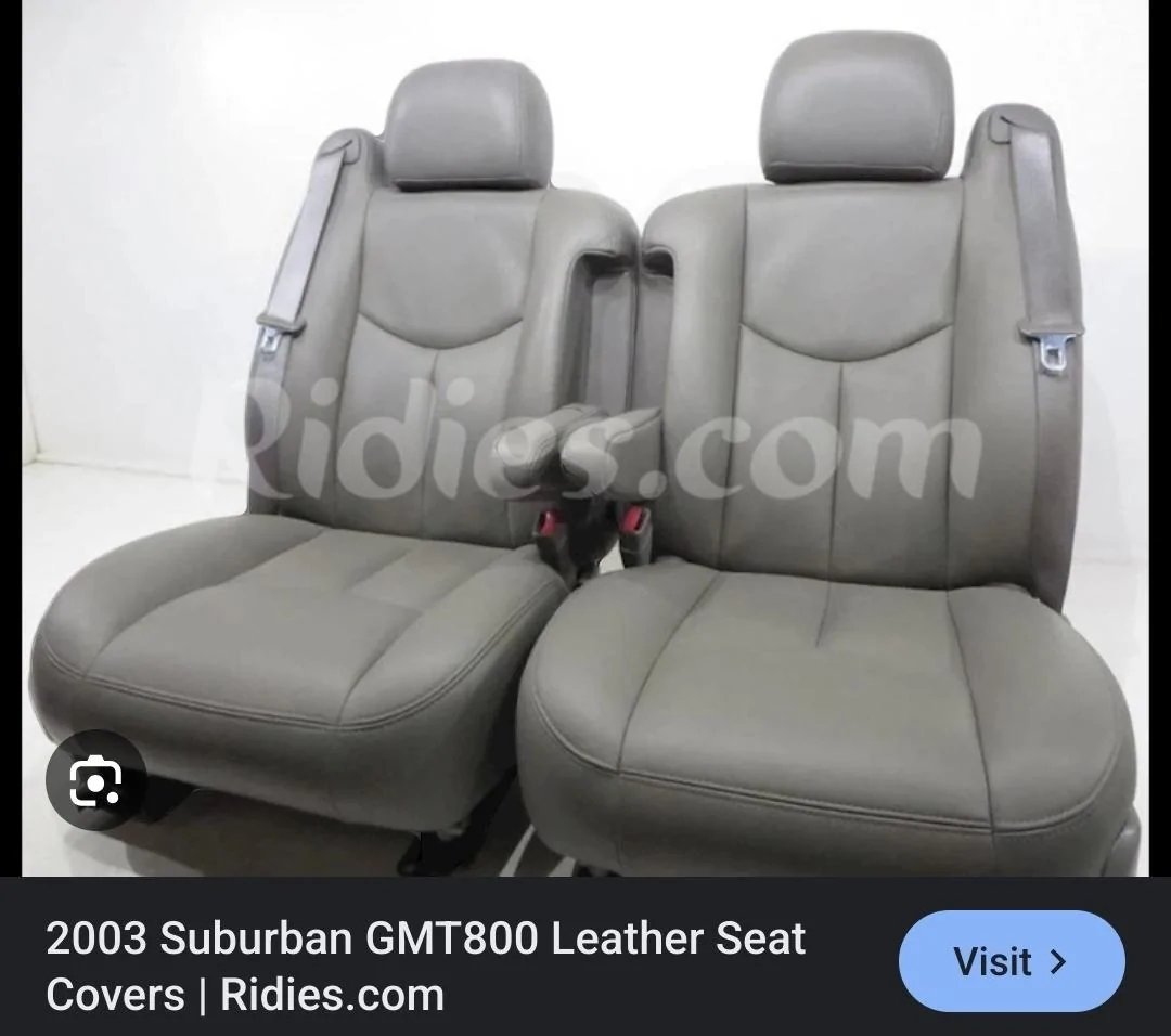

But a bench seat would require a center harness which would be very difficult to engineer without a thick roof structure which Is currently glass.
It would certainly be an aesthetic design challenge, but ABTS (all belts to seat) has been a design option for decades. I worked on the seats for the GMT800 twenty years ago with the belt integrated to the seat structure.
