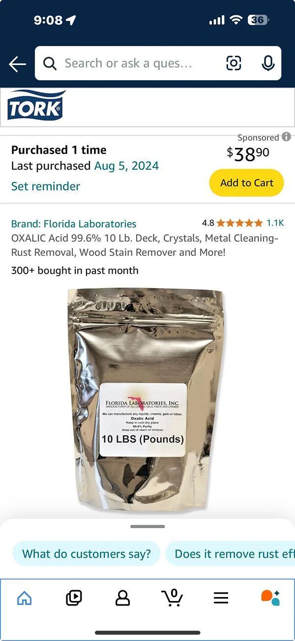

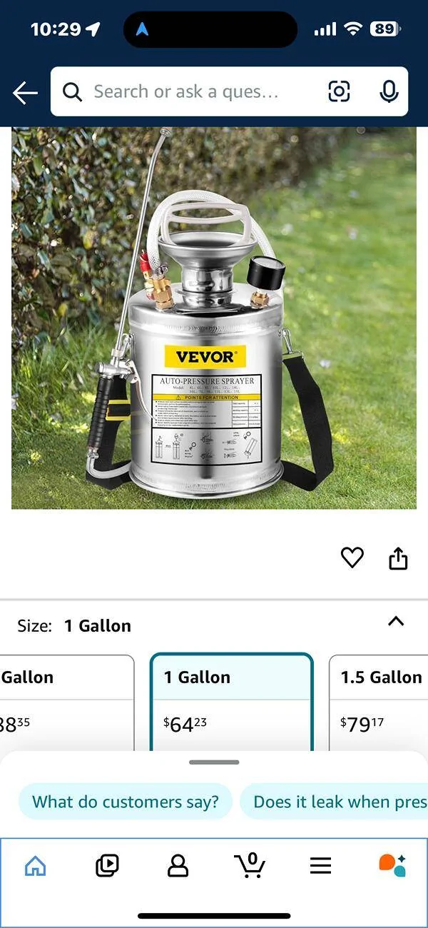

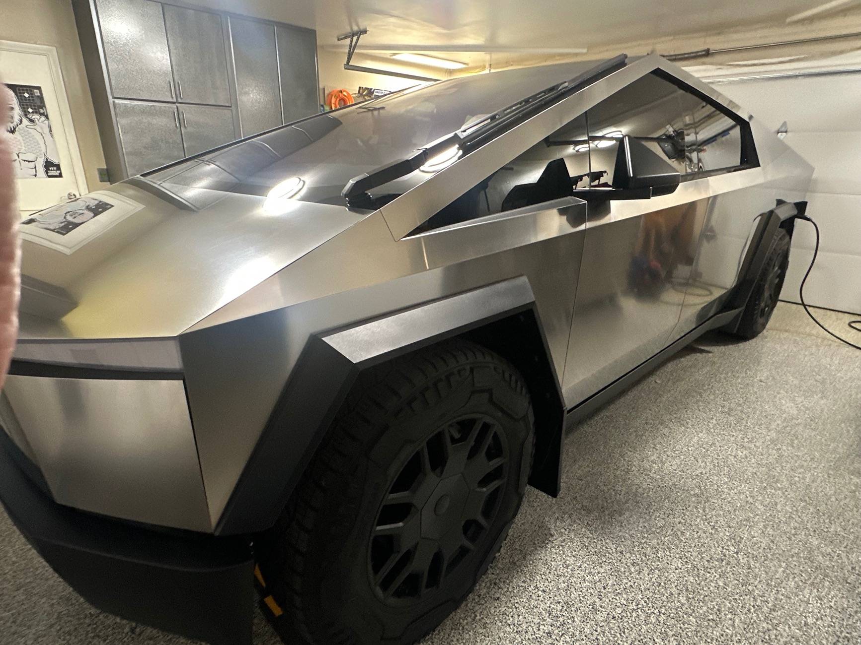

I wash it every couple of weeks. I spray on some diluted oxalic acid (barkeeper‘s friend) . I dilute it with water and mix it in a small sprayer I use about a quarter pound per Wash and run it through an automatic car wash Just after one minute of spraying it on or 5min It doesn’t really seem to work any better if it stays on there longer. And it looks just like new. The car wash I go to Has neutral PH on all their products. It is not an Express Car Wash or a gas station Car Wash. I would not recommend those As they all have high pH soaps. I’ve attached images of the product, the sprayer, and a photo of it just recently washed, which was yesterday. Adam’s graphing Tire dressing on the Tannu cover and the wheels on all the trim works great. Leather cleaner and leather treatment on the interior. I would NEVER wrap the Cybertruck as you have to hand wash it to maintain the warranty. 6k to wrap and 10 years of hand washing is not my cup of tea. I honestly like the stainless steel look . Once I figure out how easy it is to keep clean it’s not really an issue any more. So far I have about 12 times I’ve done this to the truck and it looks great every single time. I’ve heard of people saying they’ve cleaned it with barkeeper’s friend and it comes out really shiny So they’re scared to do it anymore. Well, that’s just because it actually clean And that’s how it looked when you received the truck from the dealer for the first time.
