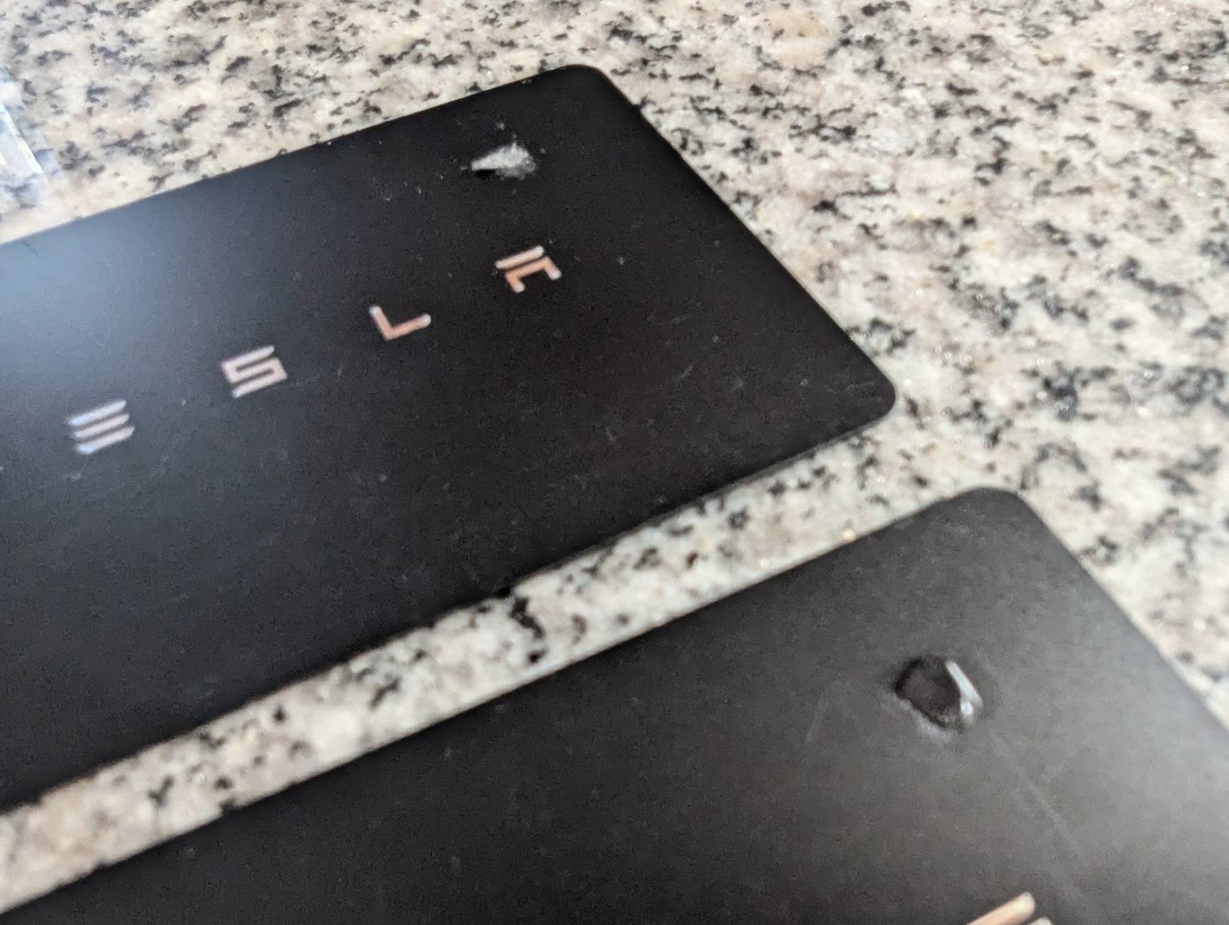

I took the keys to the dealership and they were bad keys. I can tell from the new ones that there was something wrong. You could sort of see the chip in the bad ones. Thanks all for the help!

Those look like they were exposed to excessive RF energy.
Not sure if this was the cause, but do not put both the keycard and phone on the center console charger simultaneously (ie card then phone). The phone charging feature overloads the key card.

Wow! Intriguing. It's possible I put my phone on the card they came in. They did put that card right in that spot both times, delivery and today.
