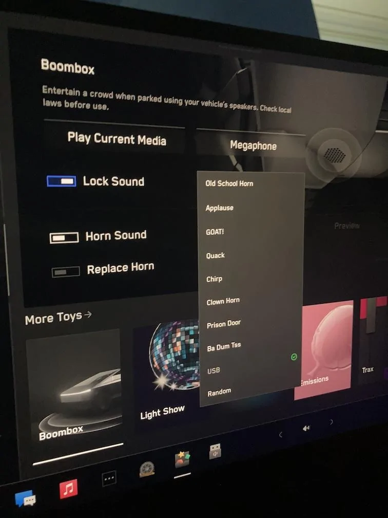

In my case, the Toybox shows the custom lock sounds only as "USB":
Tesla Cybertruck Lock Confirmation Sound IMG_3156
If I recall, I had to change it to something else, and then change it back to USB. It does appear to cache the custom sound, so that it will still work with the thumbdrive removed, so selecting a different sound "flushes" the cache.
