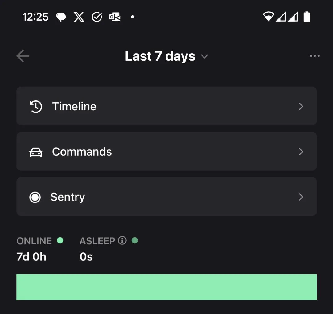

My Cybertruck hasn't slept more then a few minutes since July/August, according to Tessie. Every time I check the Tessie app there's 0 or 1 minutes of sleep time in last 7 days. I have Sentry disabled at home and work. I'm wondering if this could be happening to you and related? The energy app in the truck, in the Park tab, shows mobile app usage draining the battery. I ended up uninstalling the Tesla and Tessie apps from my phone and watch, and then the energy app in the truck showed less mobile app drain, but Tessie still showed the truck wasn't going to sleep. The only think I didn't try was disabling Tessie polling, but if I did that I would have no way of knowing if the truck was sleeping.
I think Tessie is waking the truck every time it polls.
The Tesla app will tell you how long it has been sleeping.
