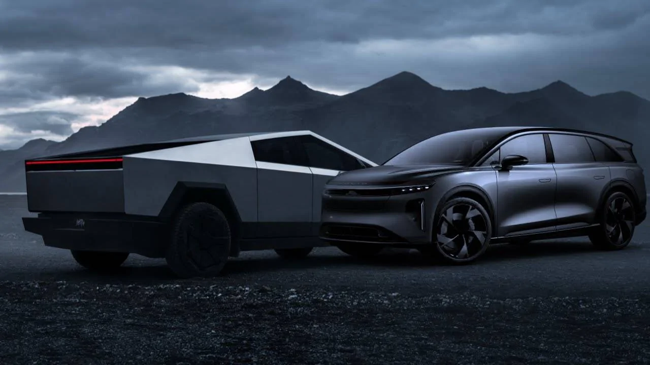

If battery size is the same, and CT battery of 123kwh gives 300mi range, then Lucid’a range (considering all other details the same) should be (0.33/0.24) * 300 =412.5 miles. Even with motors a smidgen more efficient one couldn’t get to 500mi. So something isn’t right or … we just don’t have all the details :)

You need to also adjust for the frontal crossectional area. A sedan with the same Cd as Cybertruck would get better range.

Tesla fanboy here. I see the new Lucid Gravity SUV has a 123 kw battery pack, same as the CT, but a claimed range of 450 miles. I figure that’s a legit number based on their sedan history. I’ve always been disappointed with the 310 mile range of the CT. Why would their range be so much better?

Ah yes true, i figured they are in ball park - too lazy to get too serious with these numbers but ok here we go (still rough numbers, just grabbed them from the forum).
CT; 80 x 75 ( includes tires)
Lucid 78 x 65 (tires included?)
Drag factors:
CTf 80x75x0.33 =1,980
Luf 78x65x0.24 =1,217
drag ratio: 1217 / 1980 =0.615
lucid’s estmated range as compared to CT: 300/0.615 =487mi. So yah, in range of the adverticed 500mi. Clealy drag (and size) explains most of what makes the range difference.

Frontal crossection theoretically includes everything including exposed tire profile and side mirrors, but treating it as a rectangle is much easier for rough estimation!
