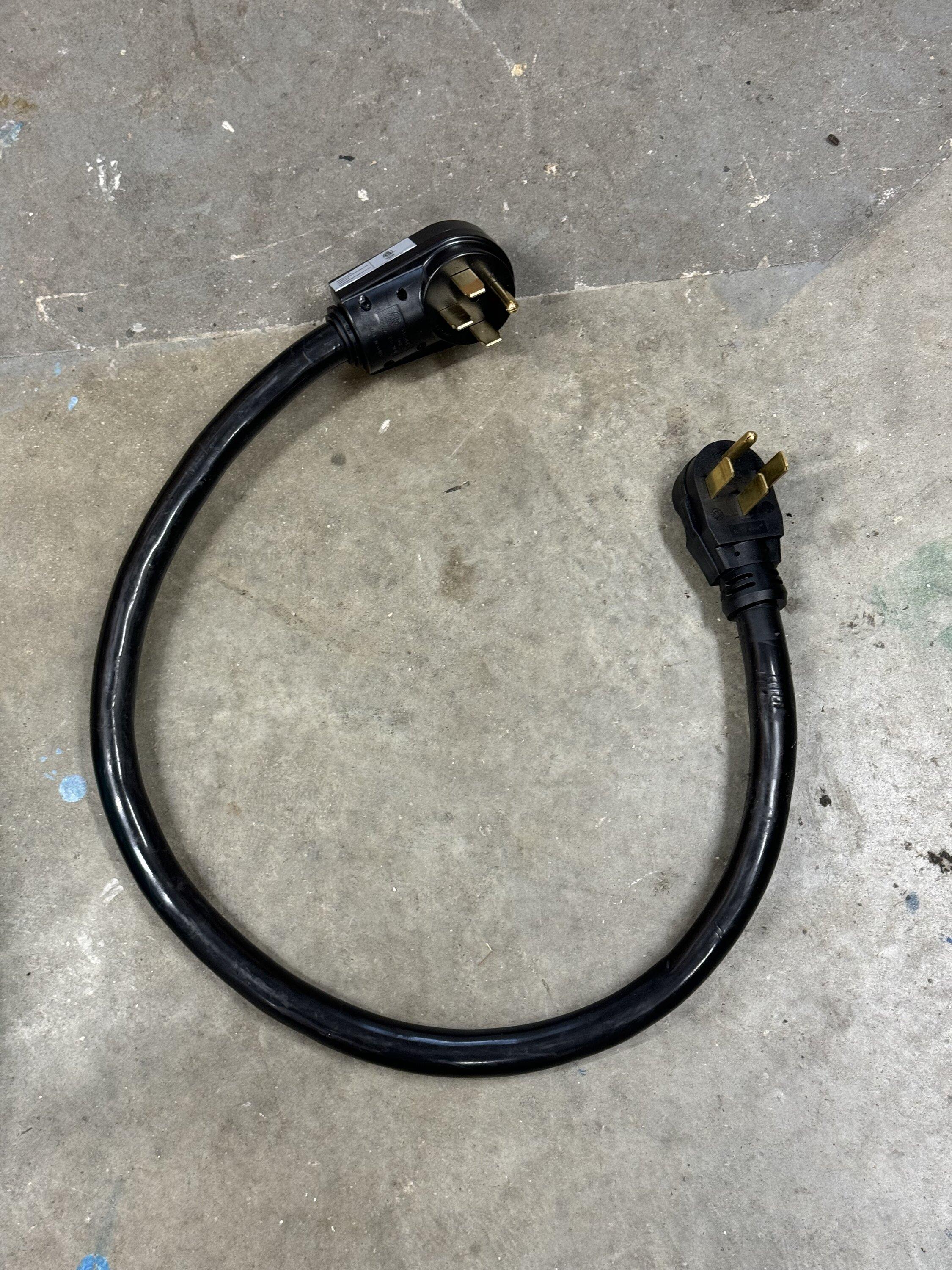

I'll echo what Tom suggested.
It is not that expensive, and it is infinitely SAFER for everyone! That is, YOU, the linemen, your wife and kids, and whoever else might be in your home. What if you are not there when the power goes out, but the CT is?? Are you comfortable with the kids doing this to get the TV back on.... because they saw you do it once??
BTW, I have a similar setup installed in an older outbuilding. It is a manual disconnect switch with a male/female extension cord from the generator. It was allowed by NEC code when installed, but I am not sure that is even allowed today. Still, it is a much better solution than the "suicide" cord setup you now have. Not to "UN-NIKE it but....
