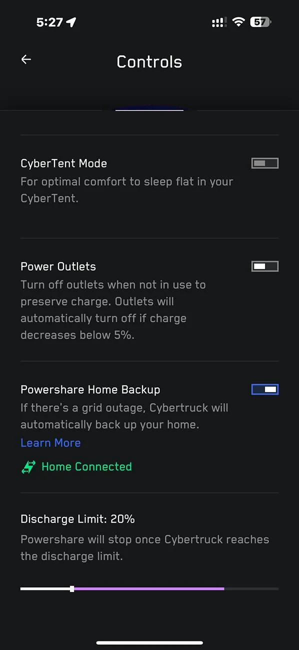

POWERSHARE HOME BACKUP NOW WORKING WITH POWERWALL ONLY SETUP!!!
Paul Scott
Paul
Jan 10, 2024
105
106
Las Vegas, NV
2016 S, 2019 X, 2024 Cybertruck
IT Director
It is still disabled for solar and power wall owners but if you have the Gateway3 with the Powerwall 3 then there is a low voltage two wire that connects to the gateway, and then the Universal connector can be connected to any part of the backup load. When the software update comes out in Q3 we shouldn't need the low voltage wire as its purpose is to power the gateway when the truck is connected so it can properly set the transfer switch. If you have power wall that power wall can power the gateway so V2 gateways will work without the low voltage line.

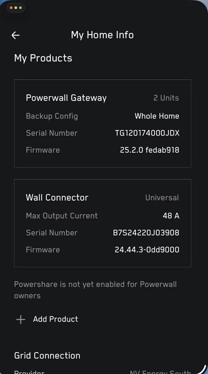

if you go into the my home and your power wall, you will see if the power Wall can talk to the vehicle yet. The newer gateways that came with a truck V3 gateways have a wired communication line that supplies low-voltage power from the truck to the power wall. Older V2 ones don’t have that communication wire that supplies low voltage so it has to talk over the network. I believe that piece of software is what’s not done yet.

July 1, just got my PW3 up and running, I have off brand solar that came with the house. No update, I get the same “PowerShare is not yet available for Powerwall owners”
