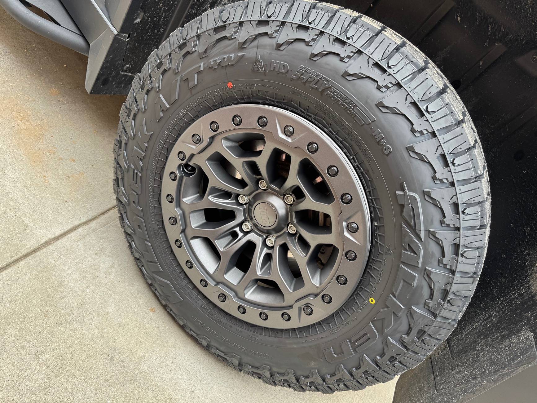

they didnt include the bolts for the beadlock??
Just got a confirmation from Martian wheels that the bolts and washers ship separately which makes sense as to why my order says partially delivered.

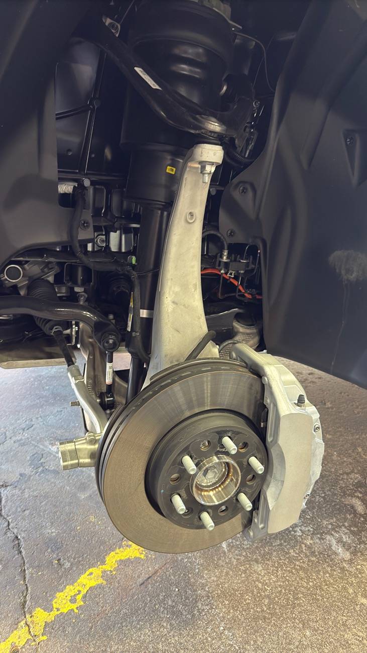

Got my 18” wheels on Thursday. Went to get them installed today and they don’t fit! The front calipers on the beast are too large! Now I have to undo the installation (which I still have to pay for), and try to ship these back to Martian. They have not responded to phone, email, social media posts. Haven’t responded to requests for info about missing beadlock bolts I sent last week either. Not impressed with the customer service.

Have you or your shop removed that little nugget to the left of the rotor? It bolts on and possibly acts as a counter weight

No, they didn’t

I’m back there now. That worked! Thank you!!!

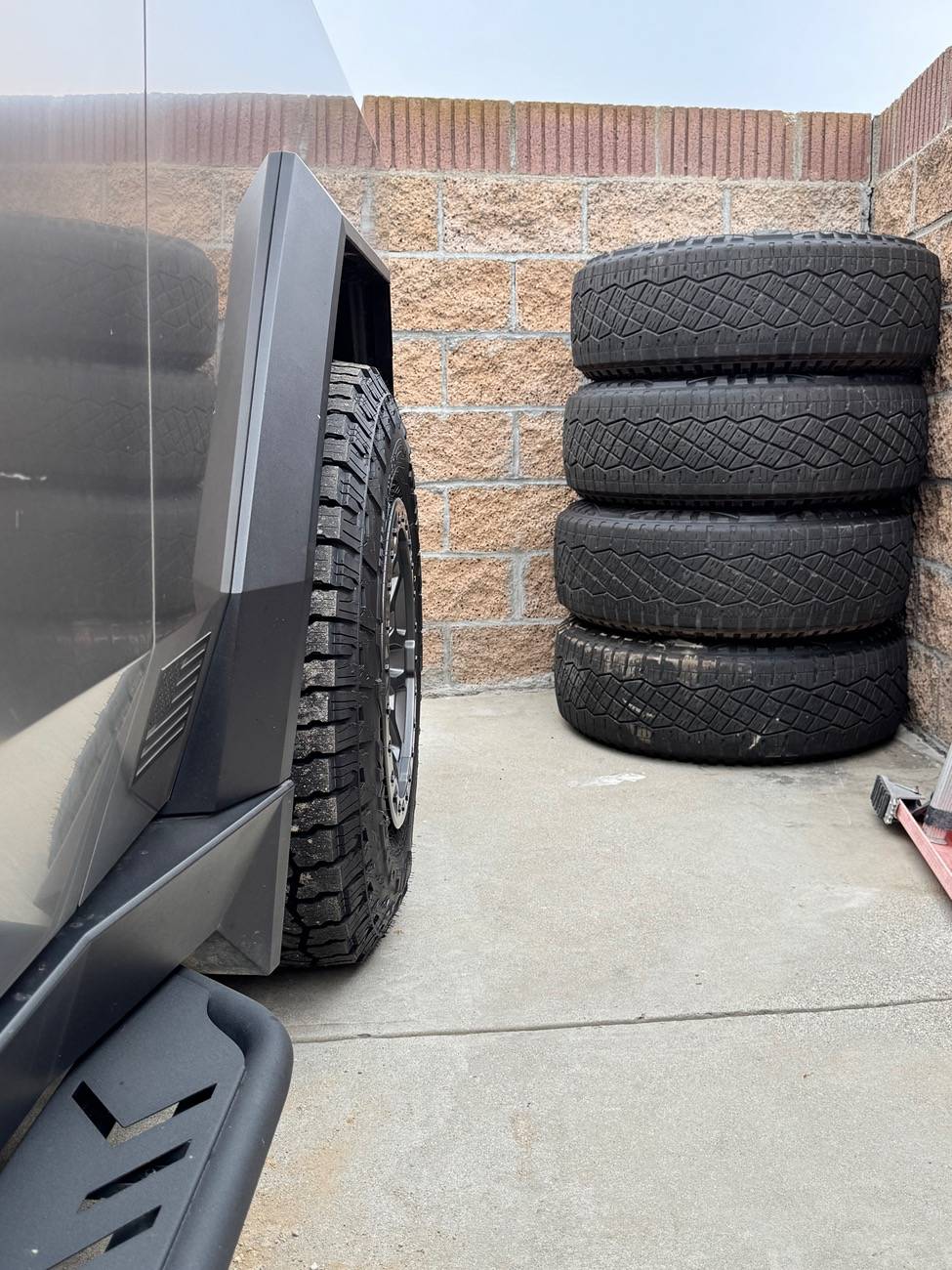

What do you think about the gap?
Not a huge fan. From some angles it’s pretty noticeable. Other angles you can’t tell. I appreciate the fact the wheels can be dual purpose and configured both ways. However my next tire rotation I will be mounting them as true beadlock configuration.
