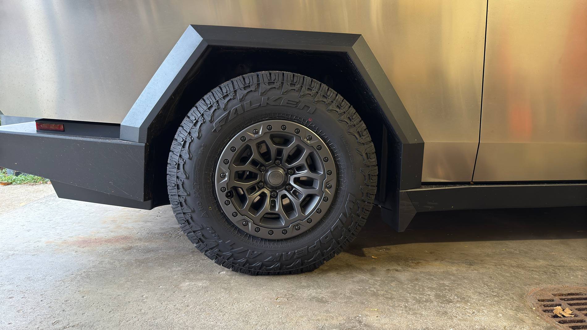

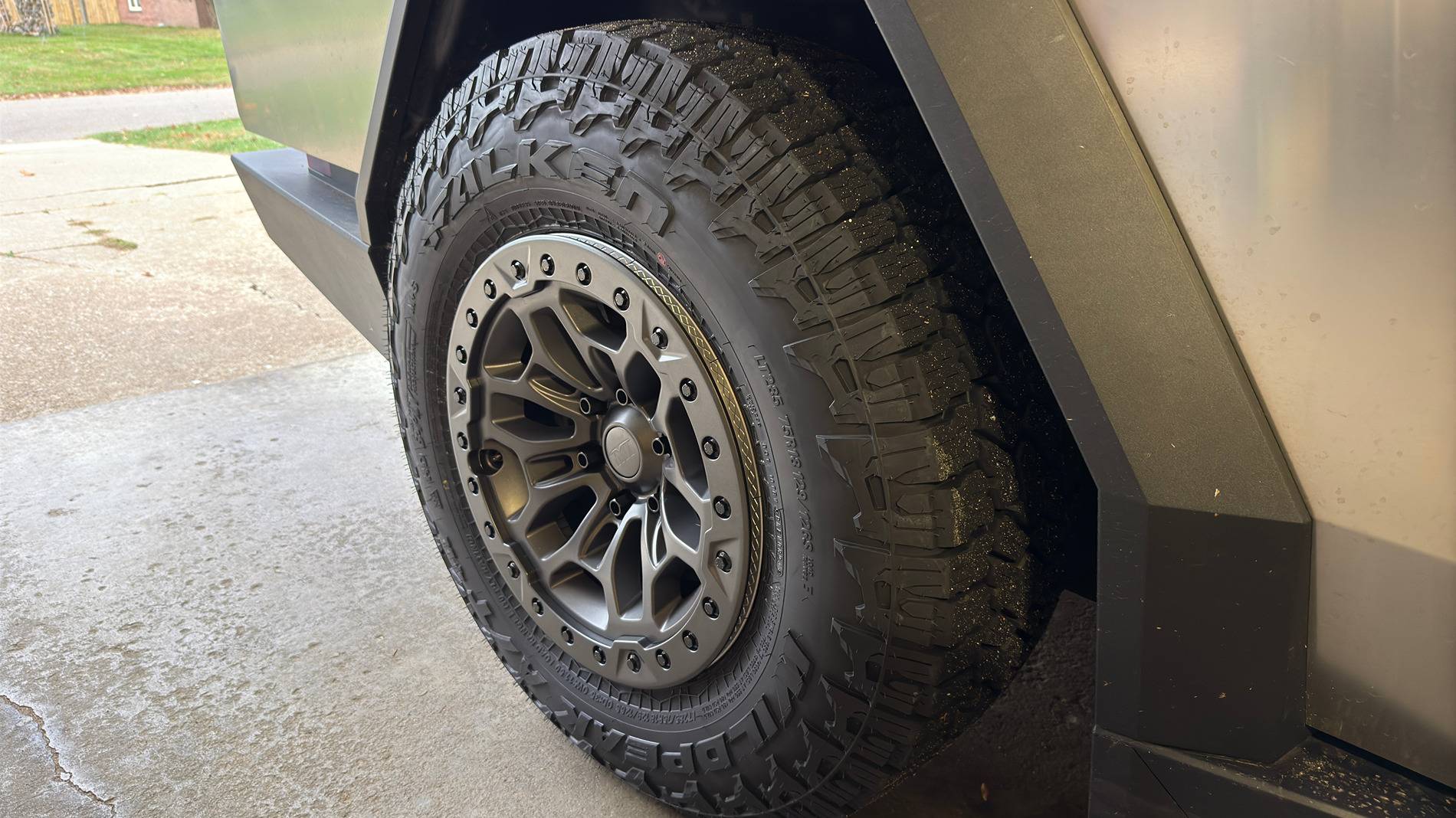

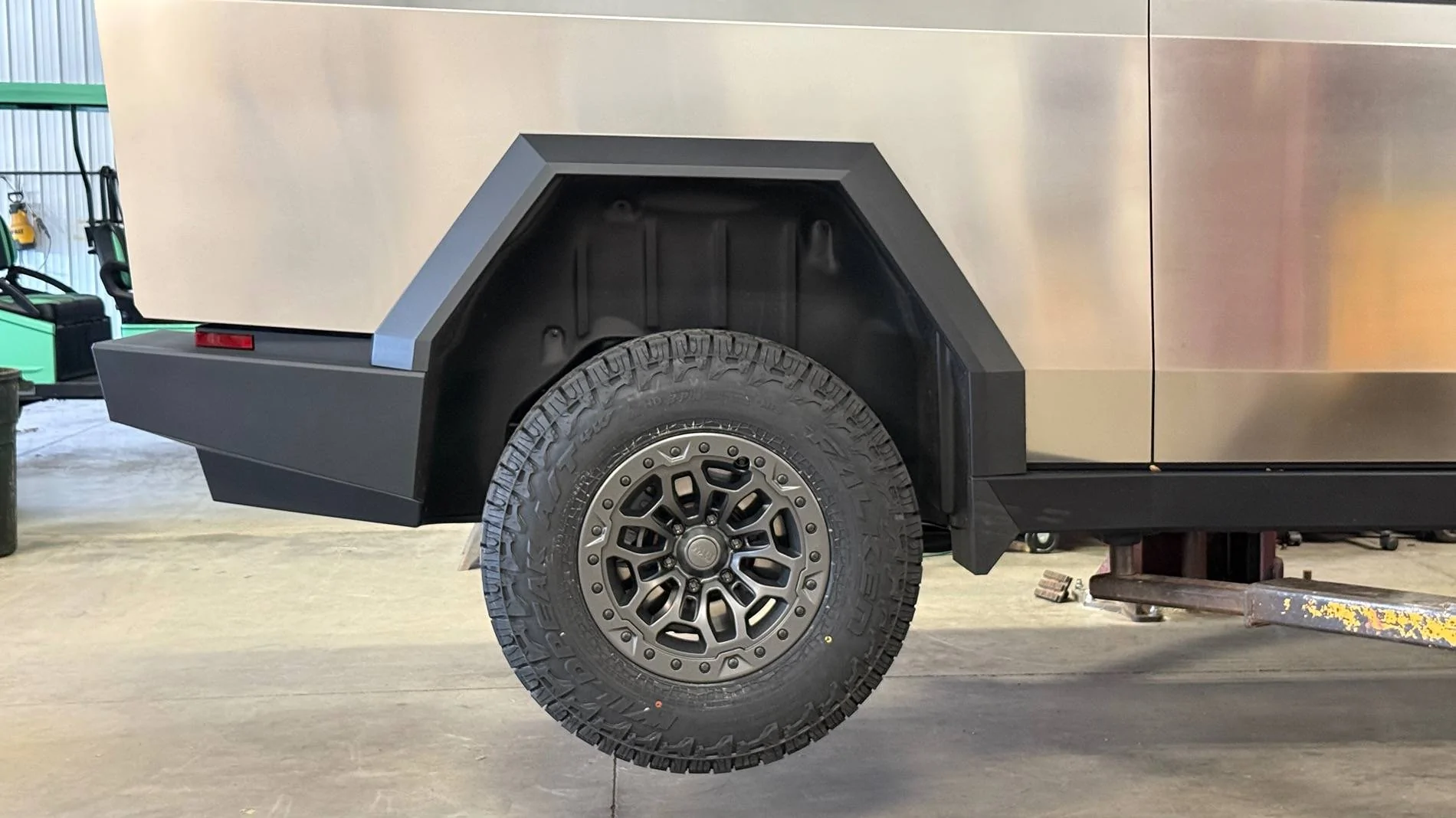

I got the bolts for the rings and installed them yesterday. Honestly, I don't like it. They stick out too much, and the silver really catches your eye. It just looks wrong. I have an appointment on Saturday morning to mount in full beadlock configuration. One of the benefits of full beadlock is if you do have a blowout, the tire will likely stay on the wheel. Ignore the dirty garage...I have a plan to get the flooring done and completely redo it for my truck! :) As far as weight goes, they are pretty heavy. I think the UPS guy said they were about 50 pounds each, including the ring.

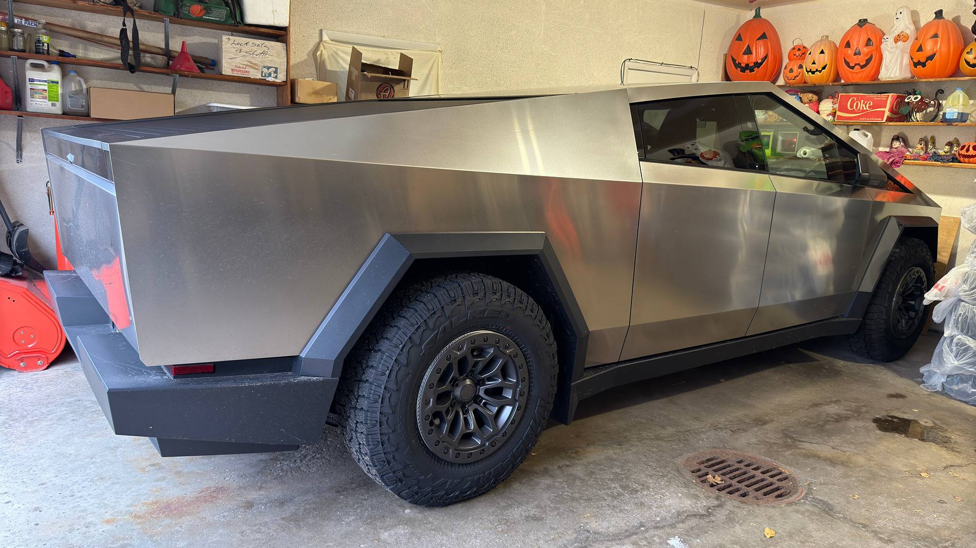

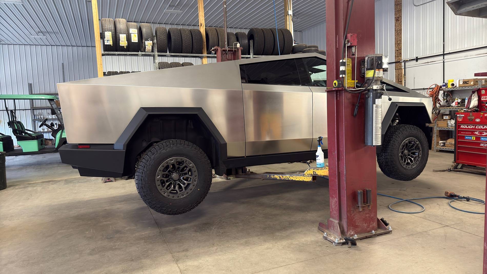

Getting them done right now. They look awesome!!!
