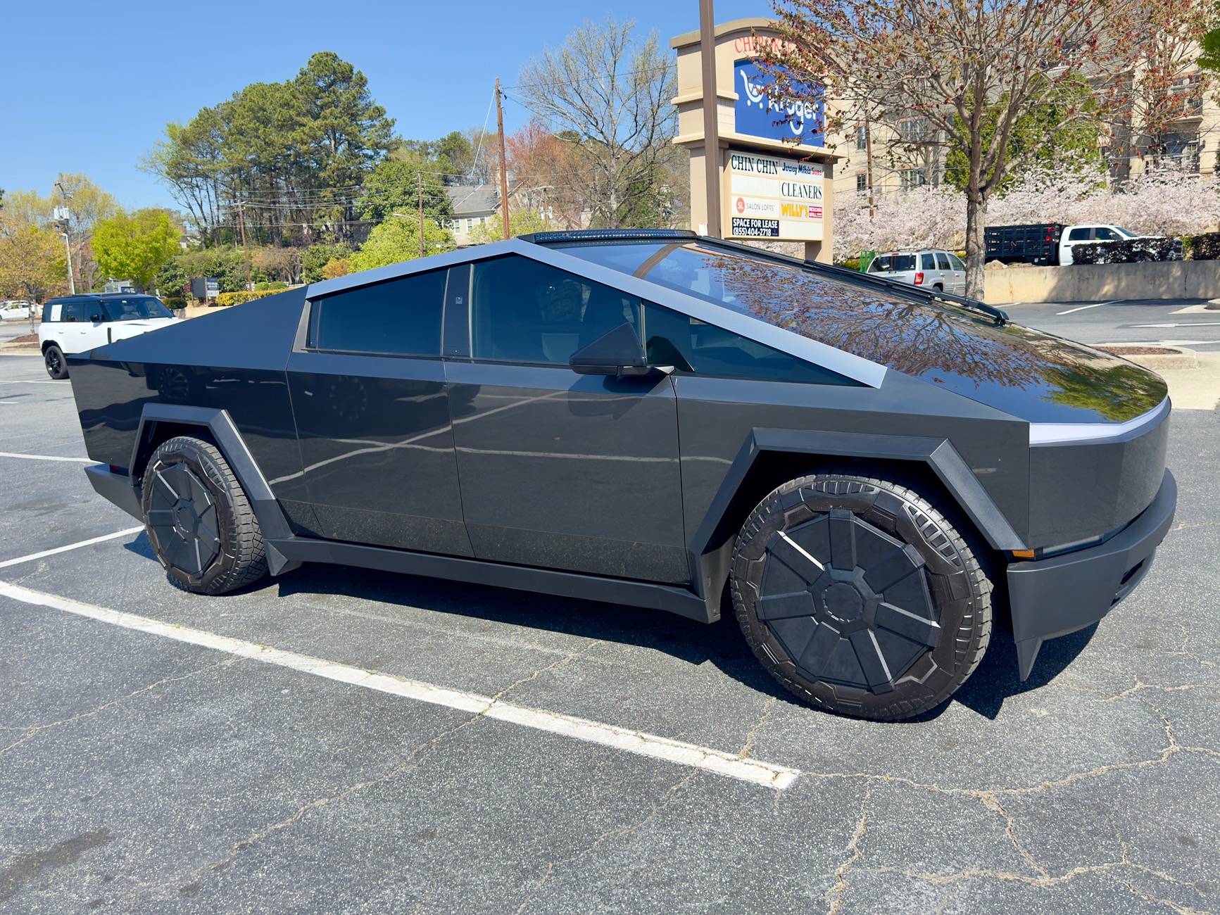

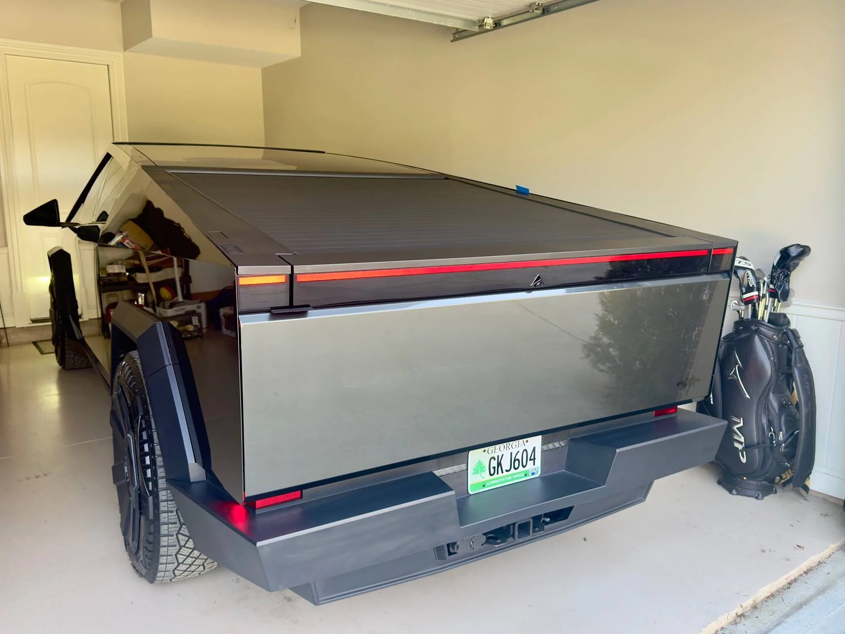

Wrapped the truck this week in Atlanta with 50% PPF from TWraps.
Great kit with all the precise panel cuts. Very happy.
Tesla Cybertruck Matte Lead Ink Gray PPF Wrap by TWRAPS IMG_1598

That looks great!
How long did it take for you to wrap it? Any post DIY tips or learnings?
Asking bc I’ve been thinking of purchasing their DIY wrap…

Thanks I really like it. I was not gonna have another black vehicle lol and it’s got a little bit of olive green in it which is very cool.
Two things which you have to do is get a good metal solvent and clean the areas of the stainless where you’re going to fold over the wrap because you want it to adhere. I would also get some PPF adhesive and apply a really thin film before you fold over PPF as it will help it stick better. And a heat gun helps persuade PPF to lay flat In tight areas(side mirrors). Also, there are 2 quality squeegees inside tube that I found late.
There is a lot of film here, and it’s cut well, but I have a couple of 1” spots I’ve got to go back and glue down.
Highly recommended kit.
