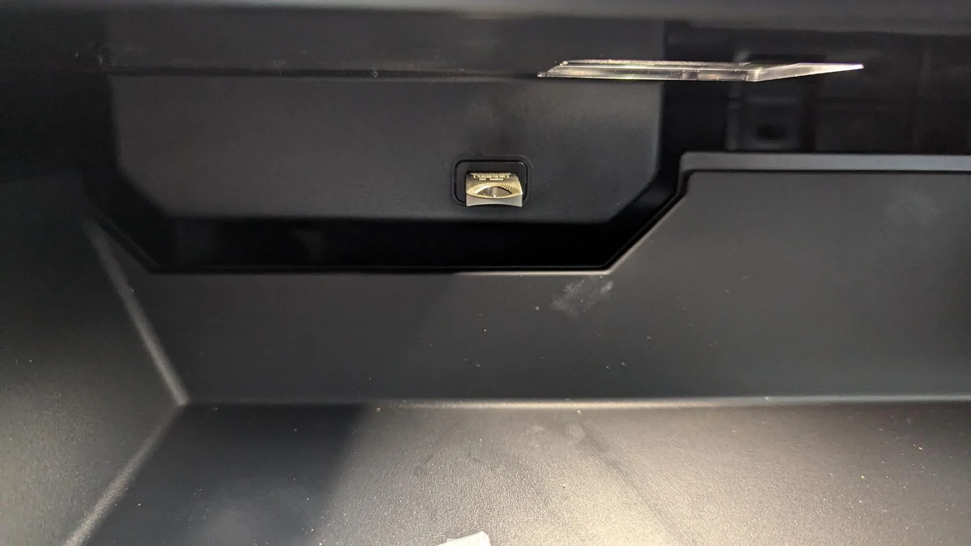

It's on the back wall of the glovebox, silver USB thumb drive
That's a good shot of the stock Tesla thumb drive installed in its location. The back wall of the glovebox is cut out to clear the structure with the USB port. That structure doesn't move with the glovebox, so a large object in the glovebox could be forced against the thumb drive when the glovebox is closed.
I replaced the stock thumb drive with a very small micro SD reader and a 512 MB SanDisk high endurance micro SD card that was developed for constantly operating security cameras. The card is entirely contained in the reader and the installed reader extends just ½ inch from the USB port. This change doubles my storage and reduces the chance of having some object jam against the thumb drive and damage something.
The reader I chose gets low reviews for how difficult it is to remove the card from the reader and how removing the card sometimes damages the reader. I didn't have either of these issues. Also, I'm not planning to remove and replace the card often, if at all. If the reader does get damaged the package comes with three readers for less than $5. Here are links for the two devices.

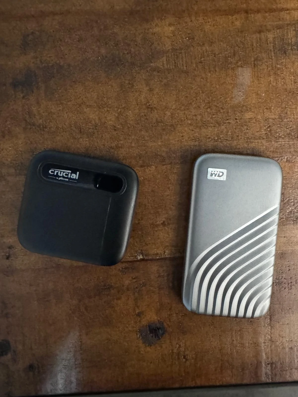

There's no way that will fit in the Cybertruck right?
Sure it will. The glovebox will accommodate a pretty large (physical size and digital space) hard drive. Just recommend using velcro or something like that to prevent it from sliding around inside the glovebox.
