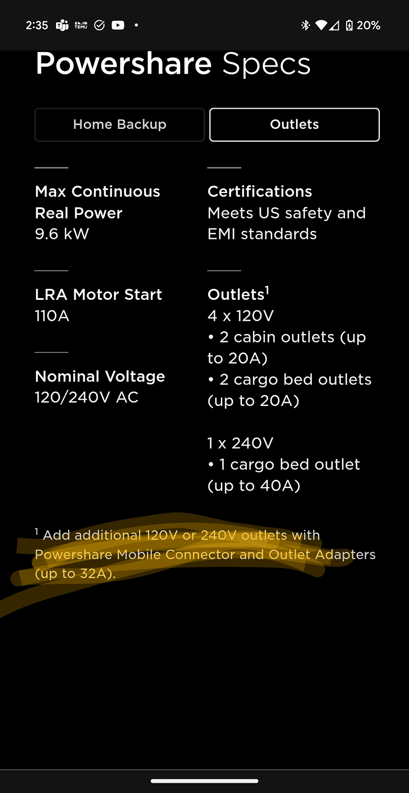

Not yet but like autopilot and Tesla selling the 79k CT.. one day
Tesla Cybertruck Mobile Poweshare Adapter! (Exclusive?) Screenshot_20240313-143506

I can understand the hesitation to believe it but this is on the outlets section on the powershare page where they are outline the amount of power that can be output from the outlets. Then to say you can add more outlets seems kinda definitive to me but we will see for sure. They could always change their mind. Or charge an extra 20k for them

I totally see where that logic is coming from. I do think it's nacs out though just because if you look at that highlighted section in the pic above, it specifically says mobile power share connector with outlet adapter is used to add more plugs.
It even has the same max amps as the original post indicated for the connector
