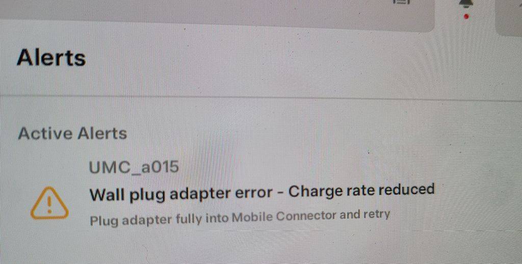

I am having a problem with my CT Mobile Connector. When I try to plug it into the bed outlet and charge another car, it would only go to 32 amps once or twice out of 10 or 12 tries. It would usually default to 6 amps and an error message would pop up on the car's screen that I'm trying to charge (see attachment). In addition, there would be a red light on the face of the Mobile Connector. I tried removing and reinserting the pigtail a few times, but was only able to get it to work twice over quite a number of tries.
