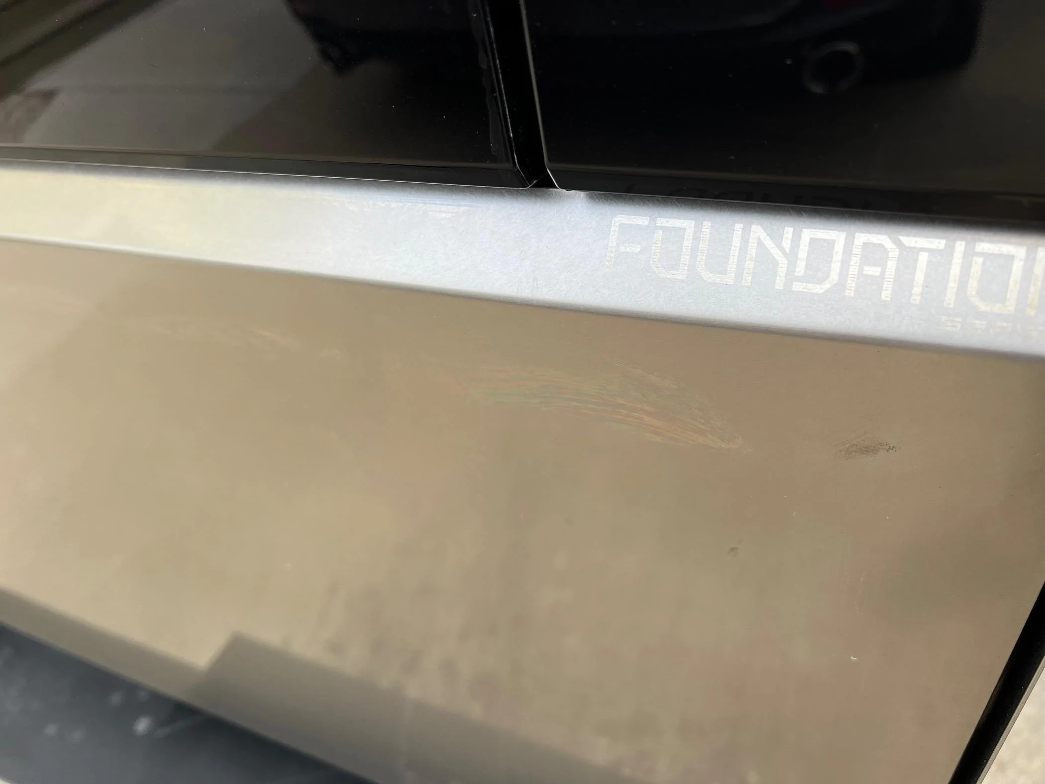

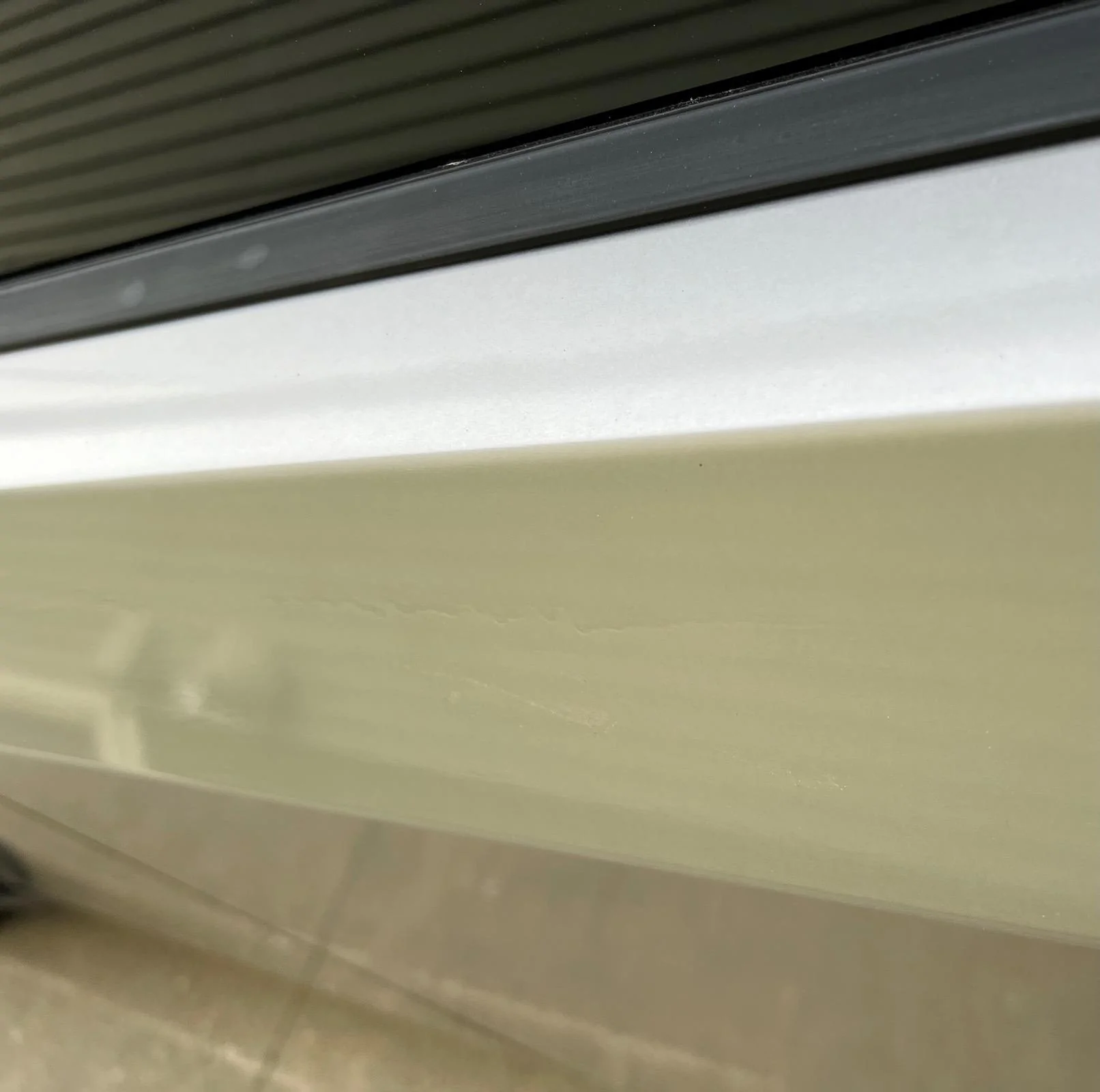

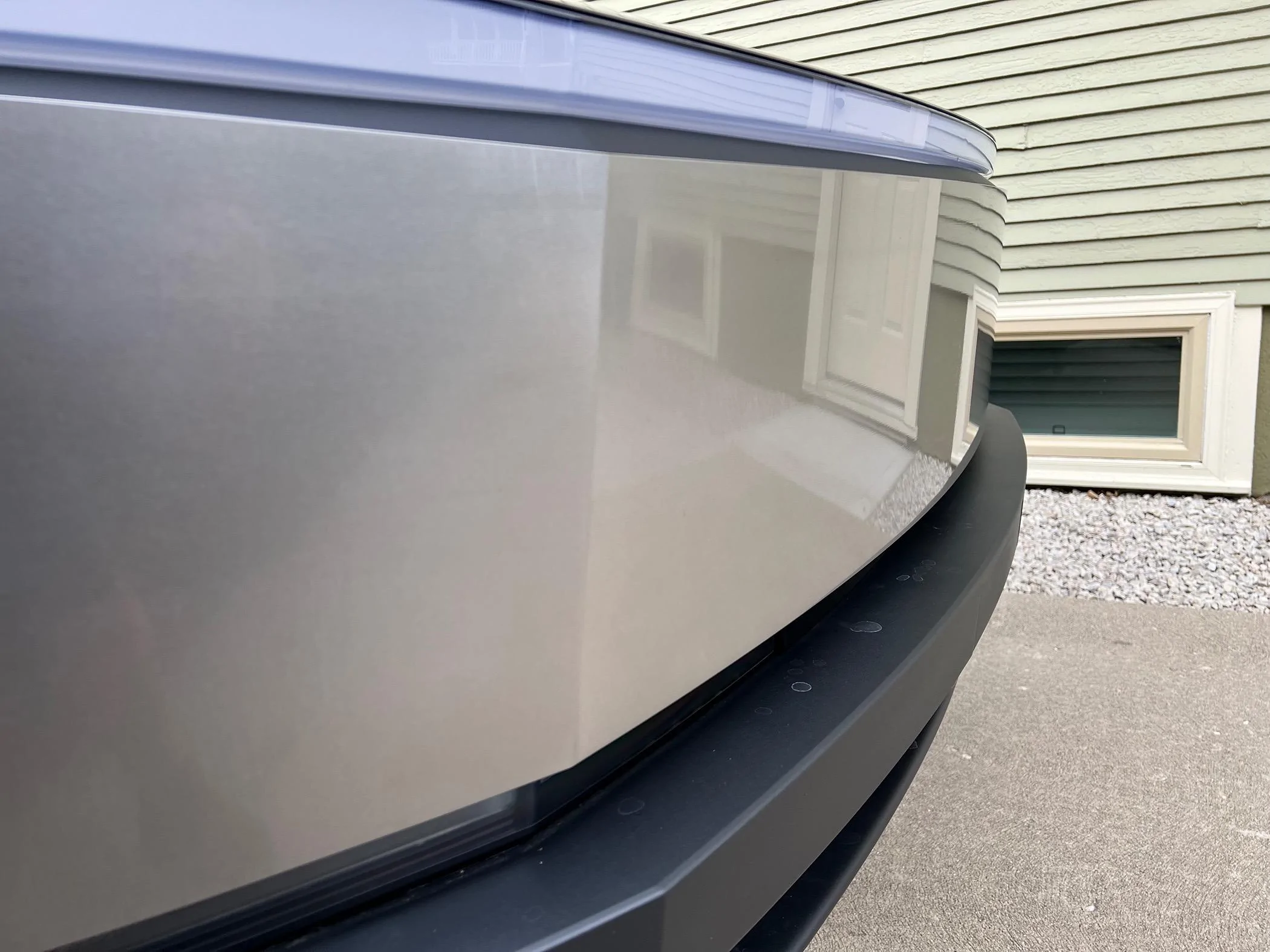

I read all the directions and watched the videos from the company again and was able to get really good results. Still got bad results as well. It is a Goldilocks situation with the retailers going wayyyy too thin, what feels like too thick is right and ridiculously thick will run and not settle. I was surprised the way too thick settled better than expected, but the super thick single coat looks like a layer on the surface. The correct thickness looks really good. I think the detailers need some experience and they will have no issue.
the sun helped a ton to smooth and set the results. I imagine the heat in a garage would work well too. All in the instructions from the company, but it does need a little practice. Hard to capture in pics, what I describe is obvious from many angles less than 10 feet away, further than that it all blends away.
Tailgate image with “foundation”’is typical of too thin, rainbows visible and can see stripes from thickness variation.
Frunk image is a pretty perfect panel in person, uniform, can’t tell it’s coated and pleasing satin sheen.
door image is way too thick, can see runs that have not blended, but it has only been a day. Can’t believe how much it has smoothed. Appears glossy compared to the other panels.
I will try xylene repair of the super thick before stripping and recoating. The too thin can be corrected with a nominal coating on top. I can see how this material needs one correct thickness, not multiple thin coats. I will talk to detailer with results, I would have preferred to pay and get it perfect. Hopefully others can benefit.
