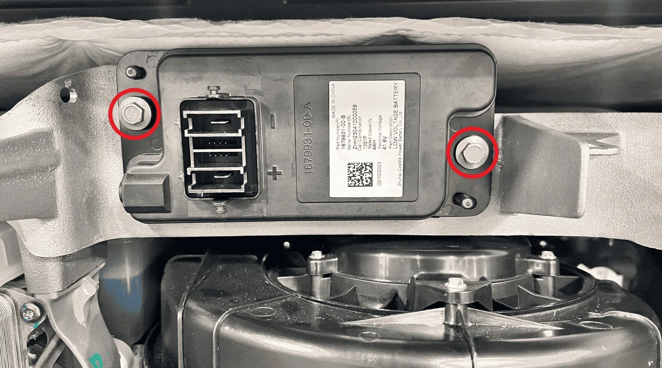

From the service manual, 13S1P, 41.6V Nominal, 4Ah. 3.2V nominal per cell means it's LFP which makes sense for longevity and durability.

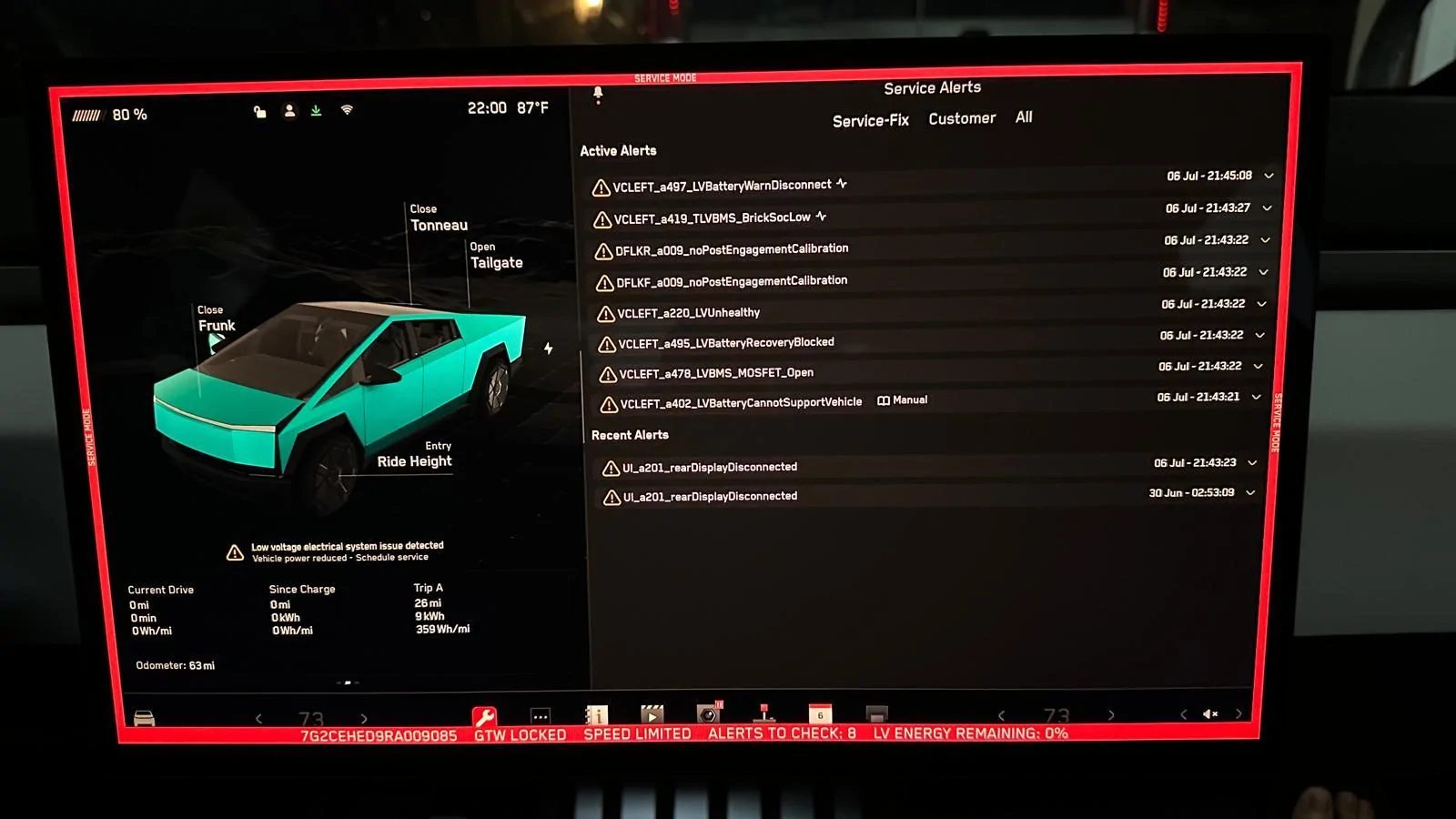

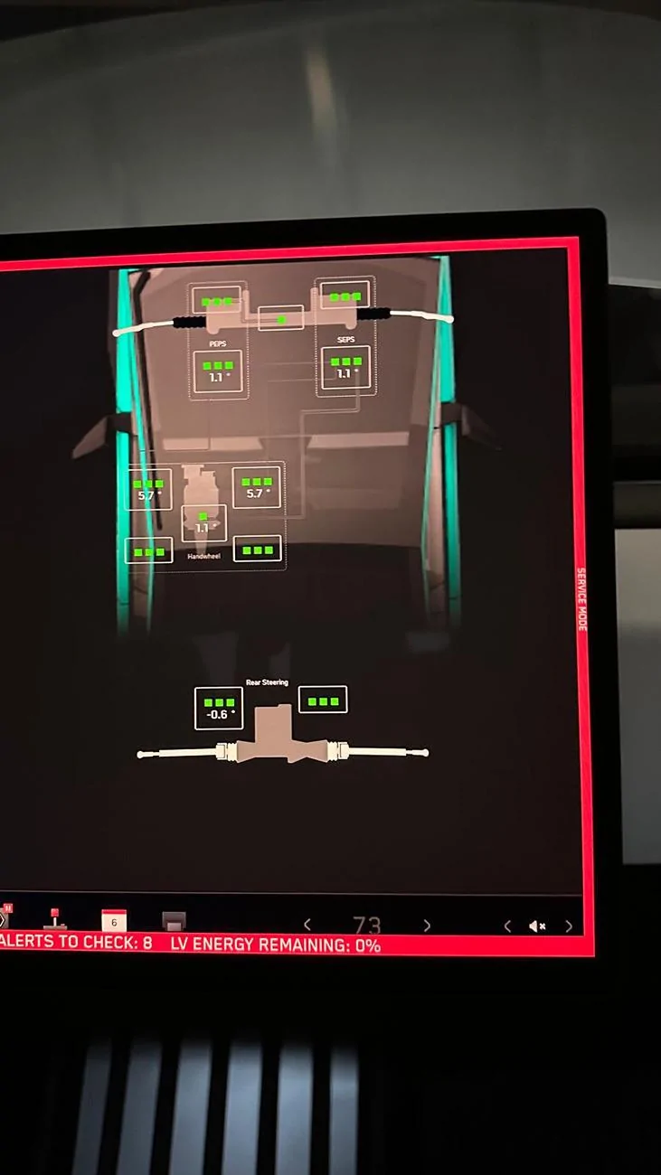

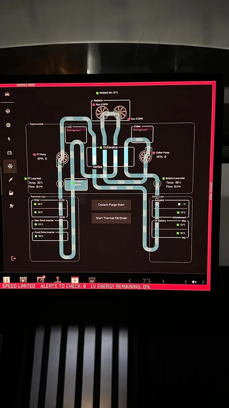

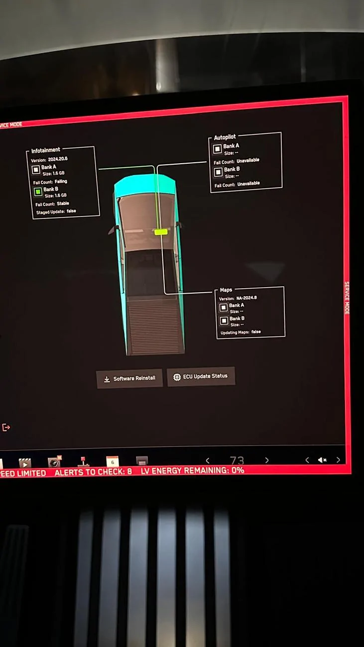

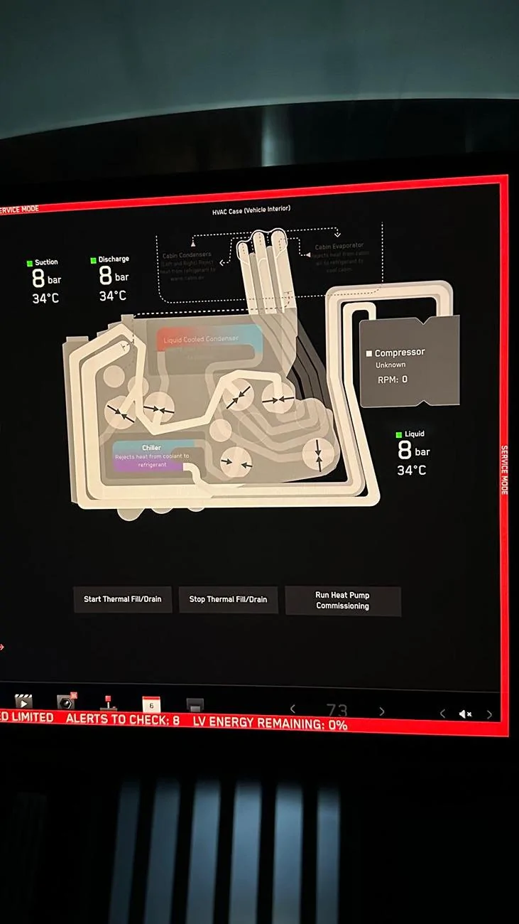

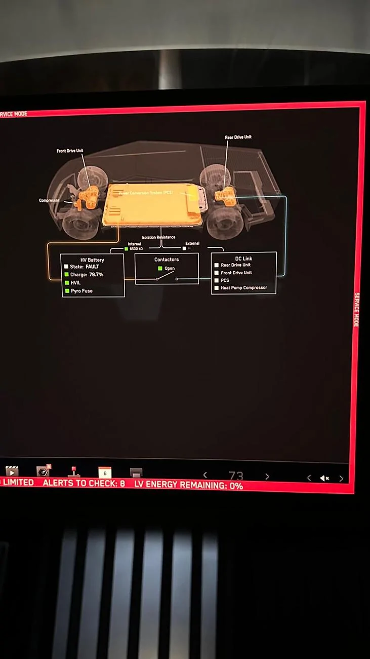

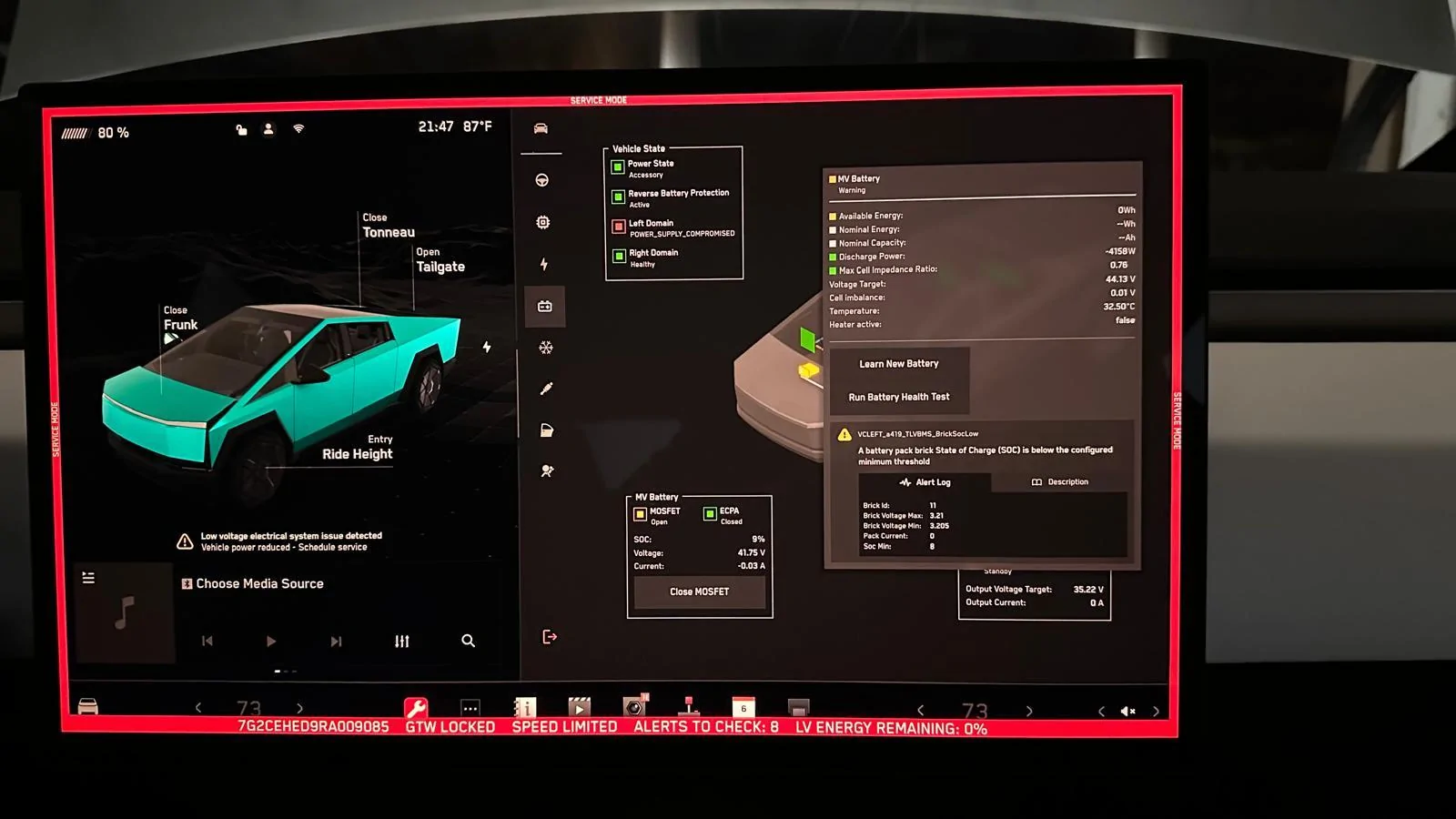

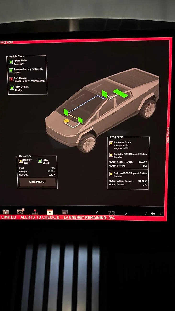

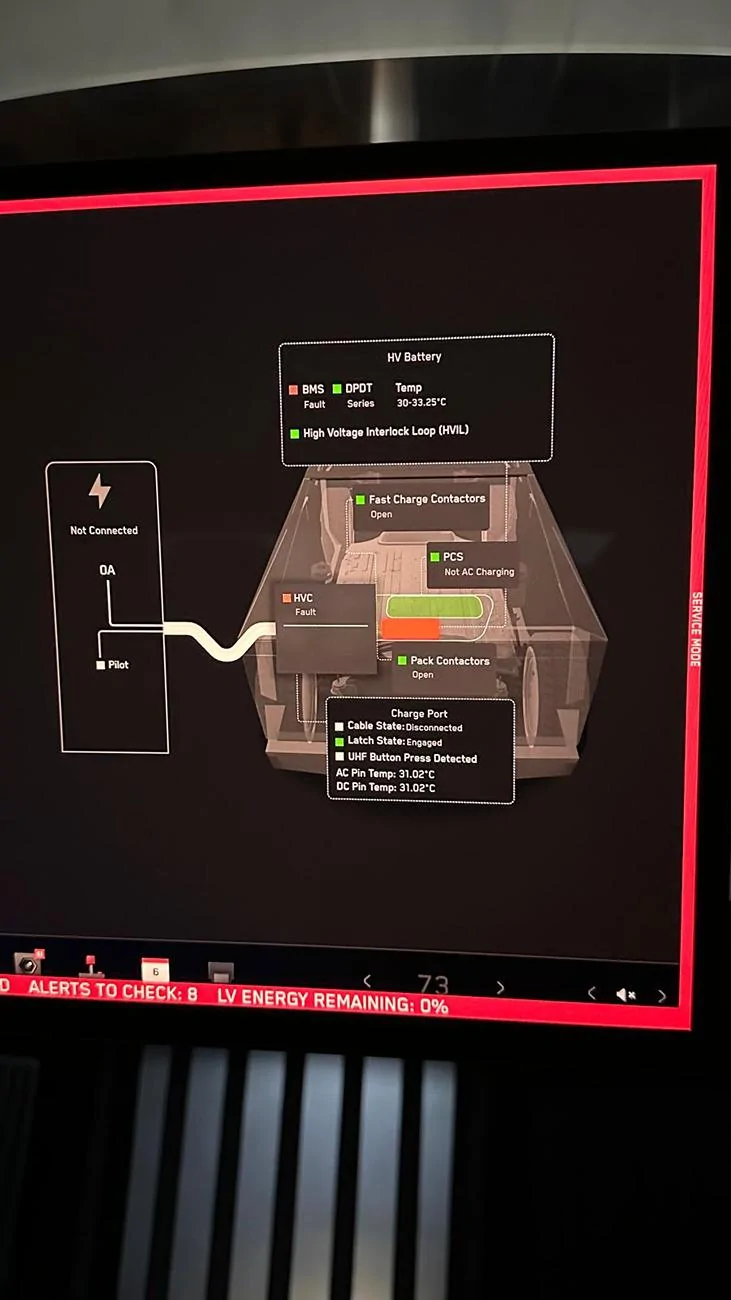

My apologies in advance if reviving old threads is frowned upon but the same thing happened to me, although I am not sure it is for the same reason so I figured it belongs together with this.
Picked up with 18 miles, drove for a day, it is now at 63 miles and completely dead in the garage. I managed to pop the frunk and connect a 12V so it starts but it is not charging. I entered Service Mode and I got a "Left Domain: POWER_SUPPLY_COMPROMISED". MOSFET is open for the MV Battery, SOC (State of Charge) is 9% no matter what, voltage shows as 41.75 V and current at -0.02 A. ECPA is closed. AC does not run, glovebox does not open, and I get 11 service alerts, mostly about LV health.
I left the tonneau open so I think that has something to do with it as now when I power it on the thing starting going bonkers apparently trying to close or open, although I did not command it via switch or app. The bed switch for the tonneau does not work but the back door switch does.
Here are some screenshots for anyone interested in doing some investigative work :giggle:
Tesla Cybertruck My Cybertruck will not start / power on ct-borked-mv-battery9

Tried that but the vehicle still refuses to even power on (as in, as soon as I remove the jumper battery, everything goes dark and door only opens using the emergency switch.
I gave up yesterday and had it towed it to the SC but it was a 10-hour ordeal. Then today they told me they had to forklift it into the shop because they could not get it to go into Neutral / Towing mode, which I managed to do multiple times (and my first time troubleshooting a Cybertruck, mind you) ?‍♂
I am keeping my fingers crossed that they can figure it out but tbh, I am not very confident they will fix it any time soon and return it to me without some new damage. And probably still dirty and missing the mobile charger. :LOL:
