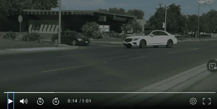

Here are some videos from Canada. I only used them because they prepared some nice videos. Most U.S. have the same laws.
SGI Canada | Saskatchewan driver's licensing and vehicle registration
Examples of crashes and fault: Yielding right of way
The examples in these articles show the rule of the road and who is typically, but not always, found at fault.
https://www.sgi.sk.ca/news?title=examples-of-crashes-and-fault--yielding-right-of-way
How the rule is applied
When entering a street, road or highway from a private road, lane or alley, you must yield the right of way to any pedestrians on the sidewalk and to any vehicles on the street, road or highway. The driver must be able to judge the speed and distance of the other vehicle so that the movement can be made safely.
When there is a yield sign, the driver facing the sign must yield the right of way to any other motorist approaching the intersection, again judging the speed and distance of the approaching vehicle to ensure the movement can be made safely.
If a driver sees an oncoming vehicle but believes that the distance is great enough to enter onto the highway, however a collision occurs, the driver with the yield sign or that is entering onto the highway is normally deemed at fault.
** Must go to website to see play video examples 5 & 4

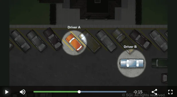

5.
Driver A was parked in an angled parking spot in front of a medical building. She testified that once she had backed her car out of the spot, and had put it in drive to start going, she was hit from behind by Driver B. Driver B testified that she was driving down the road looking for a parking spot, and she saw Driver A backing out, so she stopped, but she could not back up, as there were other cars behind her. The judge found that Driver A had entered the travelled roadway without sufficient time and space between her and approaching traffic to permit her to proceed forward before an impact occurred. At the time of impact, the question of whether she was fully out of the spot and in drive, or was in the process of backing out does not determine fault. Driver A had placed her vehicle in the driving lane, or was in the process of doing so, but vehicles already in that lane had the right-of-way. She was responsible for making sure she did not back out in such a way as to create a hazard for those approaching vehicles. Therefore, Driver A in backing out was at fault in placing herself in the way of approaching traffic without sufficient time and space to permit other vehicles to stop behind her, or to proceed following her without stopping once she had entered the roadway and begun to move forward.
** Driver A was found 100% at fault and assessed 6 SDR Points.
Tesla Cybertruck Need headlight/taillight side cams - Intersection fences/walls/shrubs/parked cars obstructions block FSD B-pillar camera view sgi-ex5-Screenshot_20211218_163320

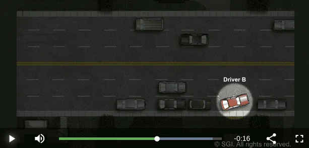

4.
Driver A claims that she was driving in the right lane, when a car that was parked next to the curb turned into her and hit her car. Driver B claims that her car was already in the driving lane, and that Driver A drove into her. The court accepted Driver A 's evidence that Driver B turned into her causing the collision. The court also looked at the damage to the 2 vehicles to determine where the vehicles were when they collided. It was Driver B's duty to yield the right of way to the vehicles already on the highway so the onus was on her to show the collision was not her fault.
** Driver B was found 100% at fault and assessed 6 SDR Points.
