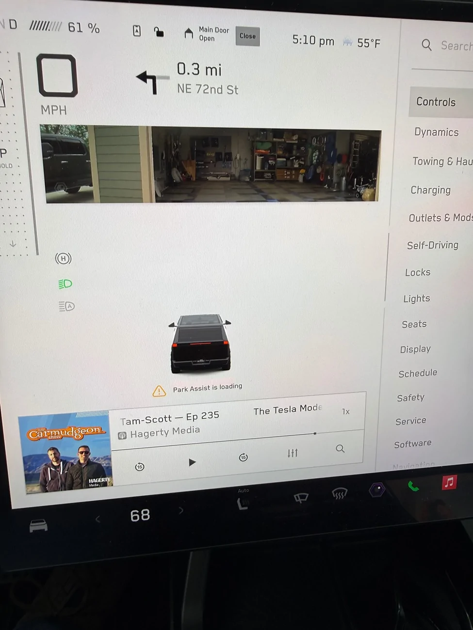

After work (and likely unrelated to the update that morning), my Autoshift from Park is gone, all FSD driving visuals are gone (essentially a blank screen) and no FSD button, no blind spot monitoring, auto turn signal cancel, etc. Also when parking it says Auto Park Loading as an alert but never progresses. After a reboot, power off, and attempt to recalibrate cameras it looks like nothing can bring FSD back. Also the cameras flicker black occasionally. I'm wondering if the AI4 hardware needs replacing.

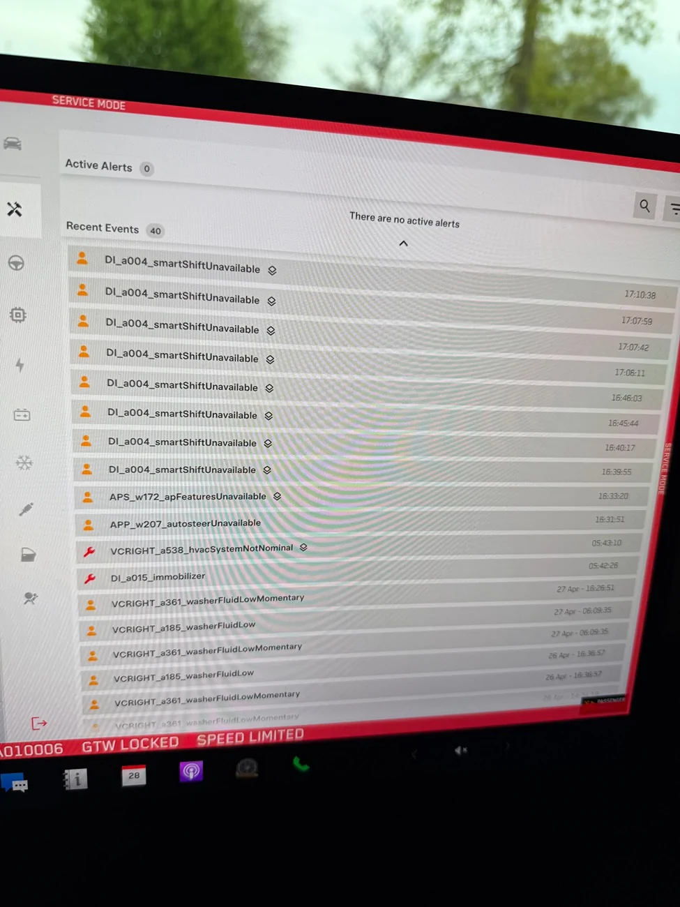

I'd be interested in a photo of the alerts in service mode

Sure thing. See below. As I write this I did neglect to go into the menu to see whether the FSD computer was showing as ā€œgreenā€. I’ll check that out tonight after work.

I'd bet that you have a module stuck in an error state somewhere on the Etherloop (newer CANBUS). Allow your truck to deep sleep and it should recover. This can happen sometimes when performing firmware updates.
