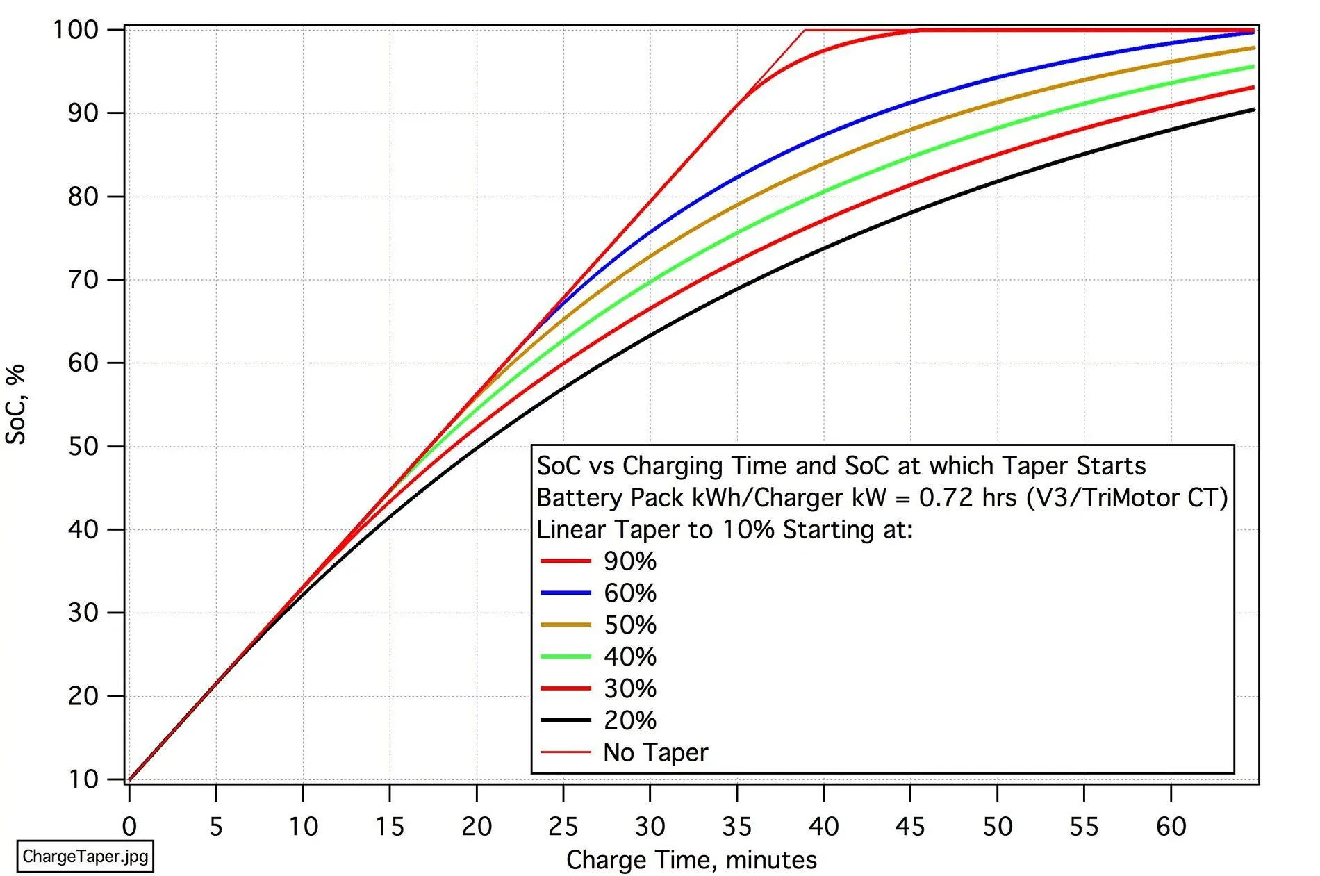

Even if it will be charged with the same Generation 2 or 3 Superchargers that are currently available, the charge rates could possibly not taper off until a much higher charge level of 80% or 90%. Currently, the charge rate on Teslas starts tapering off around 50% and continues to taper off as the charge level gets higher.
Actually they generally start to taper lower than that but what is amazing is how little difference it makes.
Tesla Cybertruck New Battery Range & Pack Architecture [Announced at Battery Day] ChargeTaper
In this picture I've assumed that the charger goes at full bore until some SoC is reached and then tapers linearly down to 10% above that. I looked at the 250 kW V3 SC and the Trimotor CT with its 180 kWh battery pack which would, were there no taper, charge from 0 to 100% in 180/250 = 0.72 hrs. I've tried to represent the typical road trip situation in which one pulls into a SC with about 10% SoC on board and charges to some reasonable level above that to continue his trip. I generally shoot for 70%. At that level taper starting at 20% implies an extra 10 minutes of charging. Taper starting at 40% implies only 4 minutes extra relative to no taper. Now if I want (or need) to go to 80% SoC taper starting at 40% costs 8 minutes more than no taper and 7 minutes more than taper starting at 80%. That should be enough examples to let you look at other combinations and draw your own conclusions.
The overall conclusion is that if you operate your battery where you should (i.e away from the full and empty ends) of the SoC range where taper starts doesn't make that much difference. The wise manufacturer tapers to protect your battery. He still lets you into the high SoC regions in recognition of the fact that sometimes you just need it but discourages you from going there by slowing the charging rate appreciably. This is not done to discourage you so much as it is to protect the battery but it definitely has that effect.
Meanwhile, it is clear that what mainly drives charging time is the size of the charger relative to the battery pack. Were the charger a 500 kW unit then C/rate becomes 0.36 hr and all the numbers on the chart drop in half. 500 kW charging on the CT is quite possible by adding a separate charging port and having two V3 chargers available in certain special stalls or allowing CTs to charge at the stations the Semis will be using.
Technically, voltage is the constraint and why taper happens whether intentionally or not: The amount of power that can be added to a battery at any point in time is a function of the pack's time point voltage and rated power amperage. (Minus the internal resistance and whatever the temperature ceiling is at that time)
So yes, a larger charger, but even a larger charger will hit this limit while charging. Just sooner, rather than later.

I really don’t get the people who keep saying that I or anyone else doesn’t need more than the current 500 miles of range. I get that right now people take breaks from driving to get a bite to eat and take a bio-break. And yes if you extend those break times a bit for charging then it isn’t too much of a hassle.
What most of them say is that most people most of the time don't need 500 miles range and that's quite true. But there are, of course, exceptions.
Look at the chart in #78. It says that with a V3 charger you ought to be able to pick up 60% charge from 10% in 27 minutes. That's 250 miles in the CT. That hardly seems burdensome to me. You ought to be able to leave home with 90%, travel 400 miles to 10%, (5 miles per percent) add 300 miles (60 % by charging to 70% SoC) in 37 minutes, drive down to 10% again and add 300 miles in another 37 min. and arrive at your destination, 1000 miles from home, with 10% reserve having spent only an hour and a quarter charging added to 15 and a half hours of driving at 65. Or you could go 700 miles with a single 37 minute stop.

Now if a tri-motor CT can get fully charged in 5 minutes, then I am fine with charging every 500 miles.
That's unrealistic from several POVs. First, you do not, even occasionally on a road trip, want to dip into the above 90% SoC (well maybe rarely when departing home where you can take as long as you want to charge) and/or below 10% SoC parts of the battery range (except as necessary to make it to a charger if a plan goes awry). Second, as the chart shows it can take as long to charge from 70% to 100% as it does to charge from 10% to 70%. To charge from 10 - 90% is going to take more than an hour. Appreciably more for high taper. It is much more time efficient to charge to lower levels more frequently but it does mean extra stops.
Note that it might be possible to halve all the charging times in the chart. This is "simply" done by doubling the capacity of the charger. I theorize that Tesla might do this by doing with the CT what they do with the Semi which is have multiple charging ports each of which connects to a separate charger (or to a charger with two hoses which is really two chargers in one cabinet). They would have to build separate CT stalls (which they are going to do) but each would have to have access to two chargers. They have made no implications that they will do that. The other possibility is to allow CTs to access the charging stations the Semis will use. But there aren't any of those yet. It's nice to fantasize, though. I could do my 600 mile annual migration with a single charging stop of 17 minutes. Better than my ICE SUVs refueling requirements.
