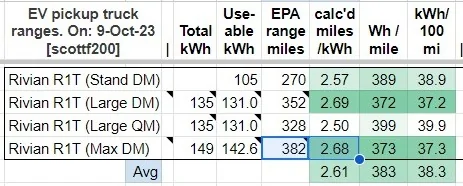

Are you thinking the input or the calculation is incorrect?
The calculation is correct, so either the battery capacity or the range has to be wrong. I don't see any other explanation for additional weight causing increased efficiency.

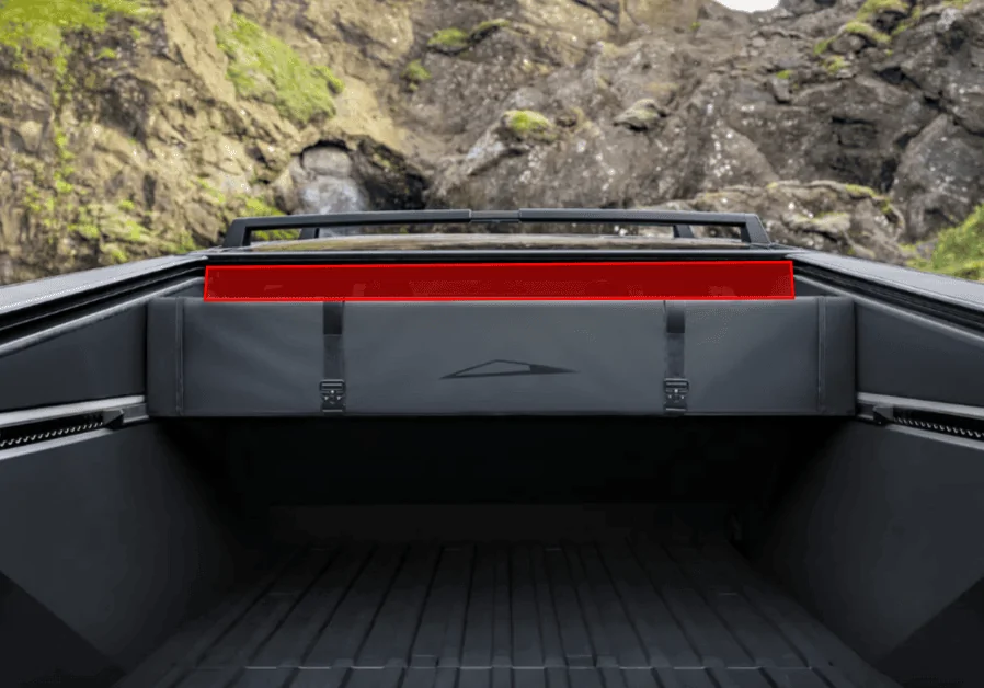

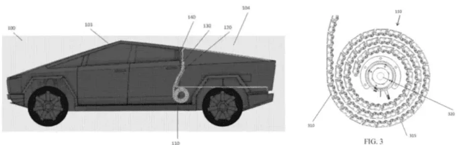

I suspect that the battery-in-the-bed range extender makes it DOA for most due to losing so much of the bed function.
@JBee
This is my thought to delete the hard tonneau to open up all that space the rolled hard cover occupies for battery and replace it with a fabric one, shown rolled up. It would use the same track as the stainless steel tonneau and could still be automated. It should fit under the overhang from the roof.
I bet you could fit 30kWhrs in there. (matching to the battery might be harder)
The tonneau is expensive to boot and probably weights 150 lbs. You might even be able to make it solar collecting.
I’m not sure I’m following the conversation
but the Rivian is both heavier but also more efficient, owing to the Rivian having both a significantly better Cd and a smaller frontal plain
as speeds increase, Rivian will be come more efficient, relative to CT
but probably I’m misunderstanding the convo

The numbers in the chart show that the Rivian quad motor with the standard pack is less efficient than the quad motor with the large pack. As far as I know, the only difference between the two is the size of the battery pack. I don’t see any way that physics allows a heavier vehicle of the same specs otherwise to be more efficient than the lighter vehicle with the smaller battery pack.
7,153
13,769
ah, in that case, maybe I’m just confused
but I’m also more confused now ?
I don’t see two quad motor variants represented in the chart?
maybe you meant the standard DM vs the large DM?
otherwise, as I understand it, the “standard” pack is their baby pack that has a different cell chem from their “large” pack. Meanwhile, the max pack is an ancillary pack installed under the rear truck seats. Perhaps this aux pack has a different cell chem or otherwise is itself contributes more efficiency (in its combo with the main pack arch) than the contributing to a blended efficiency that is higher?
Aero is more dominant that rolling resistance from mass.
The Rivian has a better Cd.

That Rivian Max miles/kWh doesn't make sense.
<snip> Gsheet with calcs
FYI, Thanks to @GhostAndSkater for providing the answer in this X/Tweet.
I've updated my Gsheet and it is more in-line.
Rivian R1T Dual 21" Large Pack - 130 kWh usable energy and 352 miles - 369 Wh/mi
But we need to discuss what all that means for a bit. The EPA allows manufacturers some margin to tweak the adjustment factors, for example
Rivian R1T Dual 21" Max Pack - 141 kWh usable and 410 miles - 343 Wh/mi
Both Rivian are the same truck, weight practically the same, same motors, same number of cells, just using cells with more energy
How does it is so much more efficient? It isn't, Rivian tweaked the adjustment factor so it would get over 400 miles of EPA range, if they used the same as the Large Pack it would be 382 miles of range
Is it wrong? No, Tesla does the same
