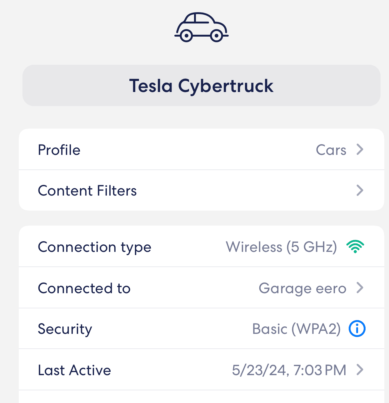

araxara

One thing that is unfortunate about the cybertruck is it only seems to support wpa or wpa 2 on 2.4ghz. No wpa3 support which is crazy at this point.
Here it’s connected to 5gHz and WPA2. I have WPA3 enabled:

eousphoros
Hmm mine has never connected to my 5ghz network and definitely refuses to connect when I have WPA 3 enabled. Ended up setting up a dedicated network for it so I wouldn't have to degrade my entire home network security in order to get it online.

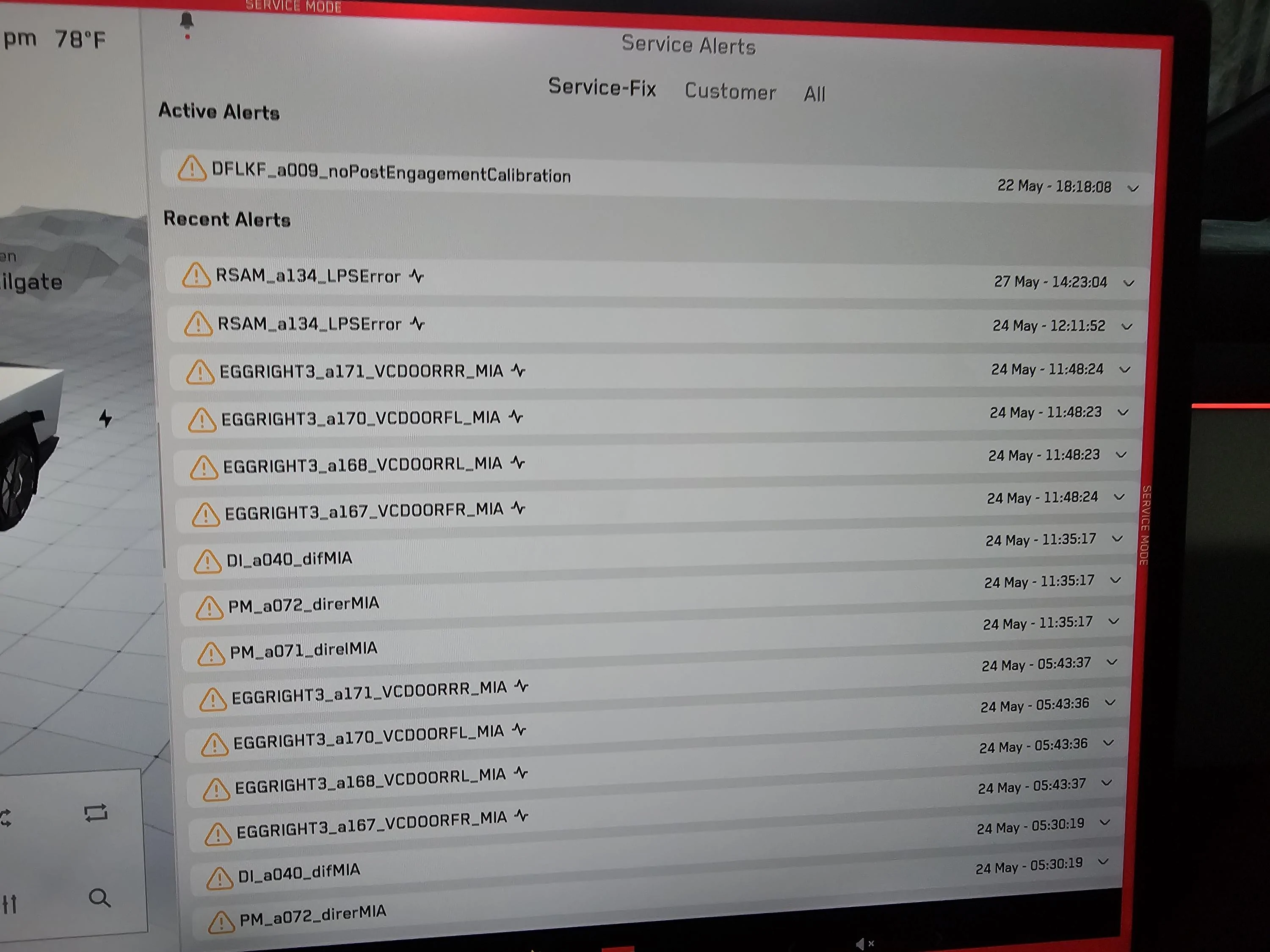

bemis
Dec 16, 2023
Detroit, MI
2018 Model 3 AWD
Installed this update while I was away on vacation...thought it was weird the truck was draining without recharging since I left it plugged in. Got home to see an error that it 'reached maximum charge limit' and won't charge anymore, and a bunch of errors. Since the battery drained to < 50% while I was gone, just drove it to the service center while I still had enough charge. Waiting to hear what they say
I tried requesting a software reinstall yesterday, but it never completed to the point of being able to install, even letting it sit overnight
