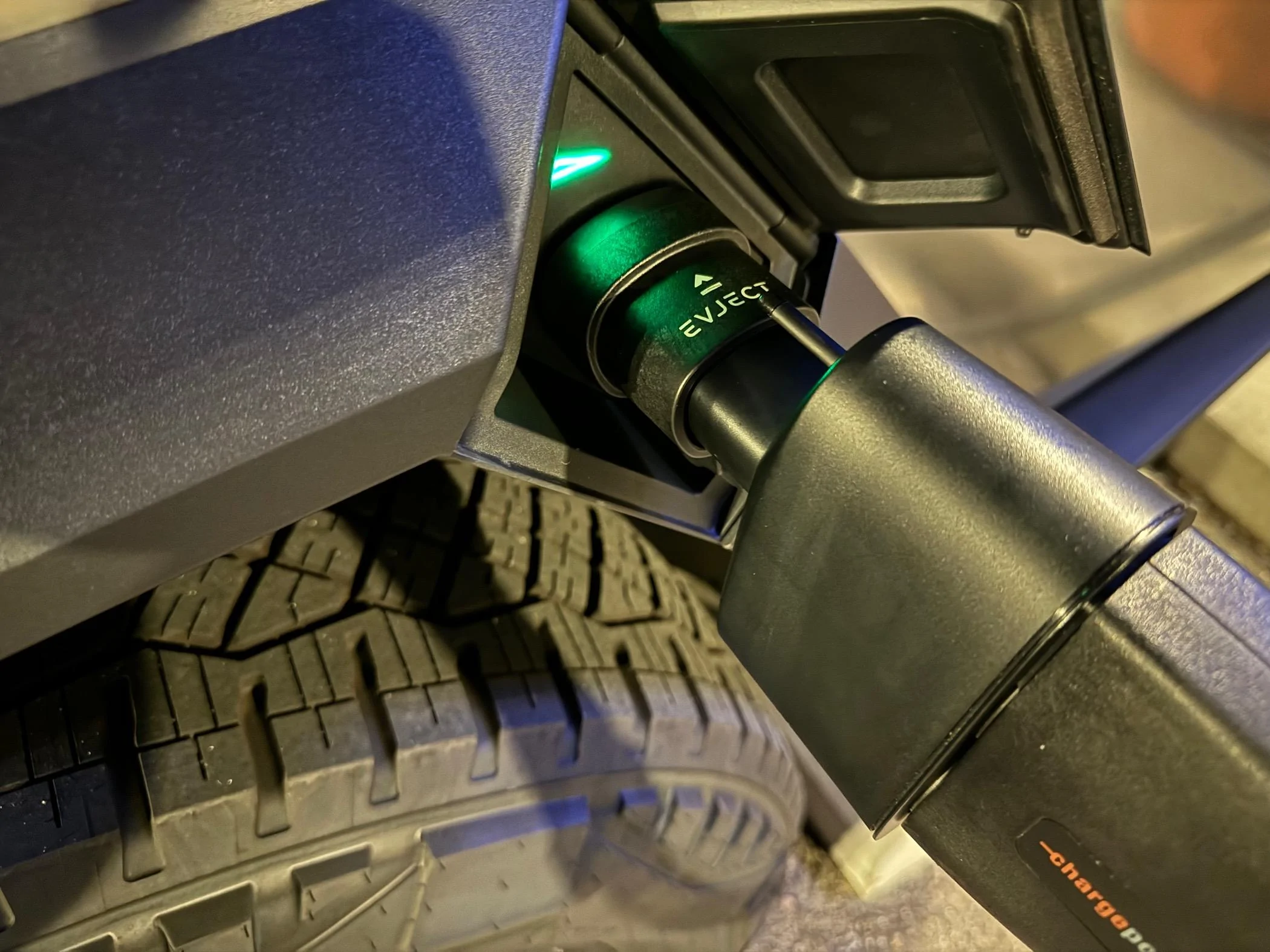

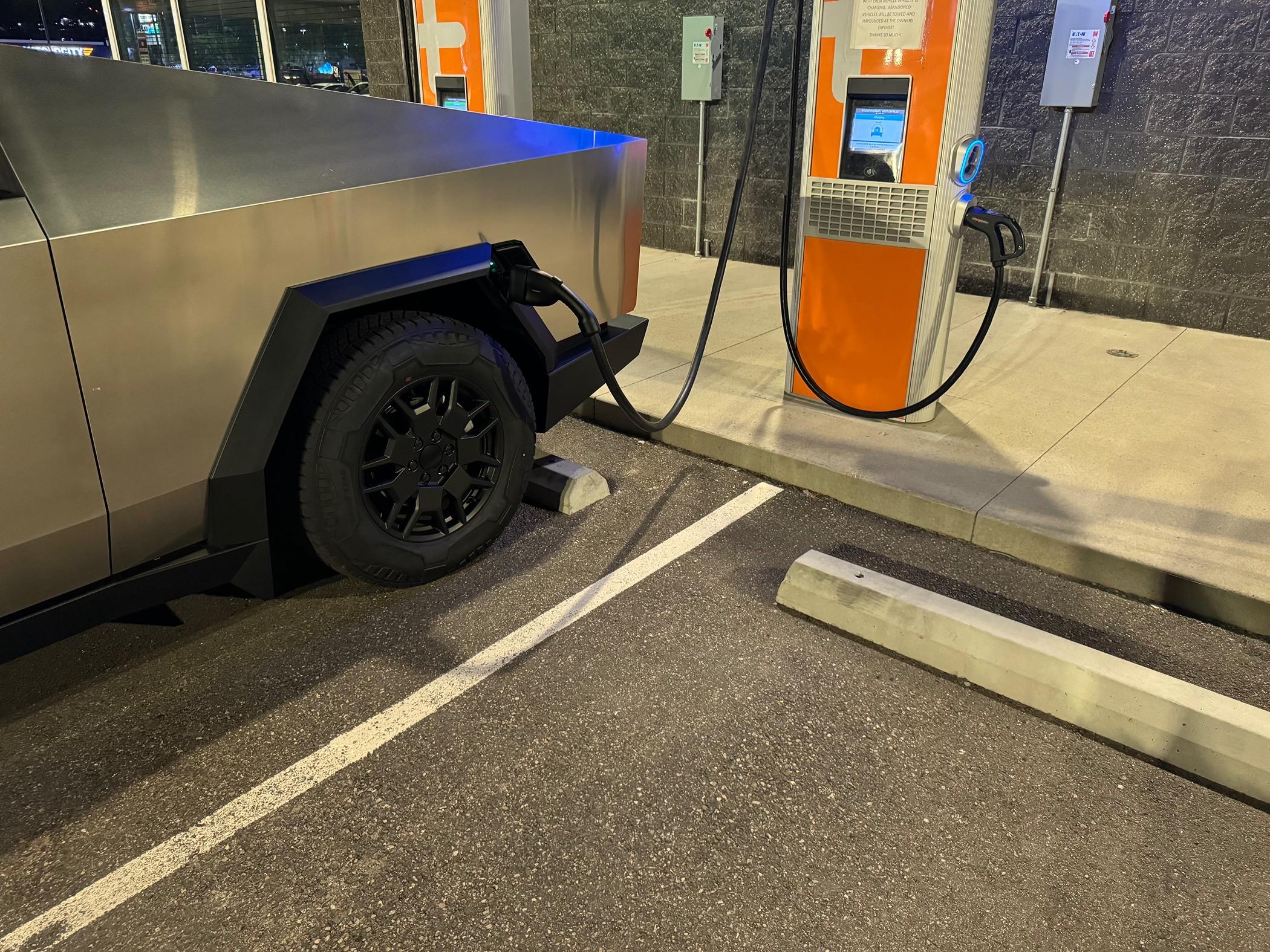

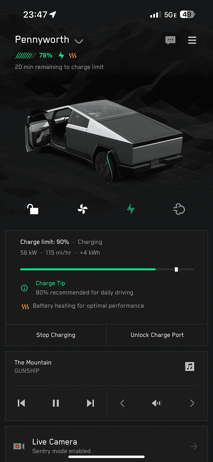

Just tested this tonight, worked just fine! Same CCS adapter I have used on the Model X over the years.
Tested CHAdeMO, it just errors out with a red charge light
Disclaimer! I have no idea if this in some way invalidates some warranty
Cybertruck software: 2024.14.3
Used the following adapters:
https://shop.evuniverse.com/products/emergency-breakaway-charging-adapter
https://shop.tesla.com/product/ccs-combo-1-adapter
