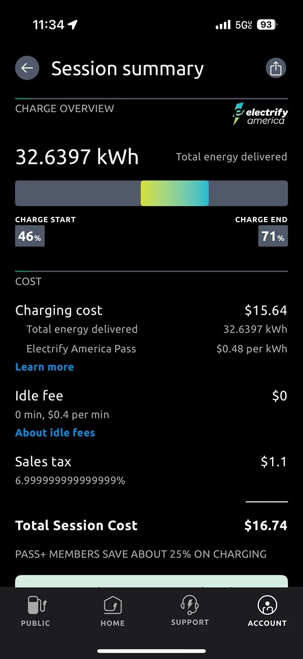

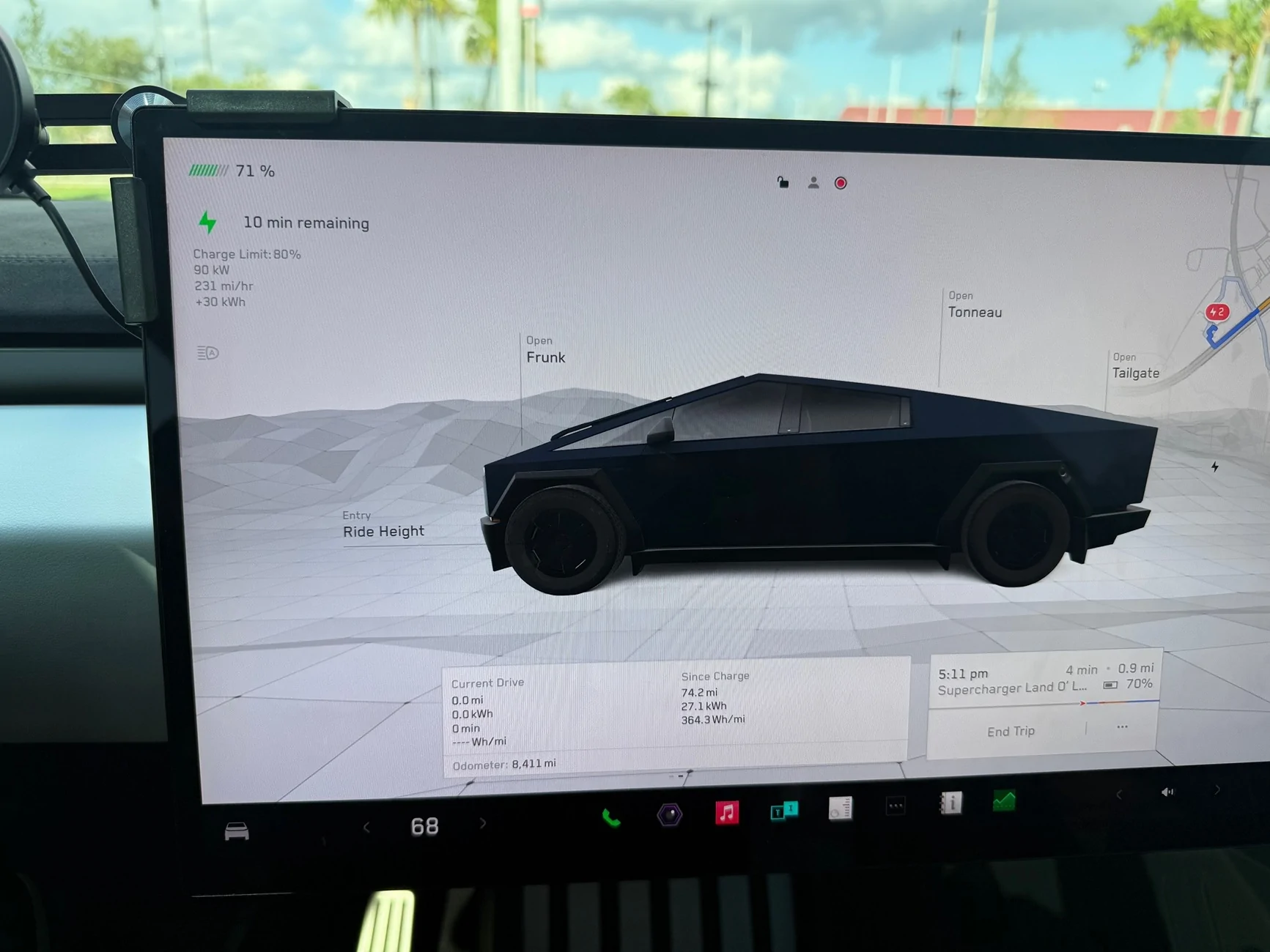

There are Electrify America DC chargers in the next row, so I moved over and tried those. 2 out of 6 broken lol. Typical for EA AFAIK haha. Anyway, these have been here a while and the connectors are worn. It slipped right into my adapter. It took a couple of tries to get it to stay well connected, but I was able to start the charge and let it go for a bit while I went to the restroom. When I came back, I noticed that it seemed like it hadn't charged much at all, but it had charged me for more kWh than I expected. I charge to 80% at home by default, including this day. It said I had used 27.1 kWh so far that day. The EA screen and my screen said I had just charged ~30kWh, but instead of being at 80%, I was only at 71%. I started charging at 46%. Either way, it seems to me that I didn't get 9% of the expected charge based on kWh's ingested.

46% to 71% is a 25% increase... 25% of 123kWh is 30.75kWh. We don't have to a couple decimal points resolution, so that could vary a bit (up to 32kWh). Then DC fast charging is not 100% efficient. 95% is about as good as you can get... at the face value of 30.75kWh, that would be 32.37kWh delivered. Even at Tesla you get charged for what is delivered to the vehicle, not what is put into the battery.
TLDR all is normal.

They charge for the kW dispensed, not the amount added to the pack. The difference is transmission losses.
I don't understand where your 9% number is coming from.
As mentioned previously:
71-46=25% * 123 = 30.8kWh net 32.6 gross = 94.5% delivered
1.8kWh lost to efficiency, climate control, and truck systems.
Versus:
80-46 = 34% * 123 = 41.6 kWh. The 27.1 kWh drive stat doesn't include energy used while parked.
Versus:
The 9% is coming from starting at 80% in the morning, and ending at 71% after charging. I didn't use 9% parked, more like 2%, if even that. So that would leave 7%.
Yep, I figured that was the difference between the 32.64kWh they charged me for vs. the 30kWh the car shows added.
