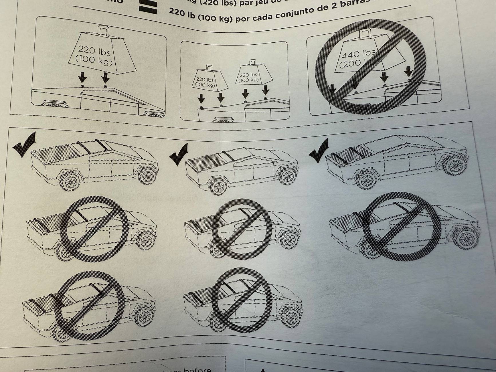

I would think they are not suggesting it because any flex with something heavy could possibly break the top window. I would just say do it at your own risk.
[/QUOTE. The flex and top glass does not seem to be the issue due to the photo shows variants that would not involve that issue as being not a recommended method as well. This is perplexing.

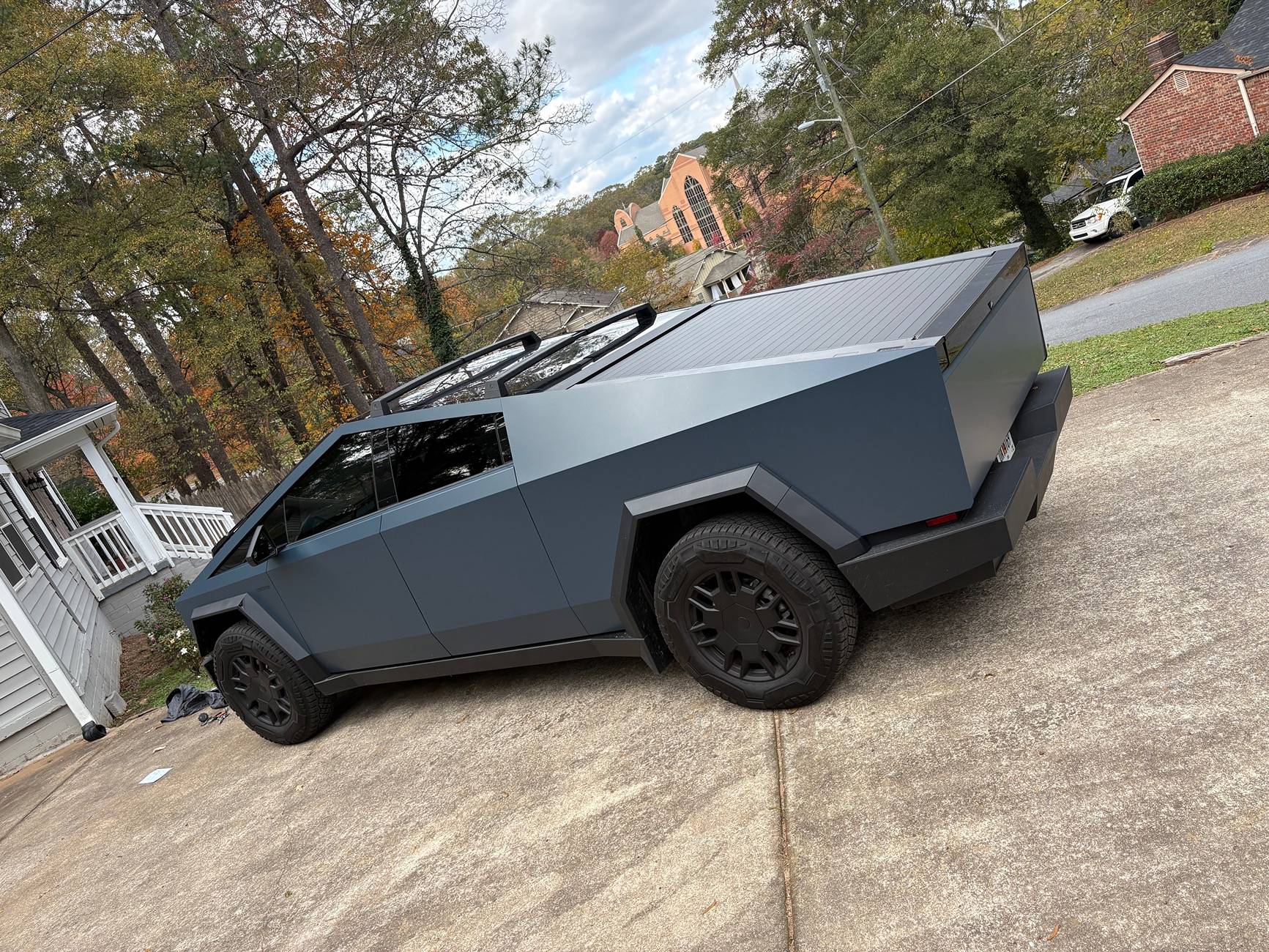

I installed mine today. Did not take two people - just me climbing on the roof. There seems to be ever so slight a bit of play in them and I can't tell if this is normal of they need to be secured better. But I resecured several times and they don't go on any more flush.

Unless I can find an engineering basis for the restrictions on the last five configuration on this page, I will use the fourth and fifth configurations to haul lightweight, long items, such as pvc pipe, trim lumber. I also think the fourth configuration would work for soft items that weigh less than 150 pounds or so, such as a mattress. Actually, those are the type of things I haul that are most likely to need the crossbars.

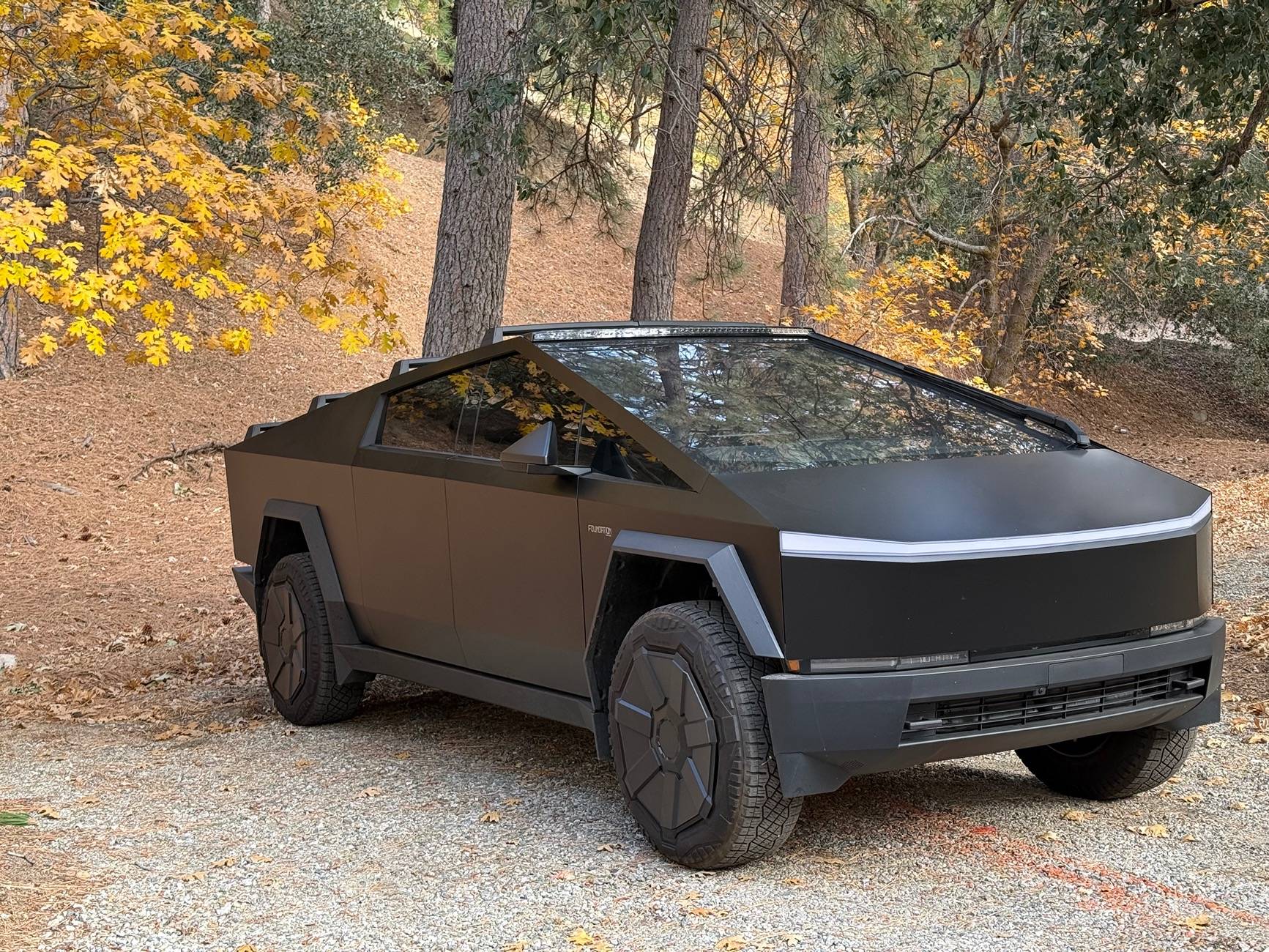

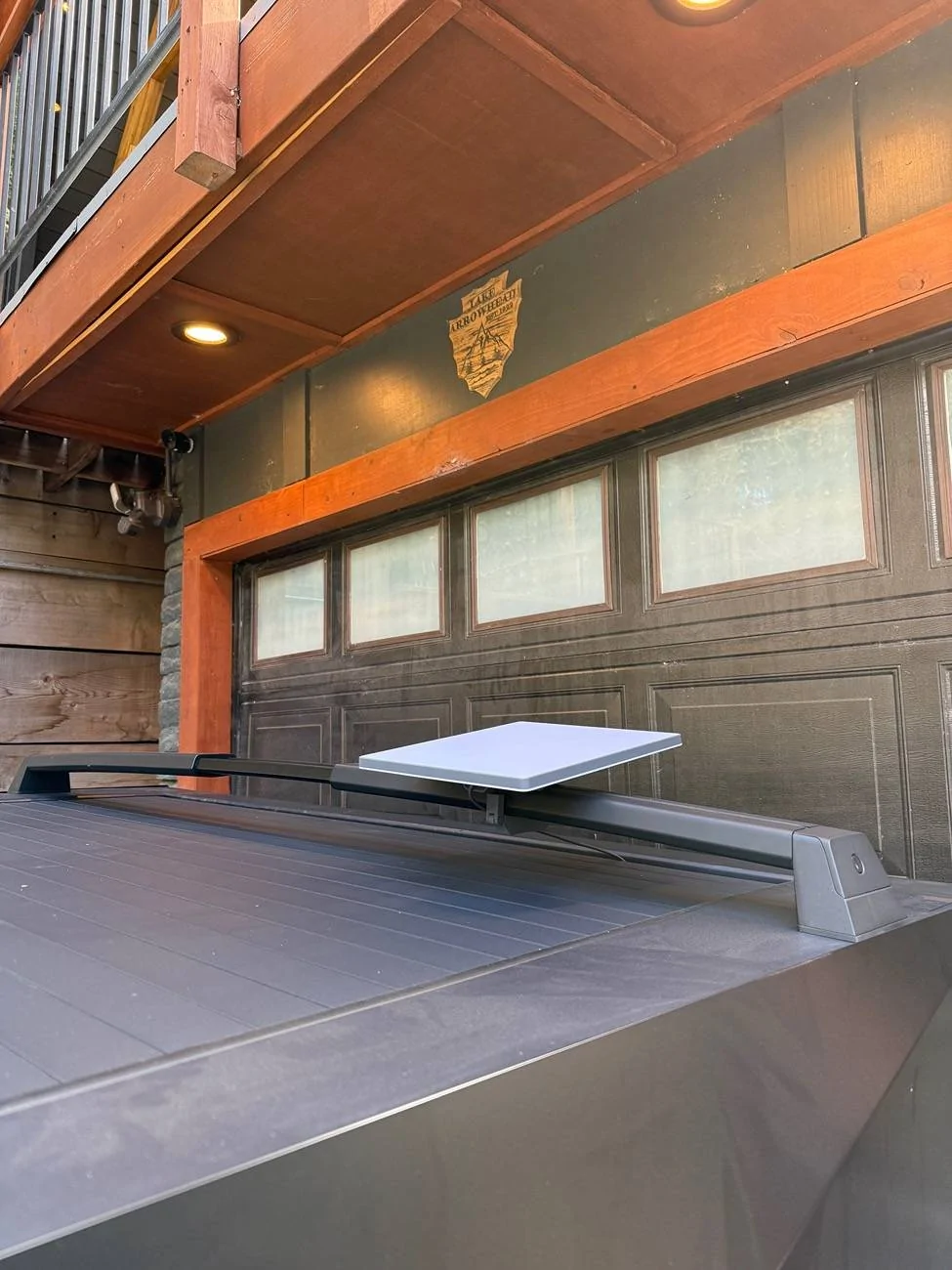

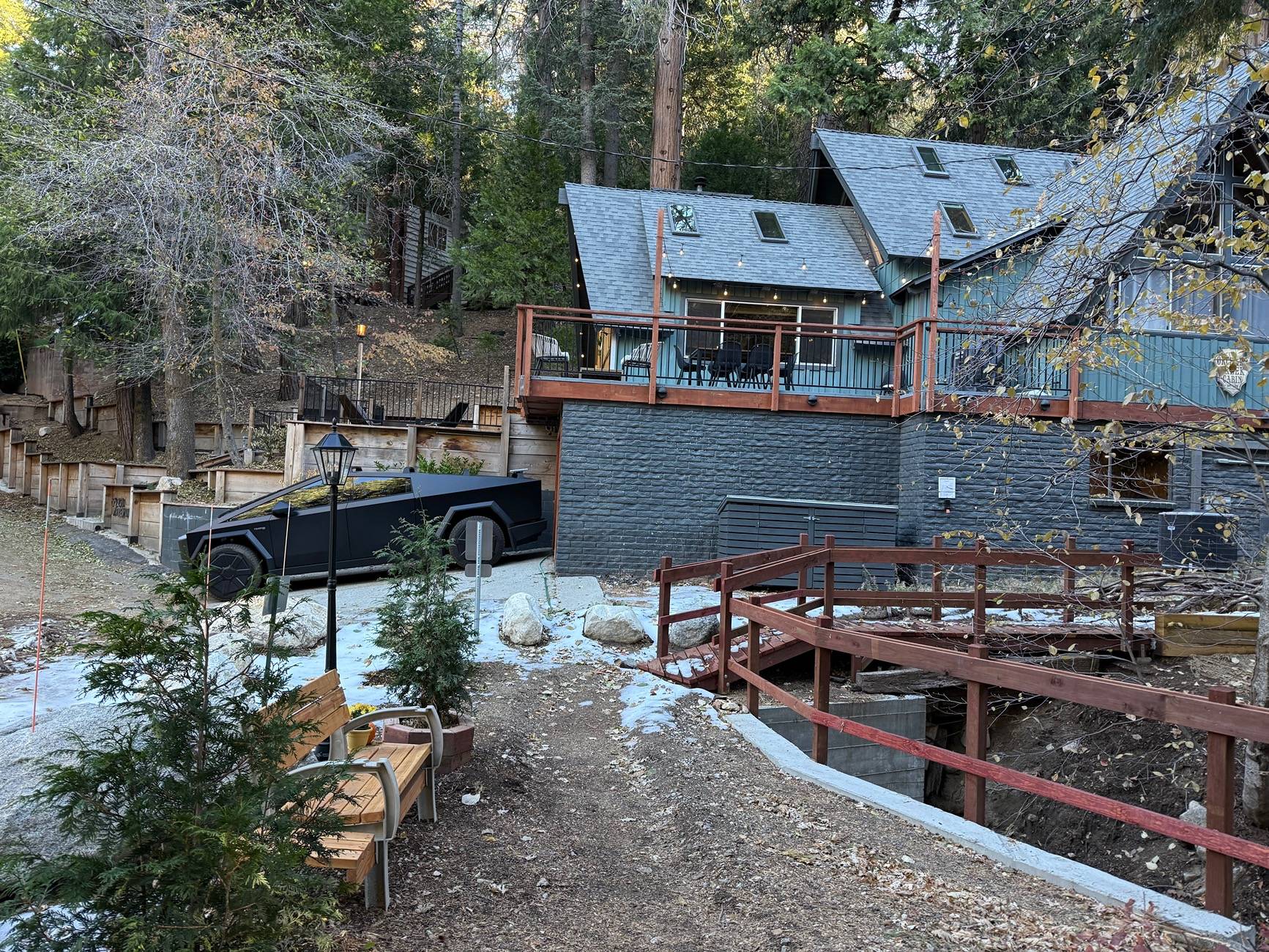

Drove up the mountains to lake arrowhead this weekend
Starlink was able to handle everything I threw At it from freeway speed exceeding 90 mph to some heavy winds and rain. I averaged 200 Mbps in motion in 40° temperatures.
Overall I am so glad I waited for the Tesla crossbars

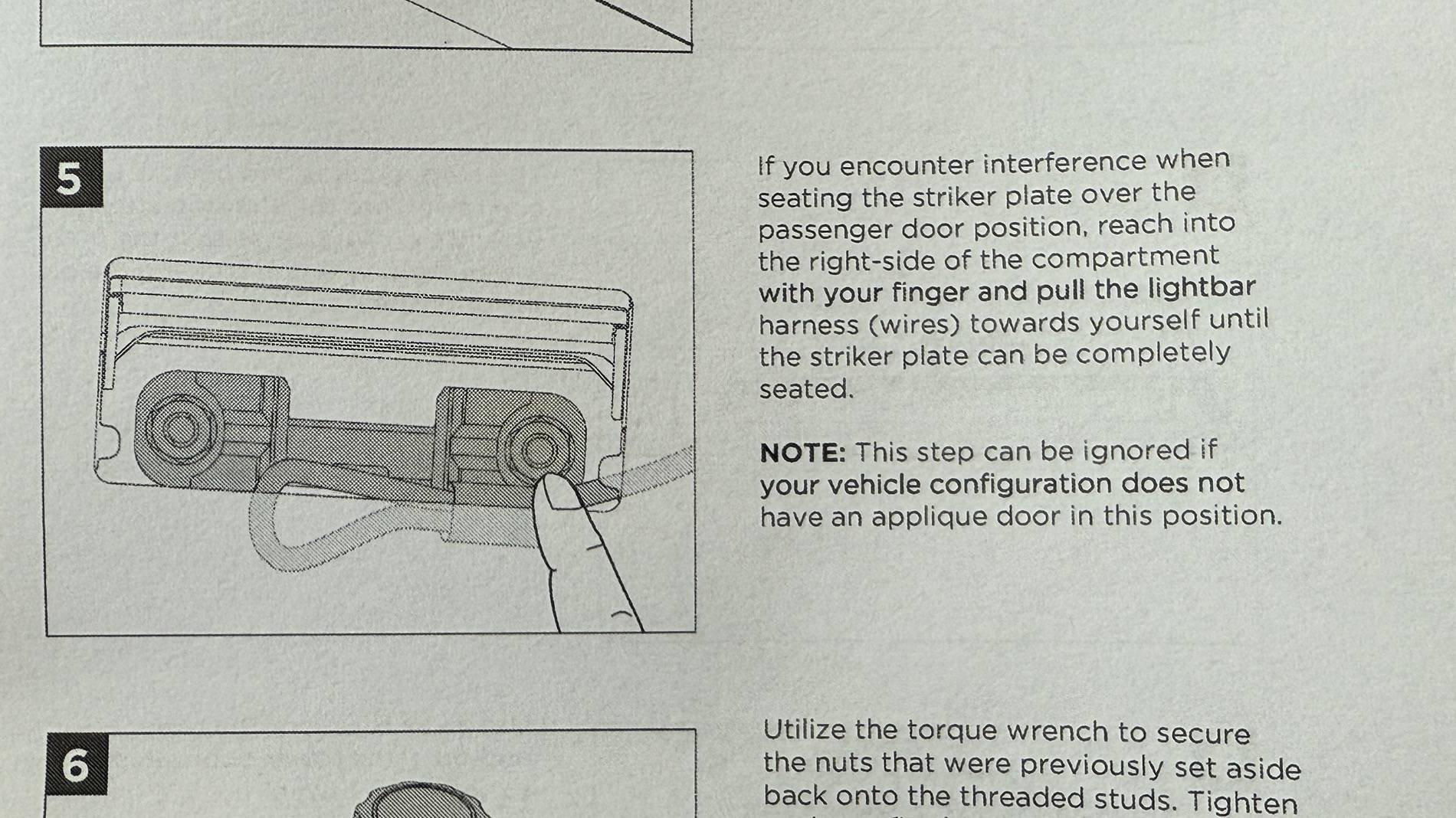

A few things:
1. I bought two sets, but I’m now convinced I’ll only ever use them in this configuration above the cabin. So, I’ll only need two.
2. They are a lot heavier than you would suspect build quality is premium.
3. They have to be torqued to 7.8 Nm but, conveniently, Tesla has provided you with a torque wrench (pictured) set to just that amount.
4. Installation is simple; however, if you have a FS CB with the light bar harness waiting to be installed you’re going to have to move that loop out of the way and it’s a bit challenging. Or at least it was for me. Follow the instructions (pictured) and pull the harness toward you don’t try to push it back. If you pull it forward there’s a little space where you can tuck it in under the appliqué. I still had to cut the loop and straighten it out to make it work but that’s only because I put the mounting plate on before I tucked it in.
5. If you bought two sets like I did, each set has enough striker points for all of your mounting positions so you will end up with extra.
6. They are not straight. They have a nice little arc to them which you can see in my initial photos. Not sure if it’s for arrow or loadbearing but either way - looks cool!
Is that a Starlink or Starlink mini? Debating between the two.
I’m also trying to decide whether to go with the Tesla crossbars vs Mars Adventure gear ones.
