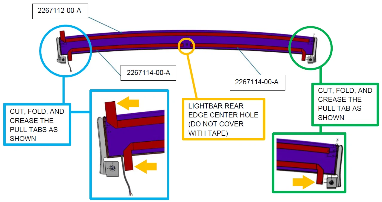

My SC installed, OEM light bar is full of water! How long I have no idea as it is not something I normally inspect. I have added it to the list of work needed when she goes on for the ever elusive PCS replacement.
perhaps they blocked the lower drain/vent hole?
That hole is at the rear of the lightbar, so it’s close to the top edge of the windshield and ‘above’ the front edge when installed.
If anything, it seems like it would allow water *in*, haha!!
But maybe it’s a vent to allow water vapor out?
