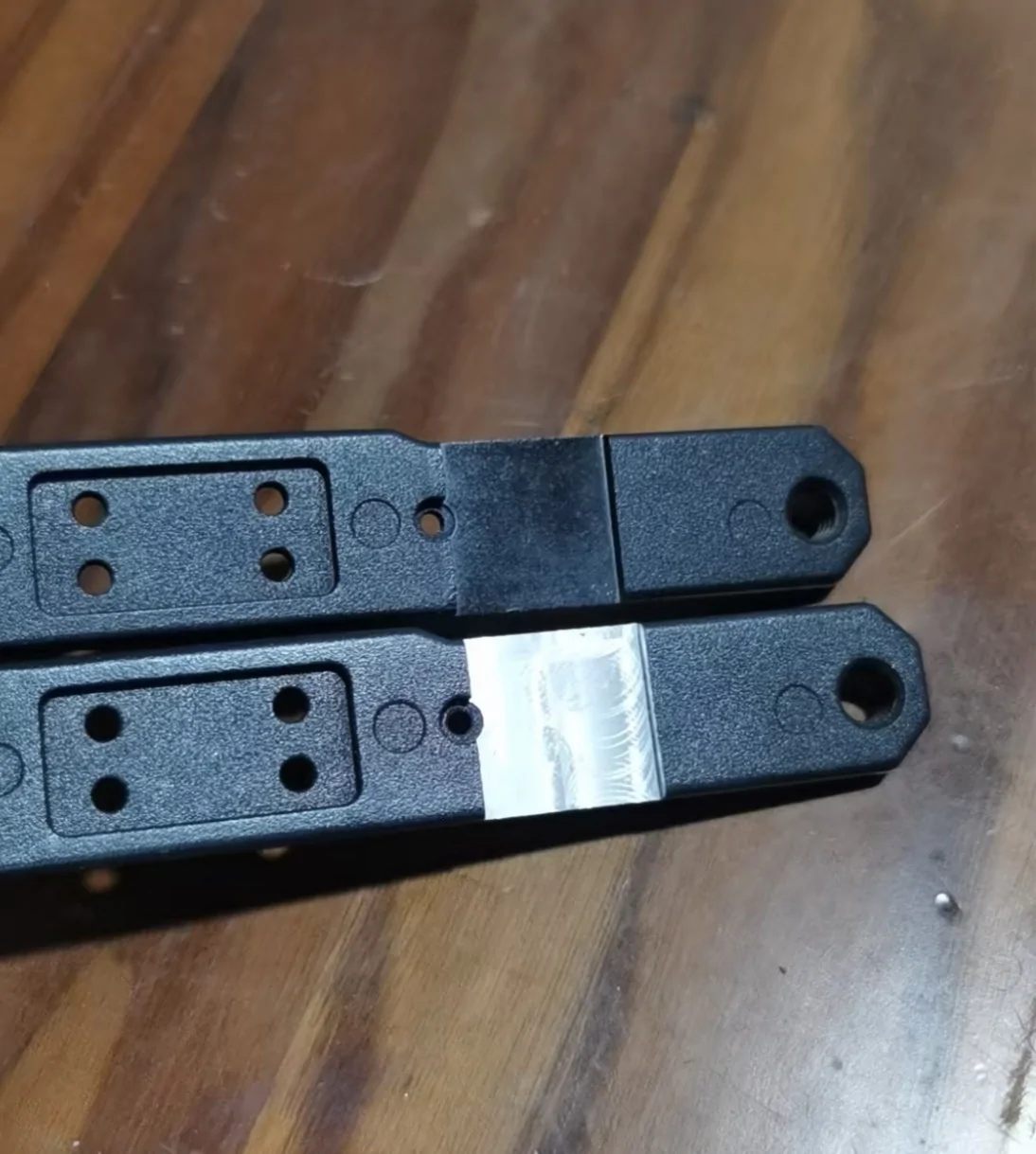

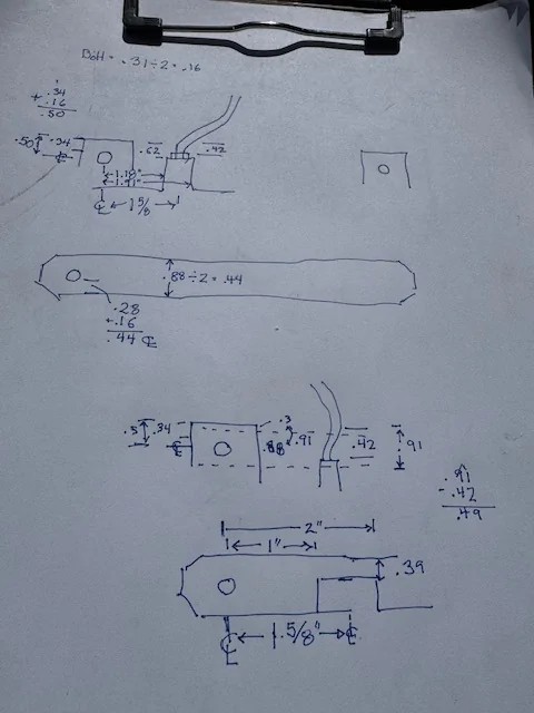

Here is the picture they sent me with the “fix”. We will see when I get it, it it works…

I’m not exactly sure that modification would be adequate. I guess we will find out. Meanwhile, I absolutely am enjoying the new screen position.

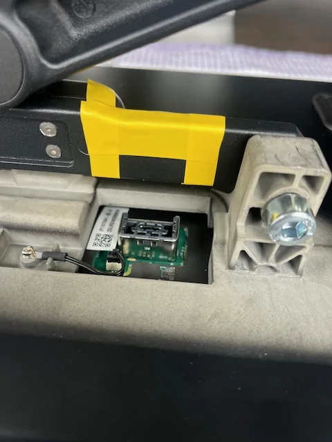

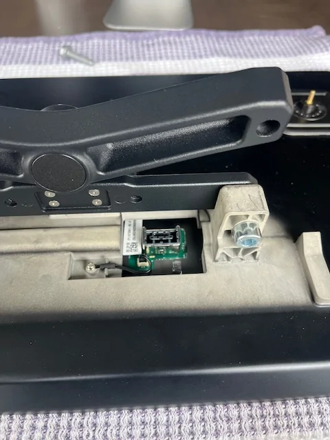

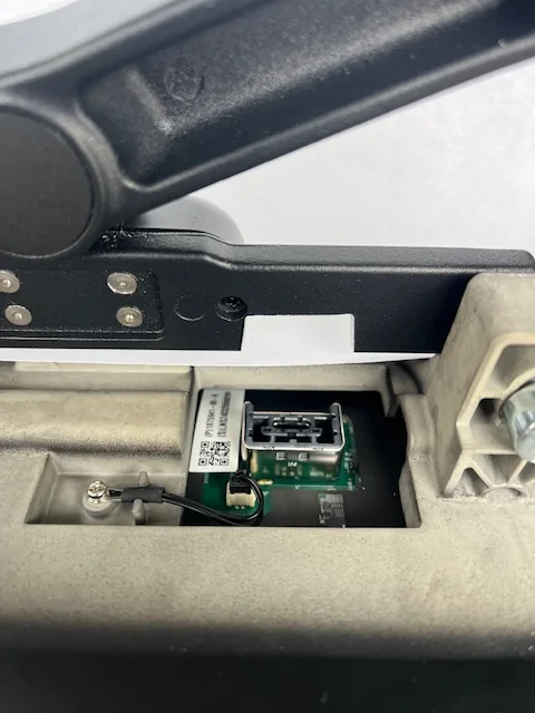

Thanks, tide80, for posting your dimensions! I ordered V2 as well before all the issues started being posted. Rather than go through the return process, I used your method to notch the bracket. This worked just fine. I measured 32 times and actually dry-mounted the bracket to double-check everything. I used some yellow electrical tape to line things up, which worked very well. I have included pictures for anyone else who is going down this route. I haven't driven yet with the new install. I will provide an update once I have used the tilt for a while.
Let us know how this works out. It's hard to tell from the pics because it doesn't show the depth of the mill cut. It'll work if it's deep enough.

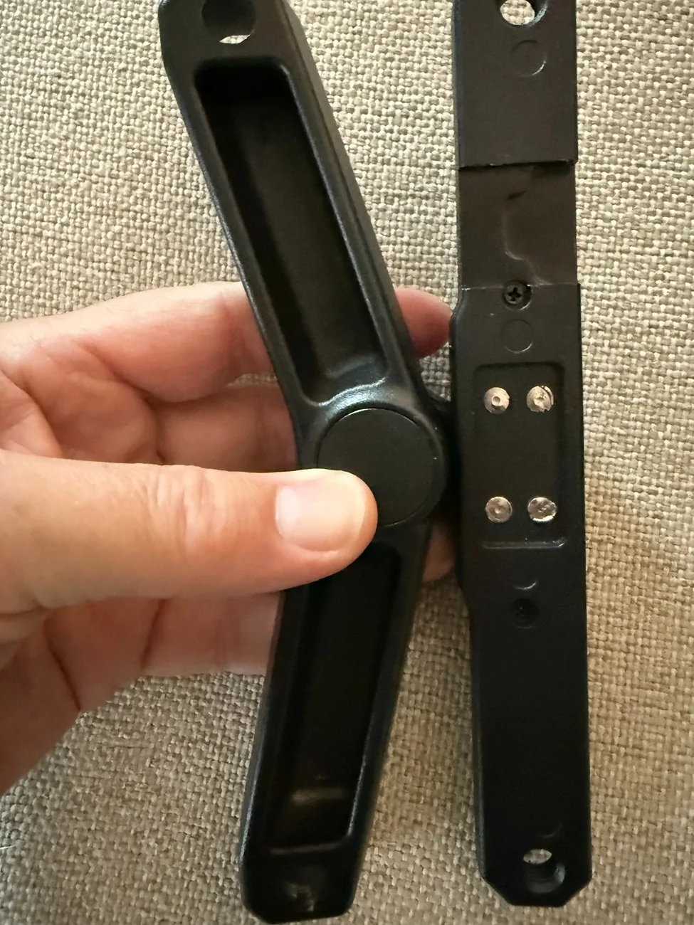

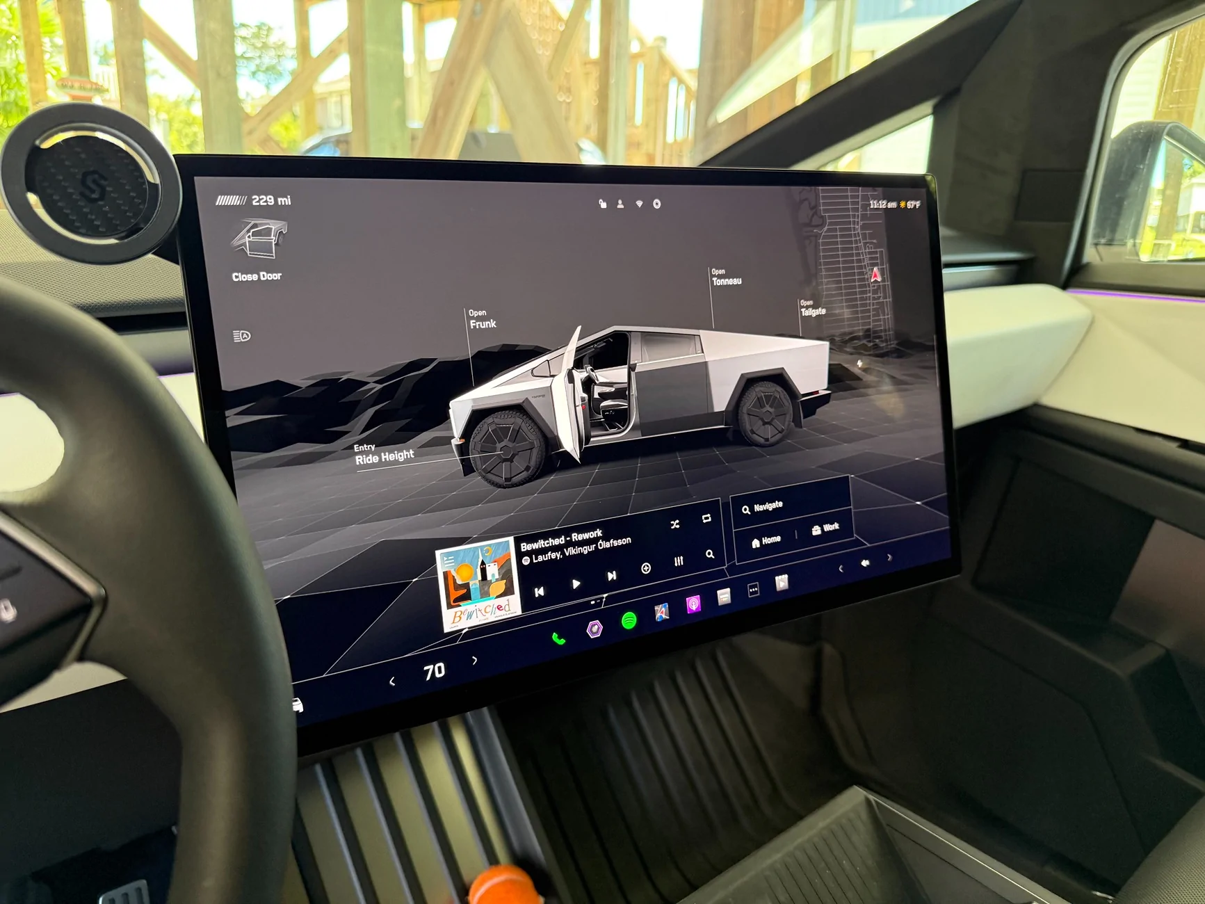

Here's an update on the bracket fitment and install. I recently received a new bracket from Tesstudio with the "cutout" for the power supply. I installed it and it works perfectly. I'll attach a photo of the new bracket and the finished install.
Overall, I am very happy with the finished product. I think it was somewhat misrepresented initially, but I am pleased with it now that I have it installed.
I highly recommend this video for the install. I ran across this guy when searching YouTube. His video is excellent and very thorough! It does take a while to install though, probably 30 to 40 minutes.

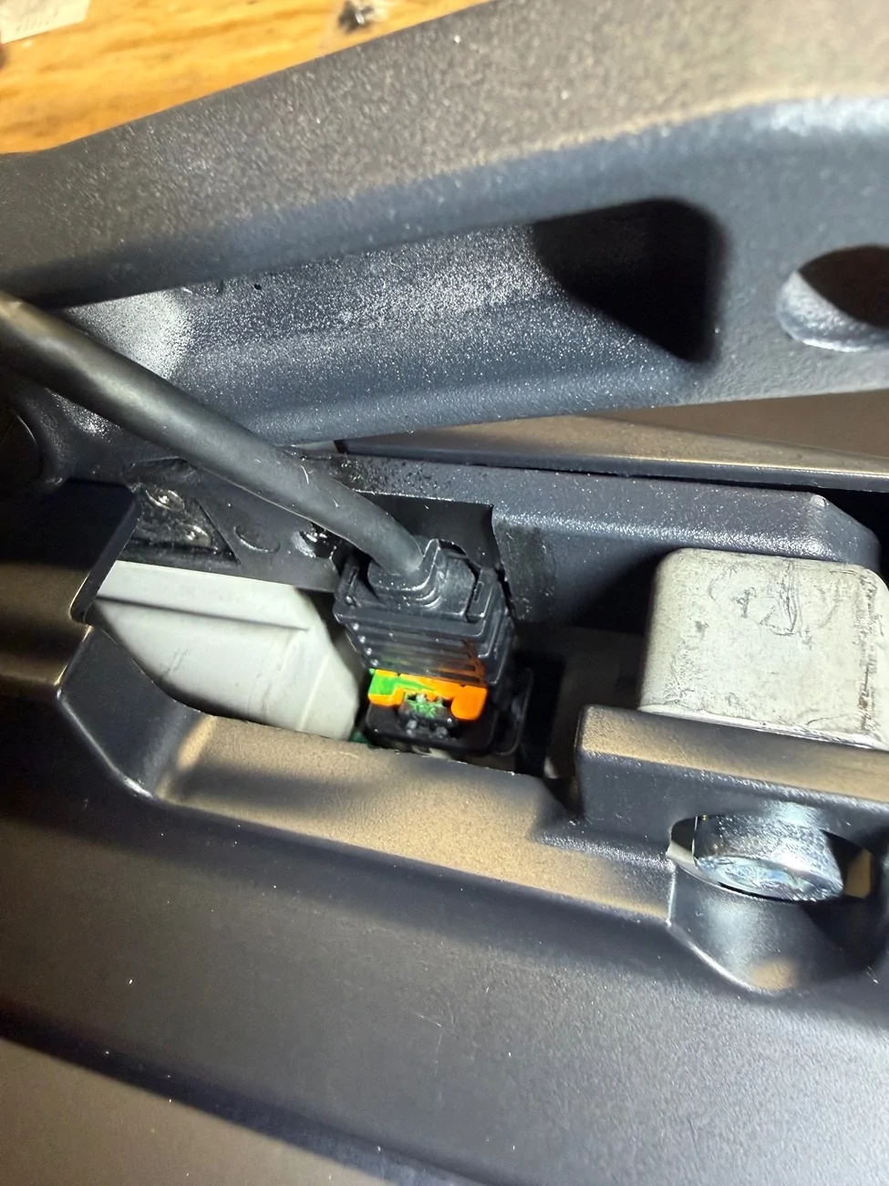

Got the updated bracket today. It fits great now. They milled out a section for the connector, a 2 step section. It looks like one of the previous pictures posted. Here is a picture of the bracket installed with the connector. I can even wiggle the connector a little bit so i know it’s not binding on the bracket anymore..
That looks really good
