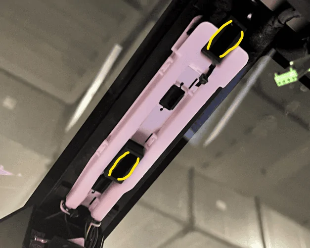

Of course day 1 of picking up the CT the overhead gear selector falls off. I can put it back up but the two pressure trim clips are too weak to keep it in place during acceleration or over big bumps.
Does anyone know a solution for this or how tesla has been fixing this? They can't get my truck into service for 20 days.

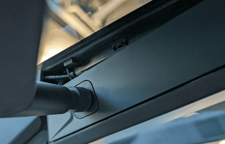

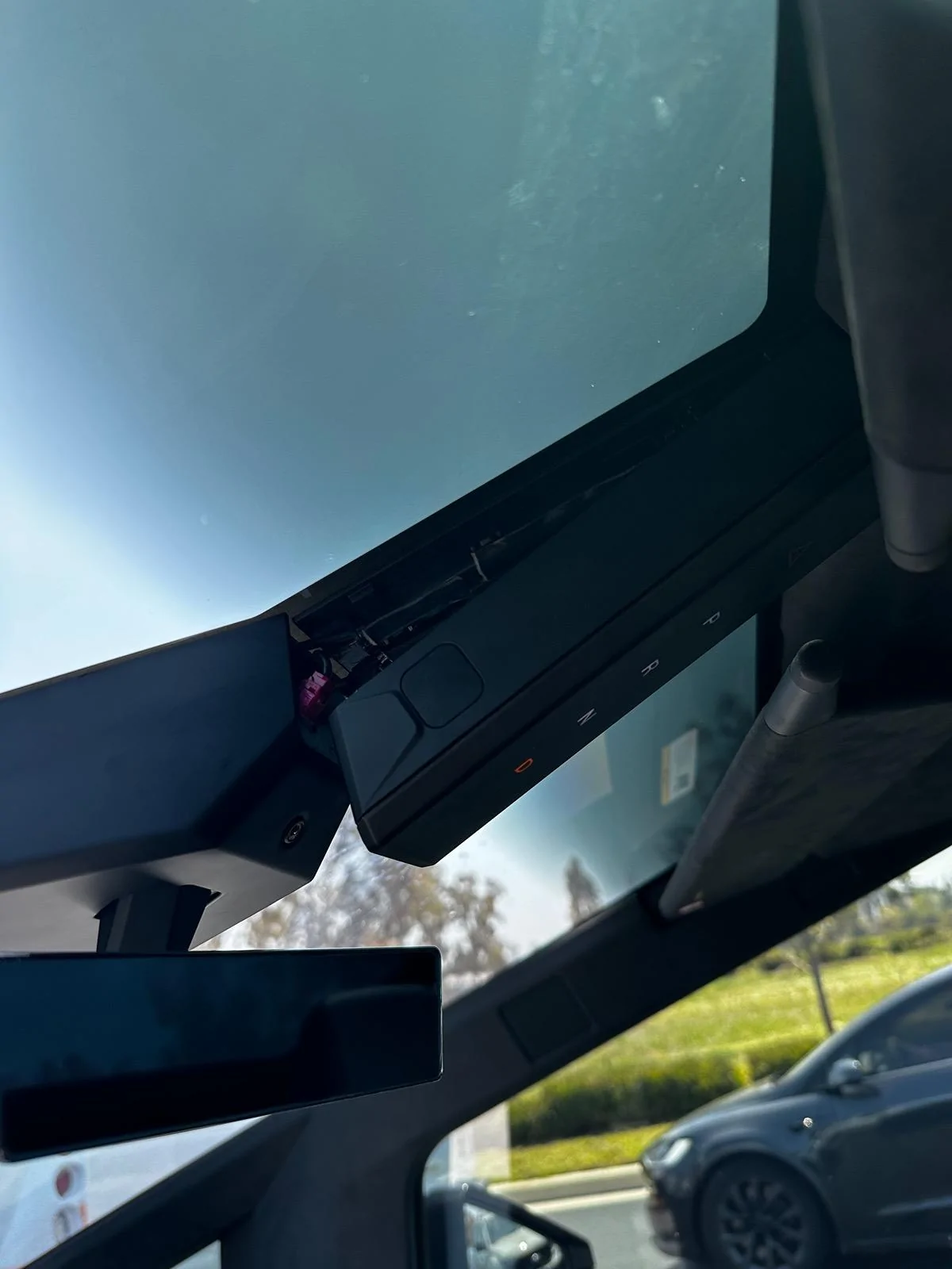

I got tired of mine falling off and came up with a fix you may be interested in. I drilled holes in the front and put a screw through each side.
