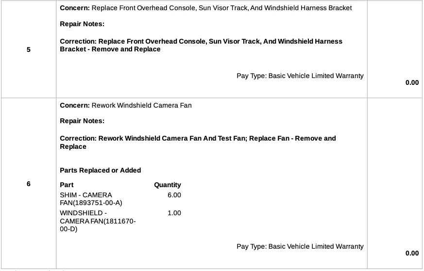

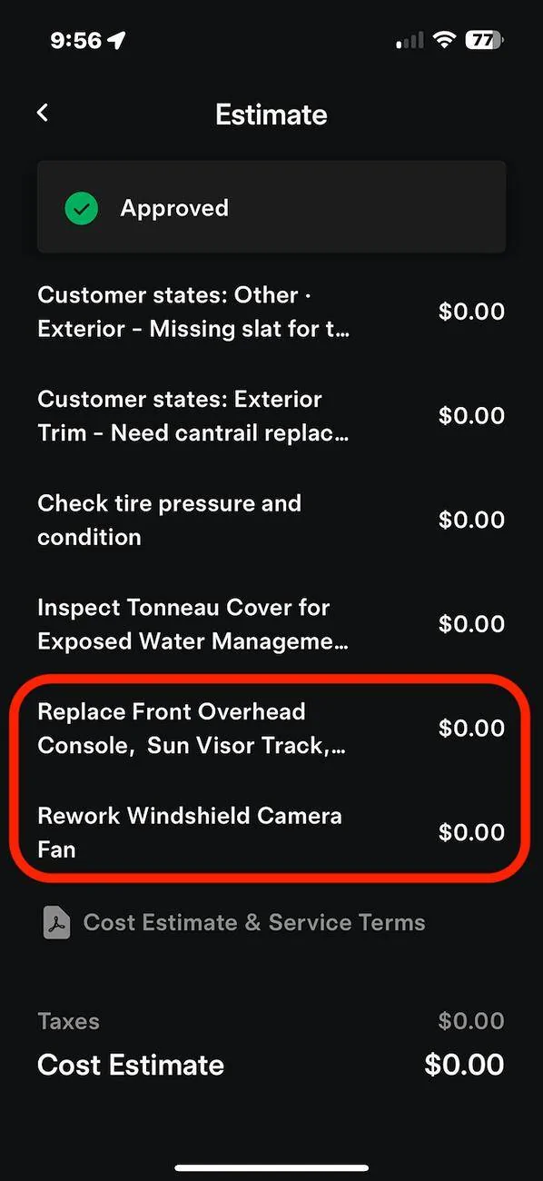

I'm not sure if this is related, but I recently opened a service request to get the missing slat added to my tonneau and the cantrail replacement, and service automatically added a couple of line items regarding the overhead console.
I've never had a problem with it, but I'm guessing it means there is an official revision to it:
Tesla Cybertruck Fix for overhead gear selector falling off IMG_3493
Looking at the linked invoice gives more details:
Tesla Cybertruck Fix for overhead gear selector falling off Screenshot 2025-07-16 at 10.04.40 AM
My FS AWD CT is from May '24, VIN 10544
