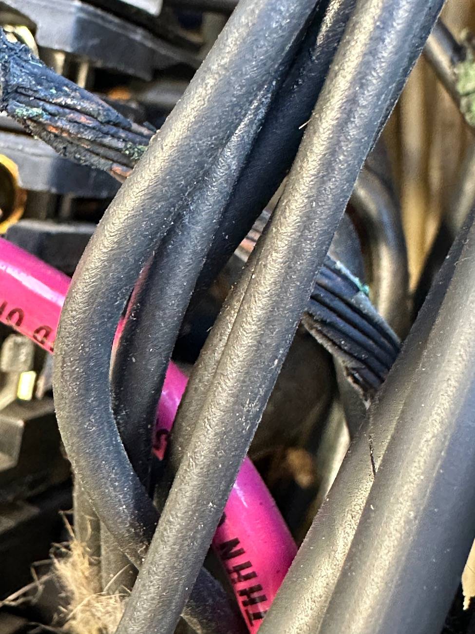

overloaded ? 60amp Circuit breaker melts wire

Melted wire after a visit from an "electrician" is NOT good.

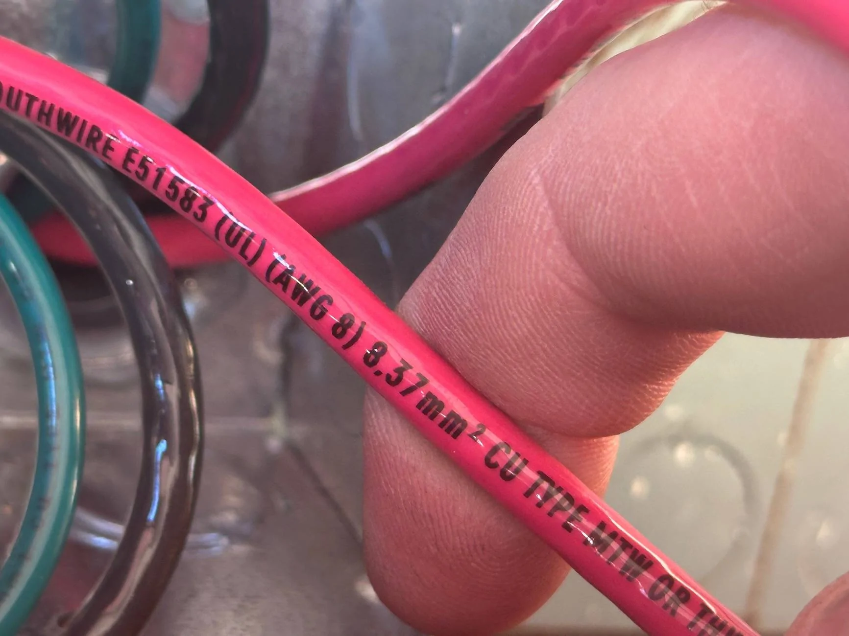

It is incorrect to install 8AWG wire (max 40A) connected to a 50A breaker. In this configuration, the melting wire is the safety shut-off for the circuit breaker :LOL:

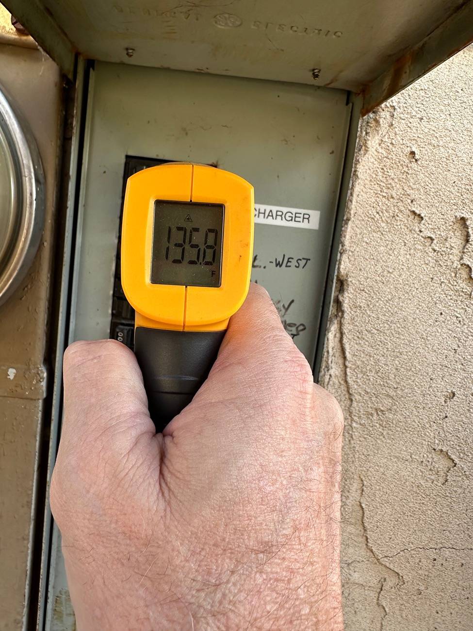

Max voltage on #8 stranded THHN should be 40 amps loaded through a 50 amp breaker. My Tesla charger was wired to a 220V 50 amp breaker in a 200 amp panel. The panel size and existing load also determine performance. My guess (based on shared photos is your panel is fully loaded.

I don't see how your 100 amp panel (while powering everything in your house) has the excess capacity to for a new EV charging load at that high rate. Sure, you can rationize that you charge at midnight when the panel is lightly loaded, but that's not how the NEC load calculations work.
Honestly, I would have someone do the load calculations and see if your panel is up to the task of handling all of the loads you have connected (and upgrade the panel if necessary if you don't have the capacity). Then re-do the EV charging circuit...
