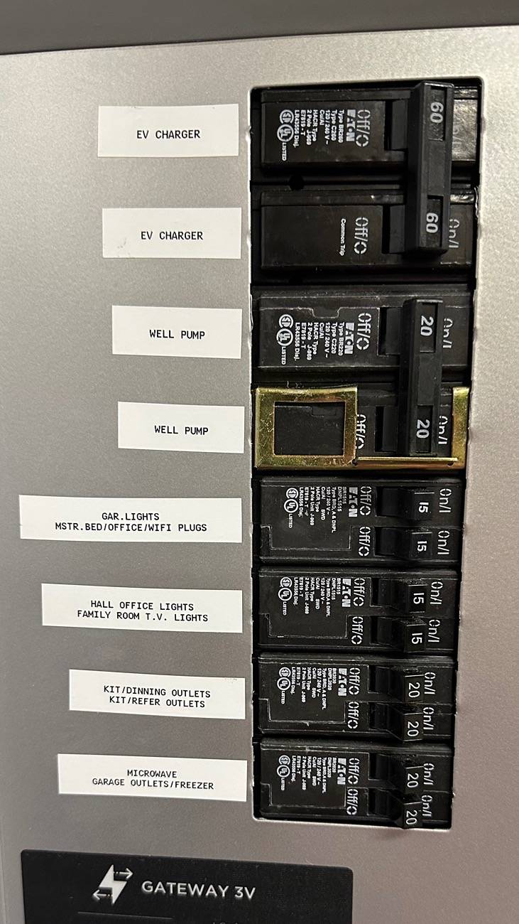

I spoke to the installer again and was told from him that the powershare gateway is rated at 200A but for the light loads install you'd only get 100A to work with. 60 Amps (charger will take 48A) goes to the CT for the charging, and therefore I'd only have the remainder to work with which may be about 6 20 amp circuits I can have.
If they are trying to put anything like the AC, than a 2" conduit would be needed to run the line.
The installer literally goes off the line item from the Qmerit quote where it states up to 10 circuits.
6 20A circuits is about right, but the reason is a little different.
That should probably be 100A of backed up load. UWC / Cybertruck is the source during Powershare, not a load.
48A continuous available @240V / 80% = 120A @ 120V
Or 60A input breaker x2 -> 3x20A output breaker x2

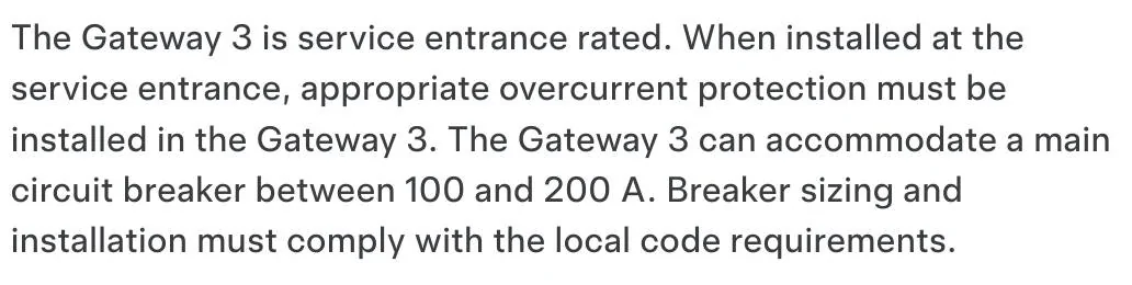

Our system was setup yesterday - our installer's first. The external power (PP&L) was routed directly into the gateway. I have 2 concerns.
1. there is no way to shut off the external power before it hits the gateway
2. there is no way to simulate a power outage because there is no breaker to turn off before the gateway
(the existing 200 amp master breaker in the breaker box still exists, so we can shut off power to the breaker box, but that is AFTER the gateway).

1. should there be a 200 amp breaker installed in the gateway just before the attachment of the external power?
[Edit: I am not an electrician, codes vary by region.]
YES!
2. is this breaker an option (ie only needed if you want to simulate a power outage) or a necessity (safety issue, so eg a power surge won't fry the gateway)?
NOT OPTIONAL, it is required by code! And Tesla installation manual.
Tesla Cybertruck Powershare Gateway Circuit Breakers? SmartSelect_20241016_092855_Firefox
Dare I ask, did they convert your main panel to a subpanel? (Separate neutral and ground)
https://energylibrary.tesla.com/doc...UID-6A472F9F-13F3-4019-ABDD-C9BDE2CDEC38.html

I see an instruction video that if a breaker is installed, that “neutral to ground bonding screw must remain intact, and all other panels must have ground and neutral isolated”. Means nothing to me, but hopefully it means something to my installer. I will check with them. thanks.
Exactly, there must only be one connection from neutral to ground in the system, and that goes at the service disconnect, which the gateway should be (via main breaker) as the first thing after the meter.
The main panel used to be the disconnect and bond point.

Mongo, cybergus, thank you both! Our installer is coming back next week to insert the 200 amp breaker in the gateway, and also changing the neutral and ground settings in the gateway and the sub panel for that install. Then I’ll be able to flip the switch and try a simulated power outage. Really appreciate everyone’s help. Love this forum.
