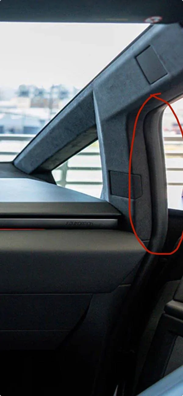

I have it too. For me, it’s coming from this rubber seal. When going fast and/or windy conditions, this rubber piece doesn’t seal 100% and can let air in creating the noise. I’ve had a passenger play around with it and temporarily fixes the problem but will need a more permanent solution.

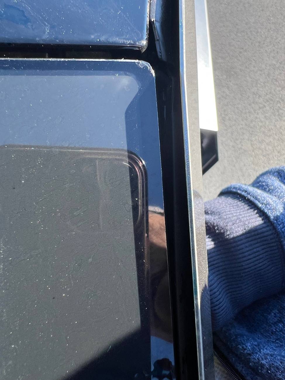

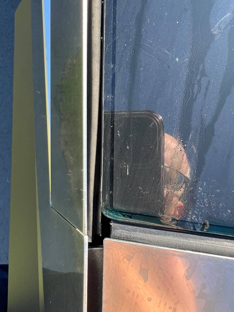

I have the wind noise too. It’s extremely annoying. Seems more on the passenger side, but very difficult to localize. Took it to Tesla, they drove around, made some minor adjustments to one window, but really couldn’t find out what was wrong. Said it was “turbulence”. It seems to be getting a bit worse. No water leaking. I did notice the rubber gaskets on the sides of the windshield are not aligned - on the top right it’s pushed in, and on the bottom left, it’s actually separated from the glass. Could this be the cause? I did try the painters tape along the left and right side of the windshield, but couldn’t convince myself it made anything better.
seems like a lot of people have wind noise issues, but the etiology seems to be a bit different. Adjusting a door, fixing a side window gasket, replacing a windshield, etc. Wish there was an easy way to troubleshoot this… See pics below.
i’m taking it back to Tesla for another look. It’s another four hour round-trip…

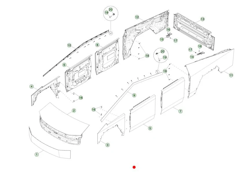

ISSUE RESOLVED IN MY CASE: I took my CT to Cypress, TX Service Center in October for what was annoying wind noise roughly in the driver's side window area, which became audible at freeway speeds and worse if the wind was strong, and which changed to a degree if I use the window switch to raise the window very so slightly when in the closed position. I assumed it was a rubber window seal issue and/or a window alignment issue.
After a brief test ride, the Service Tech said mine was about the 3rd he'd seen. He said some of the window "roof rail trim" (long, narrow stainless piece that that goes above the side windows and extends from the front of the CT to the back quarter panel; part 9 in the attached image) were bent in the manufacturing process and failed to create a good seal with the driver's window.
It got repair last Thursday (replacement of that rail trim and new header seal) and the CT is noticeably quieter. Tech's post-repair test drive report read: "CT quiet except for normal wind noise over the nose of the vehicle."
I'm very happy with the Cypress SC's quick diagnosis and fix, although getting the roof rail trim re-wrapped the next day was an added burden.
All the above was performed at no charge.
