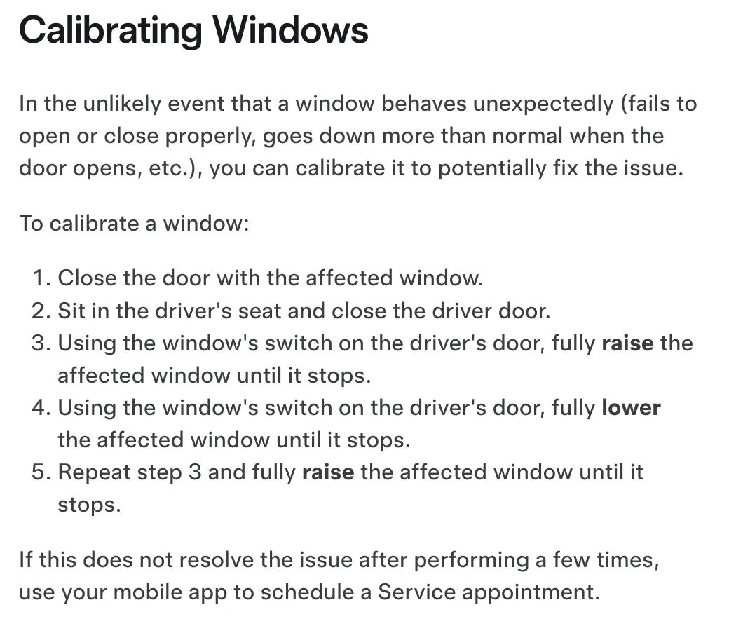

Interesting, might they have gotten the controls wet? The interior door open switch might be stuck active.
What if you roll down the window first, then close?
If that works, you could try recalibrating them.
Tesla Cybertruck Passenger door opens as soon as it's shut SmartSelect_20240613_105212_Firefox
https://www.tesla.com/ownersmanual/cybertruck/en_us/GUID-023BA2F7-CFDA-441A-BBAC-12C5F927072D.html
