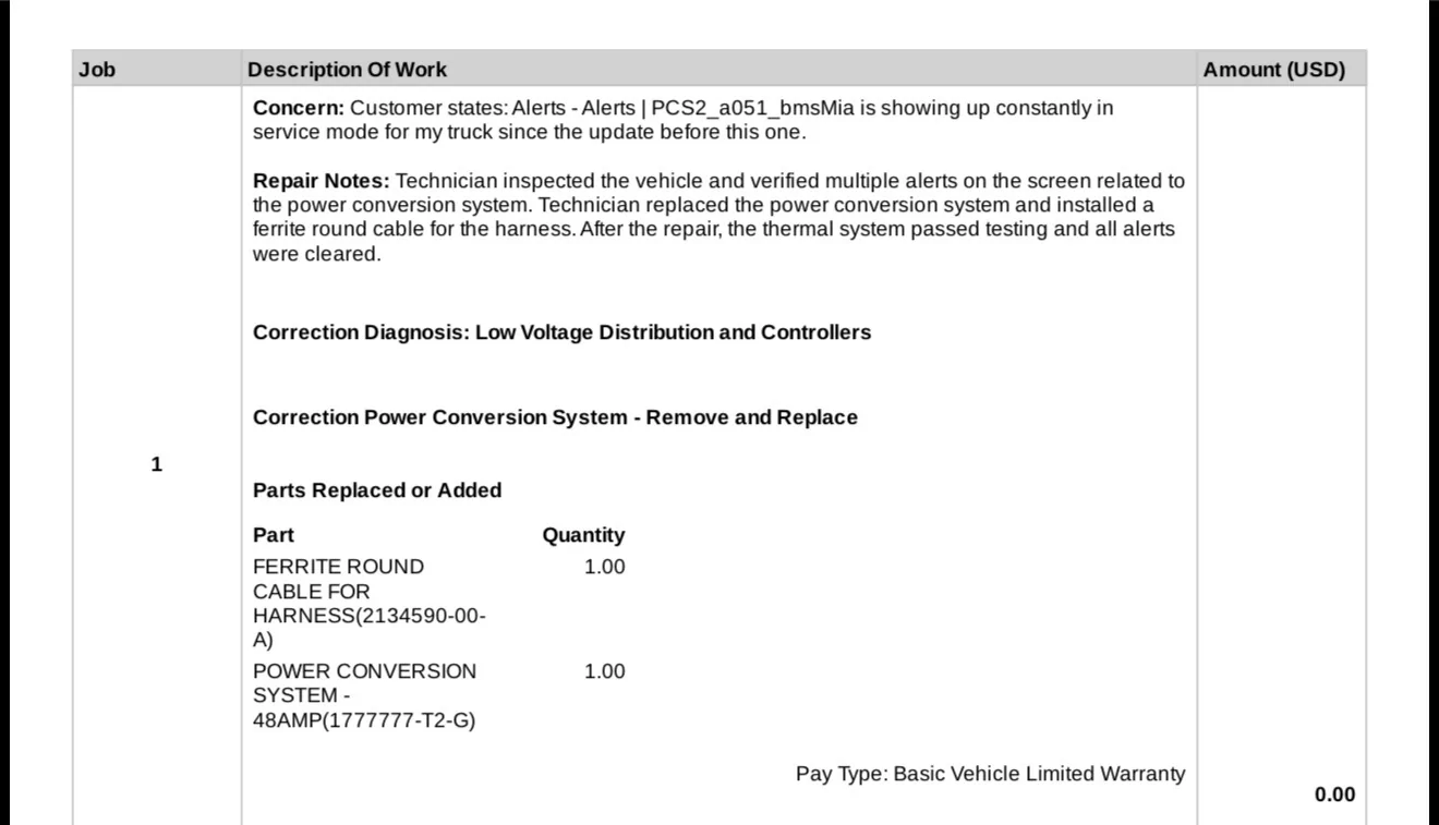

PCS2_a051 warning came up after PCS replacement

Yup. Just a follow up to my last reply. Still getting the PCS2_a051 alert in my notifications. The truck still charges though although the alert says unable to charge. Already had the PCS replaced to G version, had three other parts replaced on Friday, and yesterday getting alerts again. I’ll see what they say Monday.
