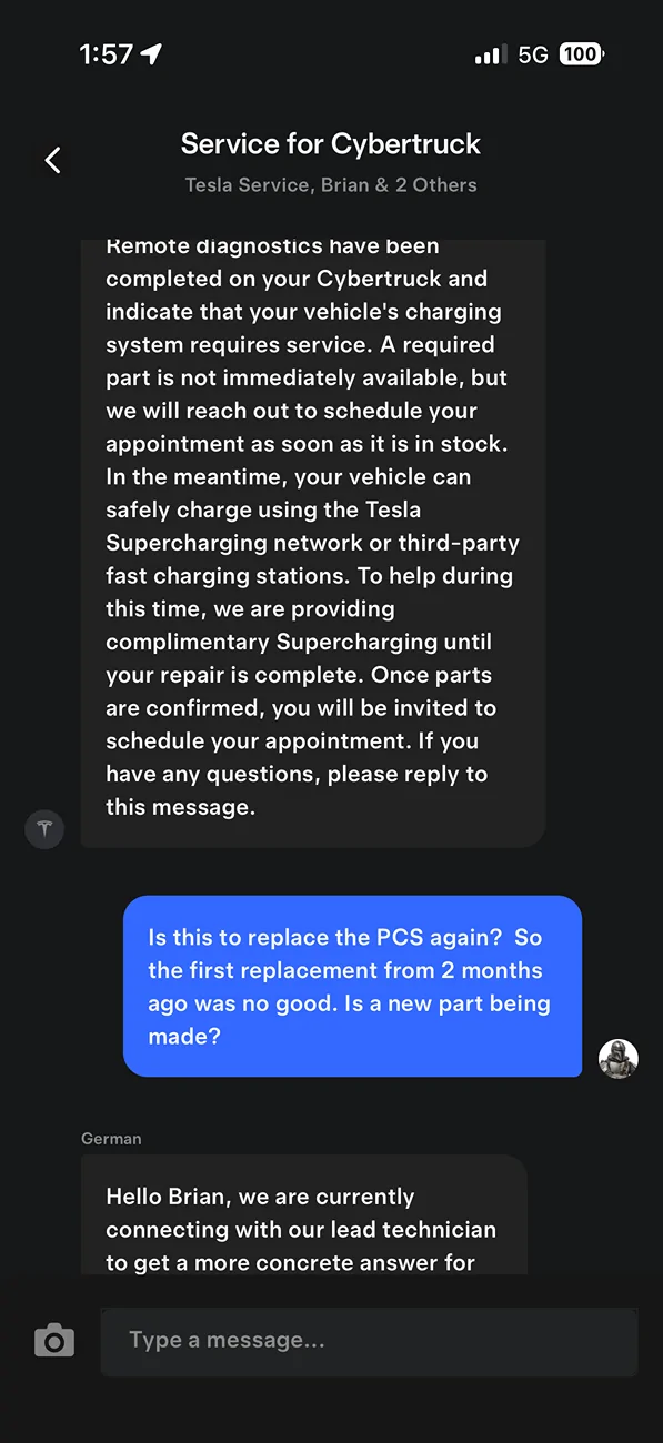

I just got the PCS2 code again myself. Mine was replaced 2 months ago. I put in a request. Let’s see what they say. Here we go again.

Keep us posted to see what they do! They mentioned to me that they have a newer revision than G rolling out.
They sent me back the cookie cutter message that they need to order parts. I replied wondering why again and if it’s a new part. They say they will get back to me. This will be a big mess of all the people that have had theirs replaced have to do it again.

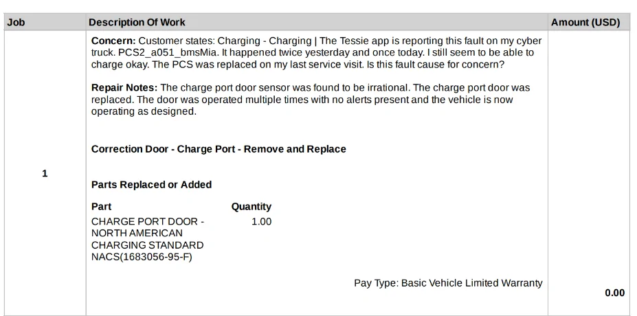

I just got back from service for the PCS2_a051_bmsMia message. They said the remote diagnostic team had been reviewing the logs and the root cause was the Charge Port door assembly which they replaced.
That's... unexpected...
