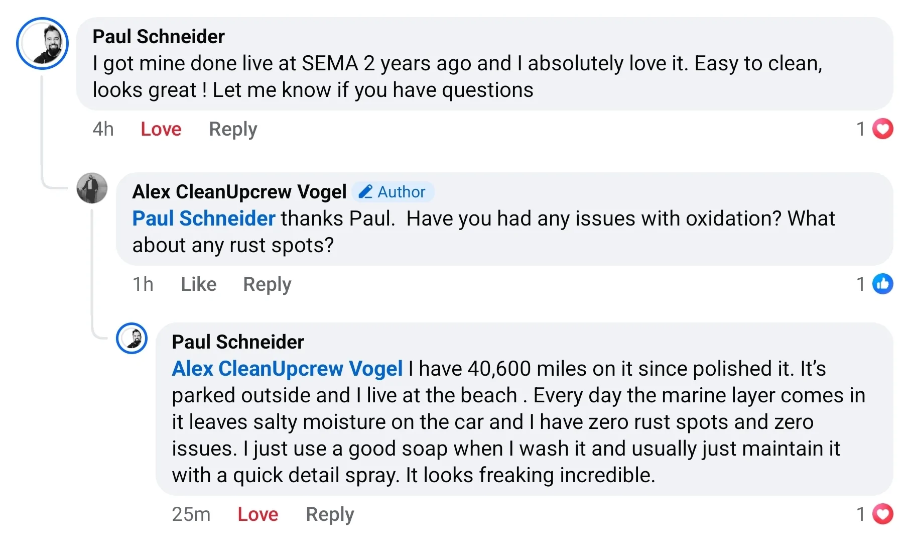

Would you as the polisher or any of you the polishees please talk a little about maintenance? How long is this good for, how do you clean it? How does it look when it starts to scuff etc.

Yes but they all go through a "touchless" wash. Even if you have a pressure washer at home..you can buy a foam cannon, get good detail soap..foam cannon on and pressure wash off. Use a big twisted loop microfiber towel to dry off...those towels are great and don't scratch. Also if any fingerprints you can literally wipe off with dry microfiber rag

Everyone we've polished said they'd pay my price for the maintenance alone. You can take it through a "touchless" "brushless" wash. If you have a foam cannon and pressure washer get a detailer soap and foam cannon on pressure wash off. Dry with one of those big twisted loop microfiber towels because they don't scratch. Also a quick detailer spray will be your best friend..you can wipe down the truck in five min and it will look brand new. Water beads off, fingerprints wipe off with dry microfiber rag. The upkeep is very simple.
