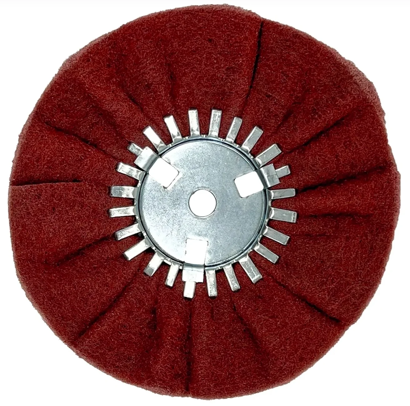

2. It's funny you say that. We have a satin buff that we want to try I'll post a picture of it here. The satin buff will definitely smooth the surface out and make it look way better than factory and be easier to maintain. We've done this to pontoon boats. They didn't want mirror polish just wanted it to look new again so we satin finish the metal.

Tesla Cybertruck Polished over 50 Cybertrucks and they look better and better each time 9405
this is the satin buff

Tesla Cybertruck Polished over 50 Cybertrucks and they look better and better each time {filename}
I may be wrong here, but wouldn't this leave a grain, similar to brushed stainless where you have a very fine linear pattern? When I was adding a brushed finish to my stainless chair posts, I had to be very careful to not get lazy and add diagonal lines with my scuff pads.
I'm guessing in this case you'd run the grain front to back, since vertical grain would look weird (who knows, maybe not?).
Either way, one thing I was surprised by was how much "brighter" brushed surfaces looked compared to the mirrored finish. I realized this is because the fine scratches scatter the reflected light, increasing the amount of rays hitting the eye as a result of random reflection. Whereas the mirror just reflects a smaller percentage that is at the right angle from your eye. Similar to seeing a regular road sign at night vs one that has a retroreflector background.
Now I want to see a sand blasted MacBook finish CT 🤣
That's a great question. We actually have a whole rear wheel panel of a cybertruck so we are going to try the satin buff and scuff dual action satin. When we do the pontoon boats we try to overlap and keep the satin airway as tight as possible. It comes out nice but I'd like to try the festool vlies.
Never even thought about it that way with the brightness of satin 🤯
Haha same here bring the MacBook on!
Do you use that on a rotary machine or a random orbit? I think the secret for a satin finish is a RO machine. Otherwise isn't it difficult to control the swirl marks?
Metal polishing is such an art because it's about controlling the way the light reflects off all the microscopic scratches. Different abrasives, even when they are the same grit, will make different kinds of cuts which will impact the look. The softest looking finishes will require more expensive abrasives that are graded to a more uniform size. When the abrasives have a larger variation in size the look is not as nice.
