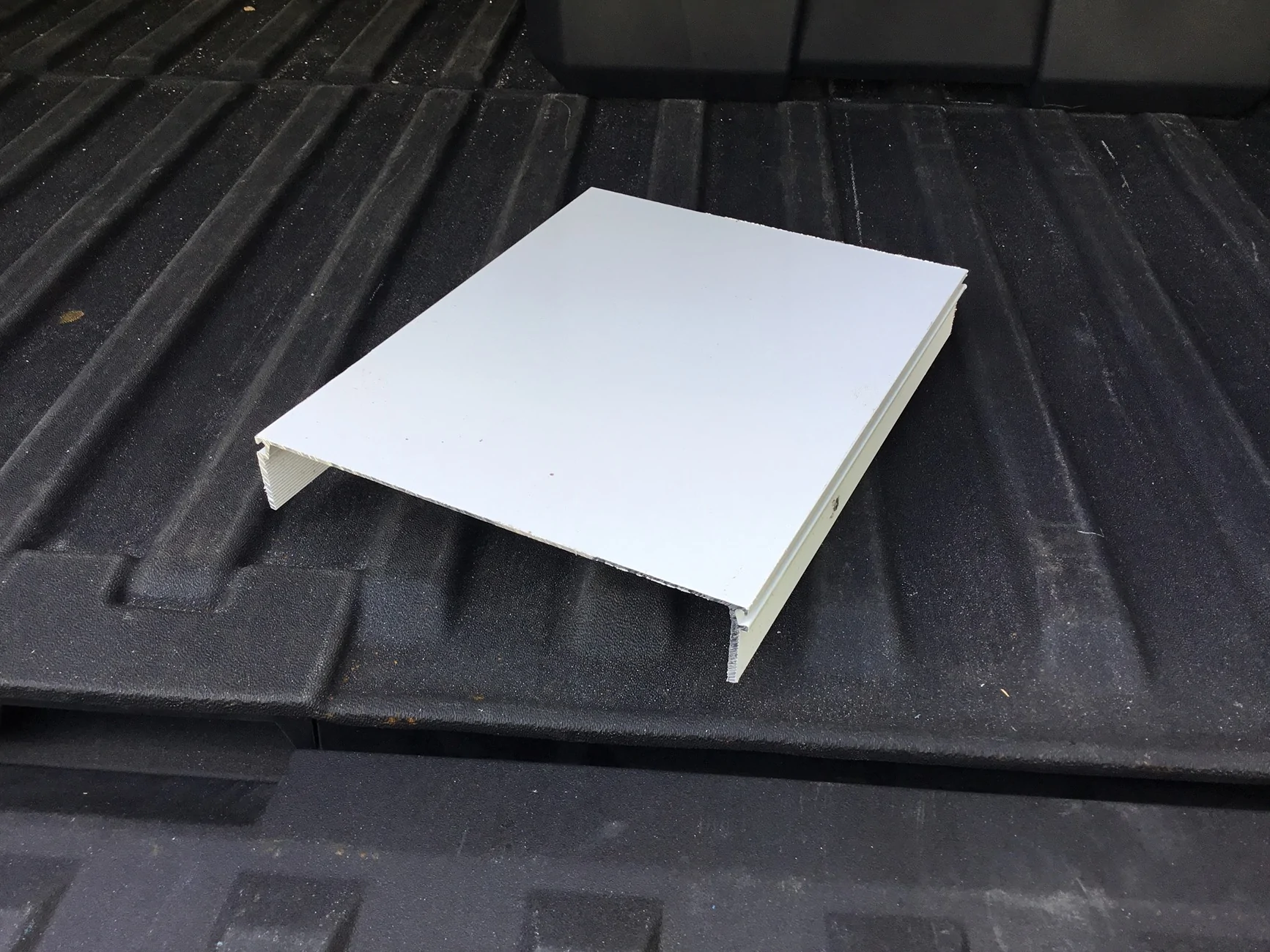

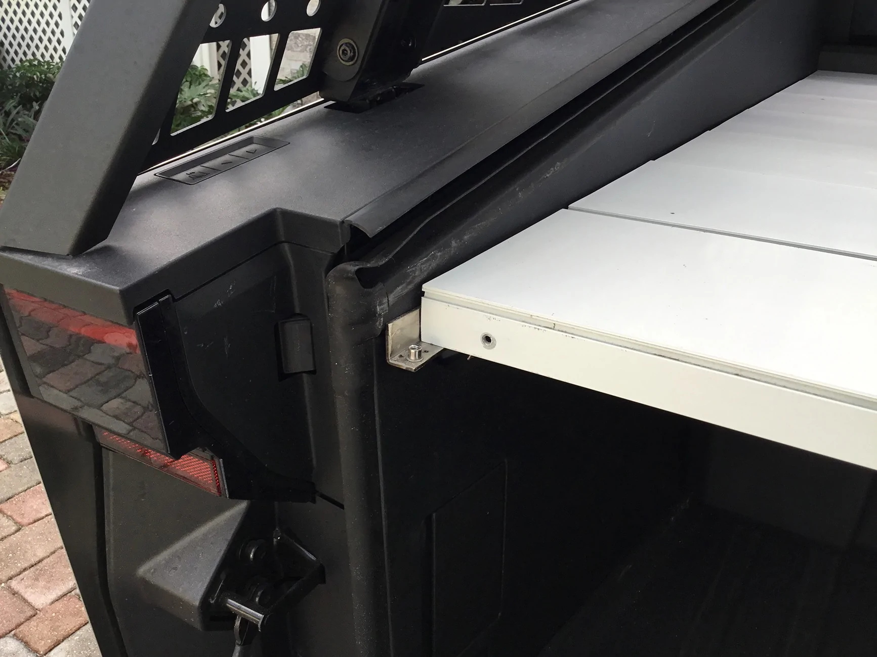

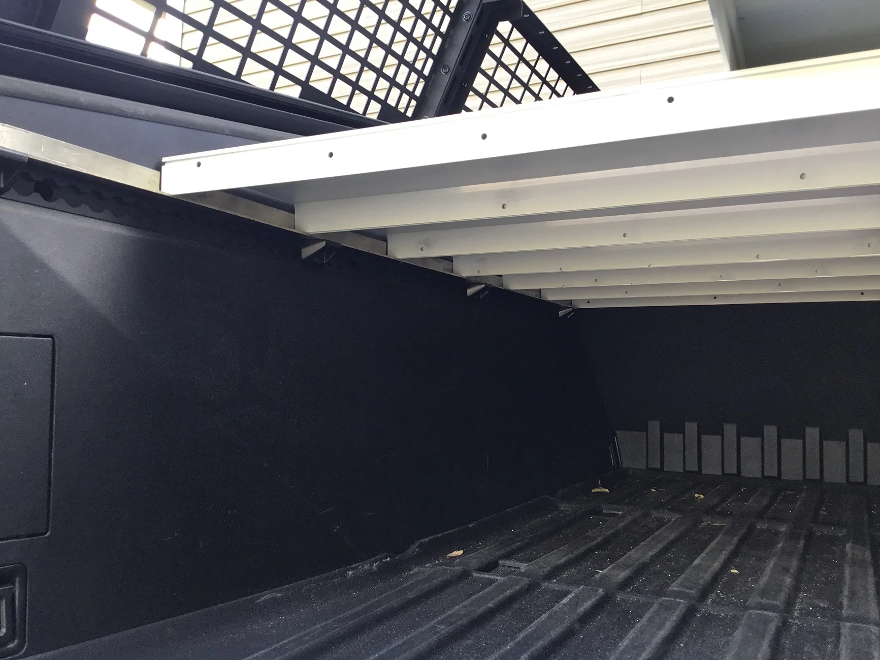

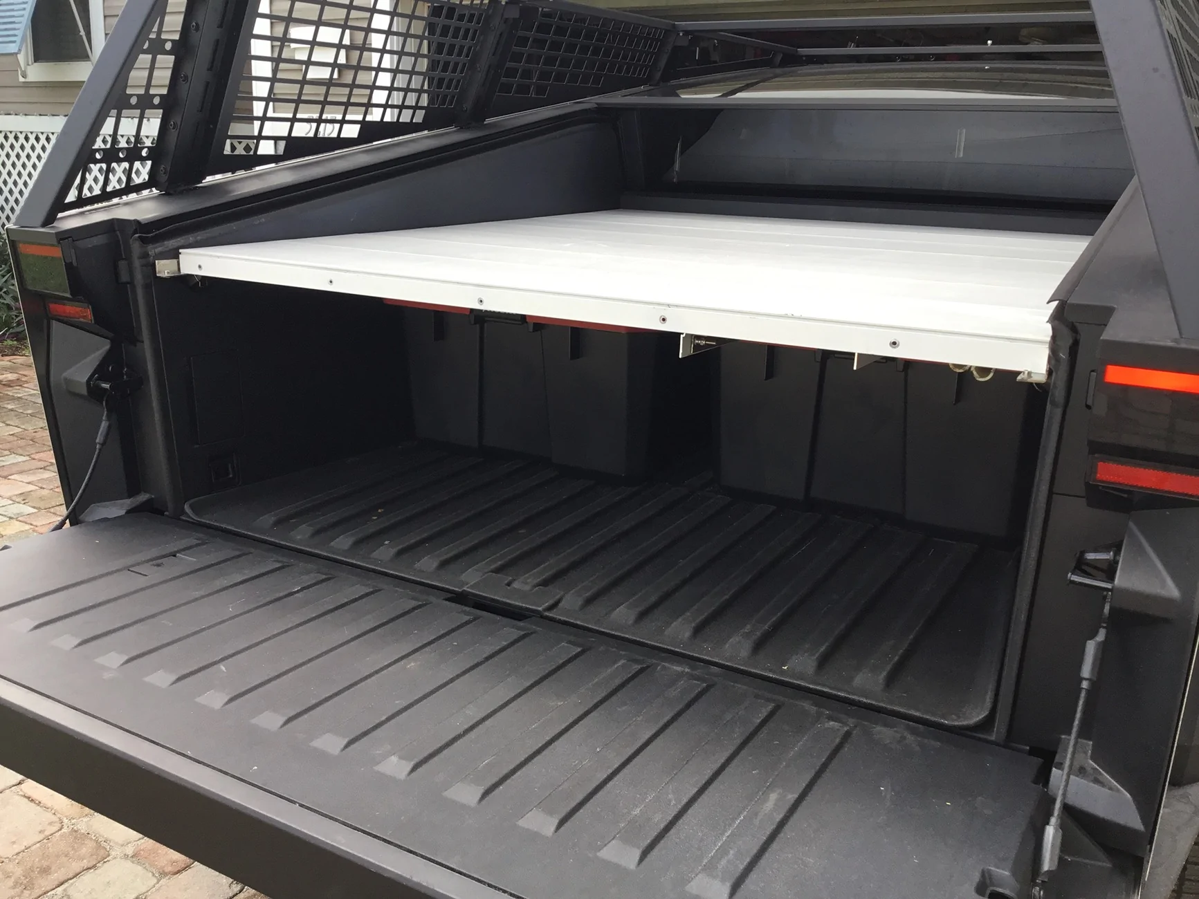

Here is a platform made of a series of 9 in wide by 1.5 in deep extruded aluminum "C" sections that are .125 in or 1/8th in thickness. It's rigid, light, stows in a very small space and can be dismantled and outta there in 2 minutes. Found this in the local scrap metal place nearby. Cost was $110 including SS "L" rails to mount sections on. The rails are sitting on 4 hold downs each side. The SS rails are kept in place by the length of the sections, nothing else. One rivet nut and SS bolt secures the last section to extend platform long enuf for my 6ft height. The light strip is covered but it's a cold white light, we will use a string of warmer lights when I get around to a tent covering (later). I don't know where it comes from or what it is.... if anyone knows please respond?
