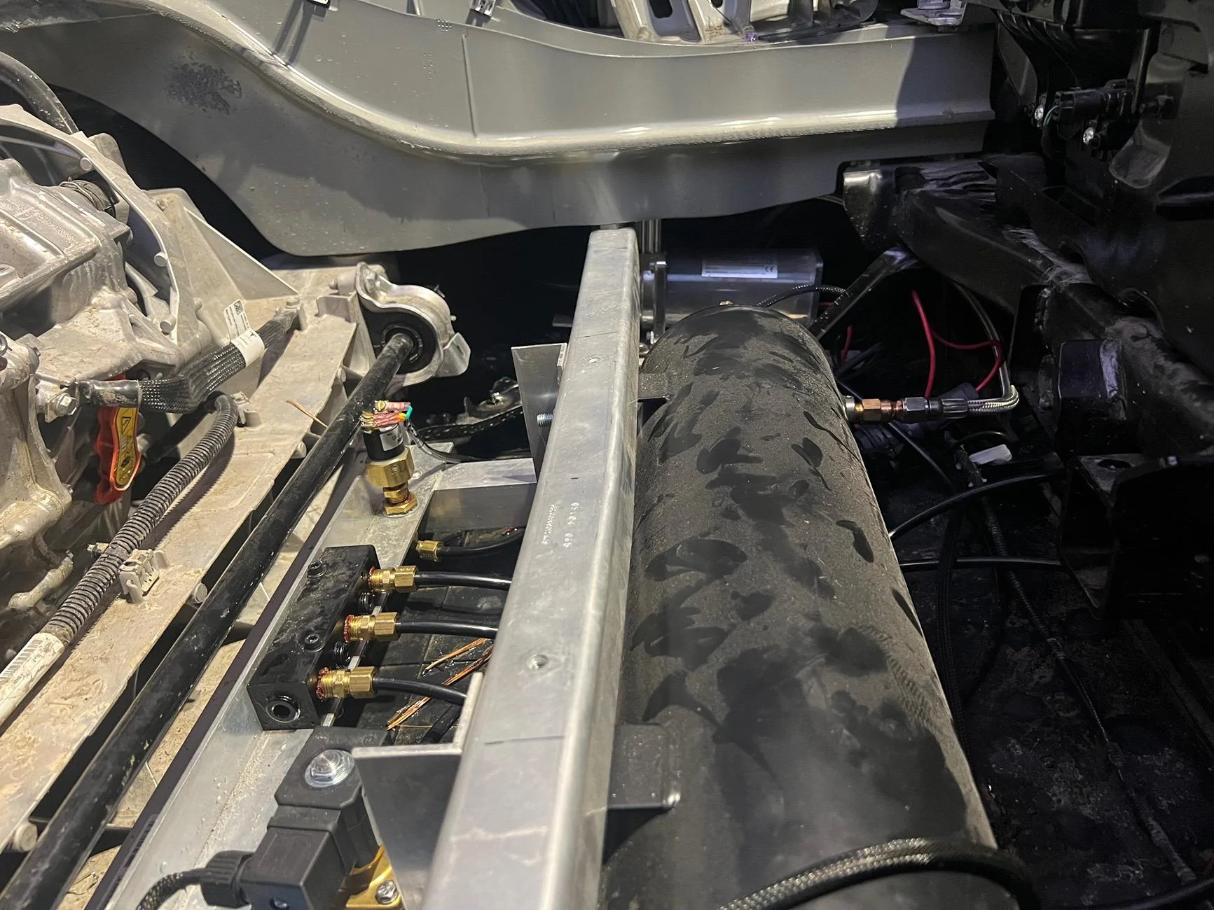

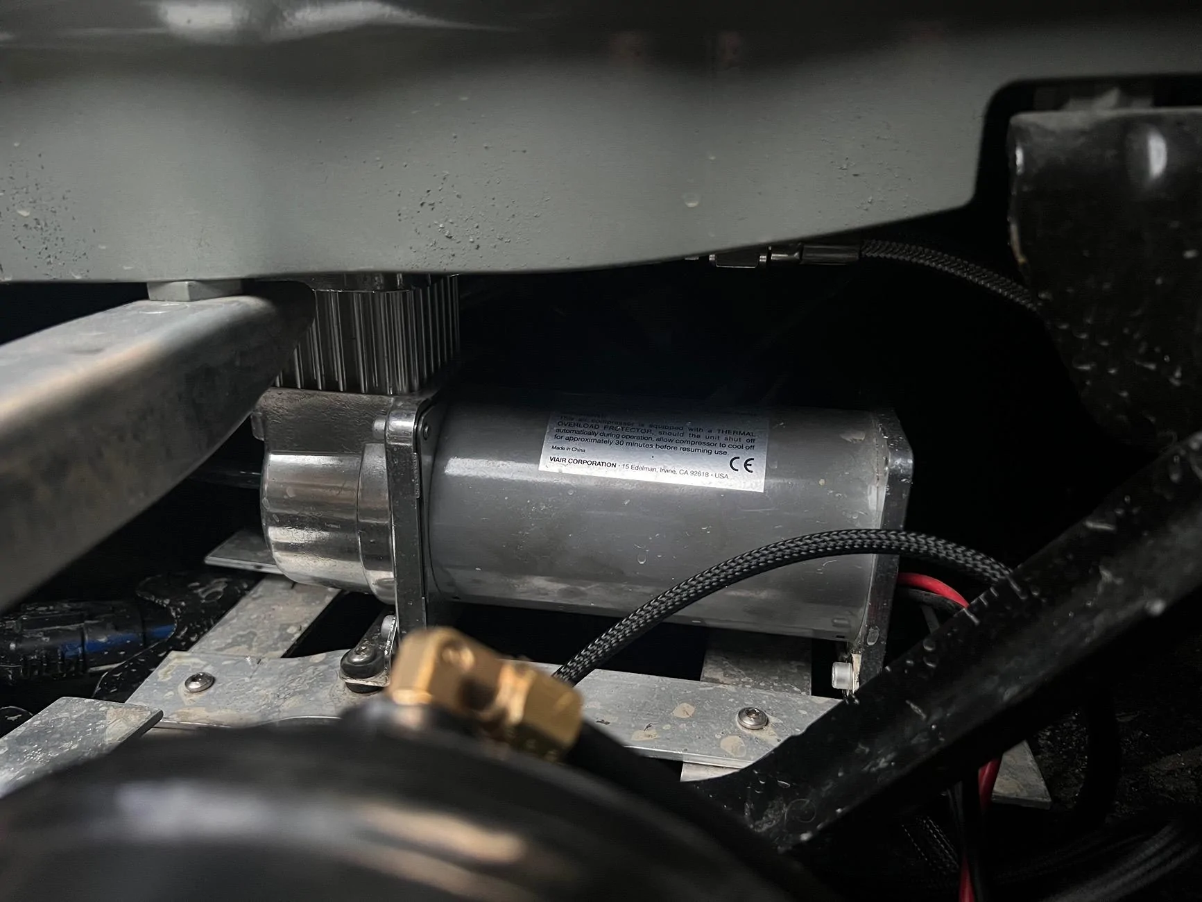

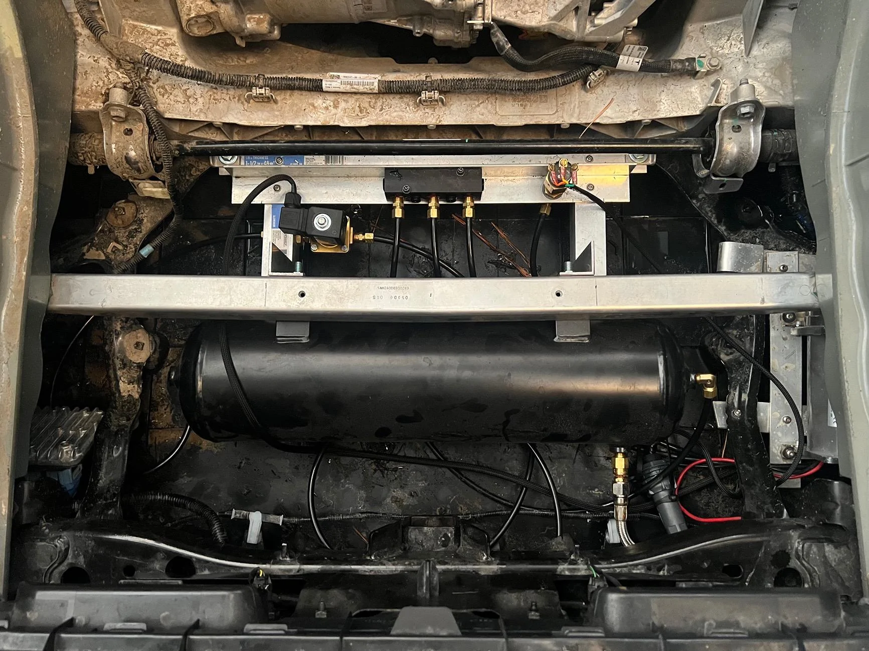

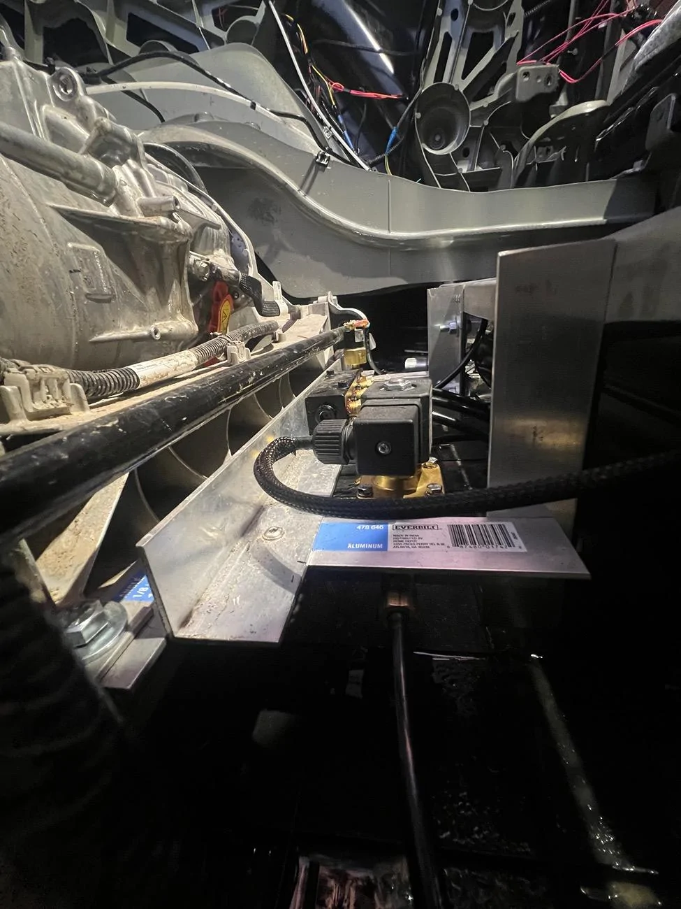

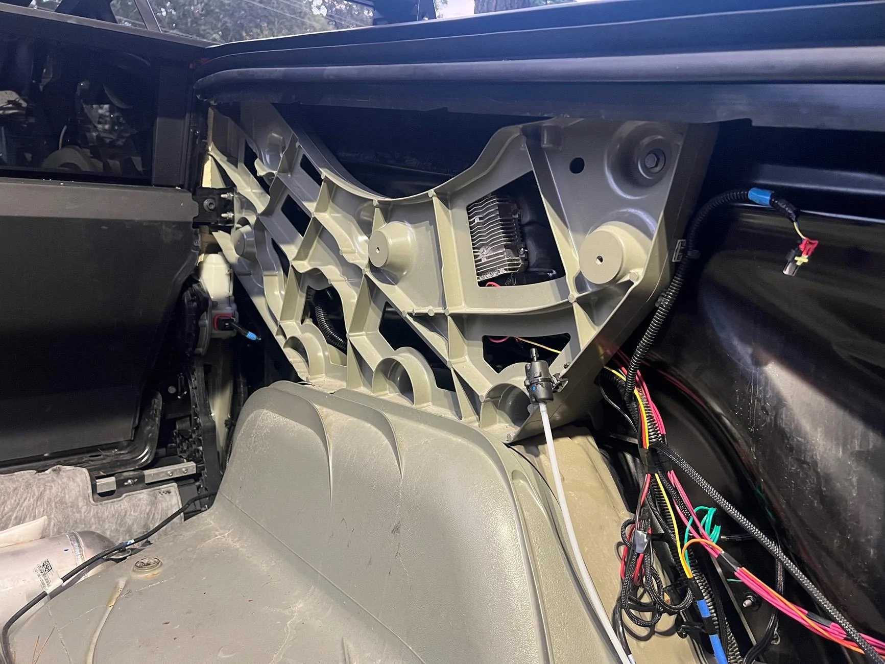

Found an air compressor and tank that fit in the space underneath the smugglers bay. Wasn’t the cheapest option, but works pretty well. Power is taken from the roof 48V using a 48v-24v DC-DC converter mounted inside the side wall.
Compressor: 200psi/24v VIAIR 330C-HG
Tank: 2.5gal VIAIR

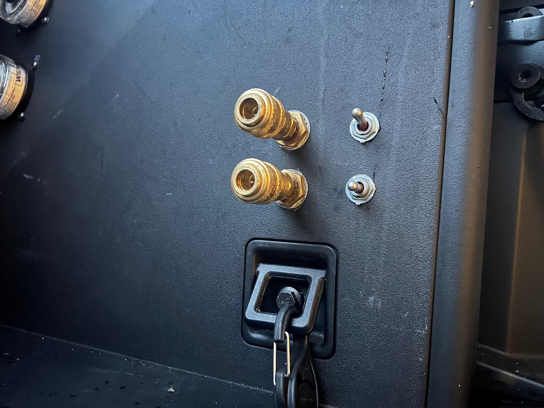

That's a great point, definitely not ideal (I've caught them on a few things and almost impaled a watermelon once).
The smugglers bay would be a great option but a pain to get to when the bed is packed. Eventually I plan to recess the connections and switches behind the sidewall with a small cover (similar to the power outlets on the opposite side).

That wouldn't be a good idea because the air suspension uses a higher pressure compressor (somewhere around 350-400 psi) designed for lower volumes. Tires need low pressure air at higher volumes. It's very inefficient to compress the air more than necessary to fill the tires.

Is there a drain at the low point of the tank to drain the condensed water out?
There is, the solenoid on the left side connects to the bottom of the tank and vents out just below the hitch. The bottom power switch is a three position switch wired such that holding it in the spring loaded down position drains the tank.
