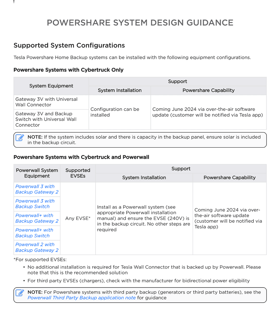

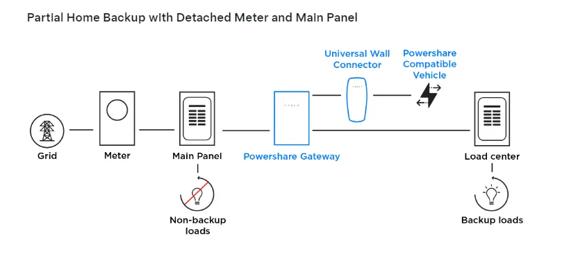

I have encountered many people that have questions about the Powershare feature, what is currently required for install, and how it works.
At the time of this writing, to use the Powershare feature, a Universal Connector and Powershare Gateway must be installed. No other gateway or connector will work. Also, the home cannot have A/C coupled solar or battery. The reason being that Tesla has not yet fully developed the metering required to monitor frequency shift during an outage, which would potentially cause a hazardous direct short. This will change as hardware compatibility develops.
When using a Gateway, the loads that are being backed up will need to be moved from the existing electrical panel to circuits within the gateway or to a new load center connected to the gateway.
As always with Tesla, the best is yet to come. As they develop the required hardware and software compatibility across their components later this year.

Here is a timeline of expected configuration availability from Tesla

From Tesla https://www.tesla.com/support/powershare
For Customers With Powerwall
If your home is equipped with Powerwall and home charging, you do not require any additional equipment. Powershare Home Backup functionality with Powerwall is expected to be available later this year through an over-the-air update. All Powerwall models will be compatible with Powershare Home Backup in the future.2
Also:
"If you are adding a Powerwall to your home, we recommend installing Powerwall first to avoid any additional hardware and installation costs later. "
