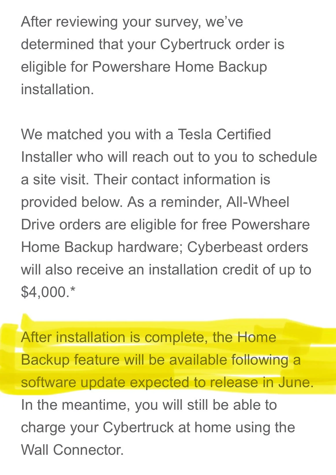

Got this email today that eludes to a June software update for the power share.
The June software update would coincide with the planned initial release of the Cyberbeasts to non-employees. Another piece of the puzzle fall in place.?

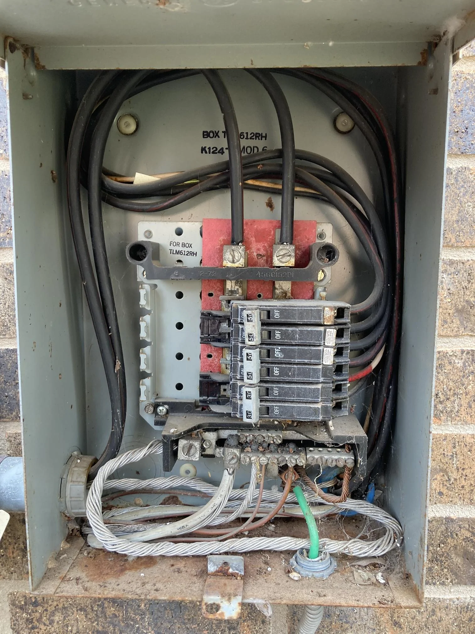

I too hope to enjoy the rebate, but my install will be significantly more expensive since I must replace my main panel.
I thought the same since my main panel was old and didn’t have a main disconnect. With the Tesla Gateway, it becomes your main panel and provides the disconnect. My old main panel will be demoted to serve as a second sub panel.
They told me "your current electric service cannot support the charger". I also have no main cutoff but 3 ganged circuits totaling 160A (50+50, 50+50, 30+30) so it seem like enough...?
