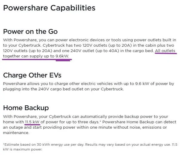

No thanks, ill just backfeed my panel with the 240 outlet in the bed of the truck
Downside is
9.6 kW for V2L [40a * 240v / 1000]
11.5 kW for Powershare [48a * 240v / 1000]

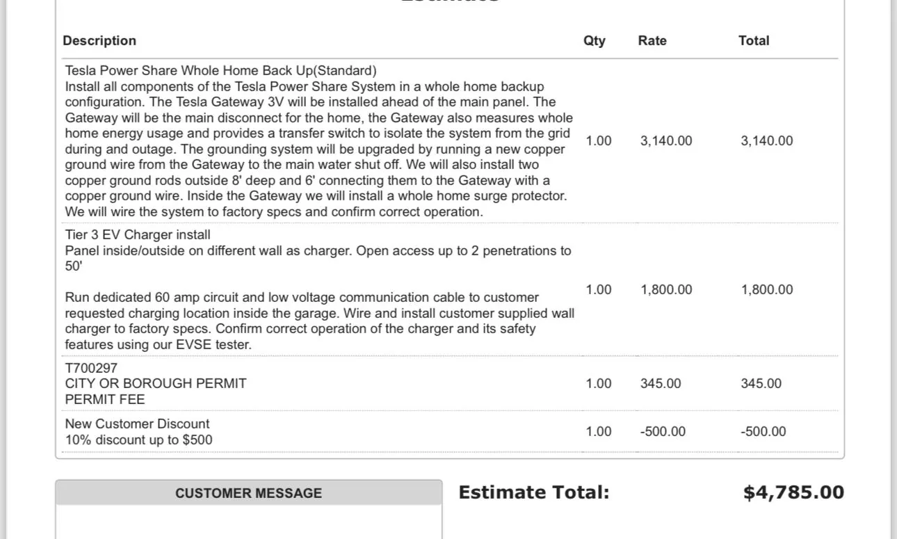

I've been very curious about the details around the Powershare. Who will install it, how much it will be, what it will entail, etc. I've been searching the internet for the past few weeks and finally think I have some good information to share. I've listed out the info below to make it easier to read. Let me know if you have any questions.
POWERSHARE INSTALLERS
1. Smart Charge America
2. Gulfstar Electric (Only Florida?)
3. Connected Technology (North California)
4. Solar Smart Living (West Texas)
1. There are several companies quoting the PowerShare with 3V Gateway. The main company I found is called Smart Charge America. *Watch the video at the end of this post from Smart Charge America with more details on the 3V Powershare install for Cybertruck*
2. Sounds like there will be two options: 1. Whole home backup. In this case the 3V Gateway will go between your meter and your home panel and will power the entire home. They can exclude very large loads that the truck may not be able to power. 2. Partial Home Backup. This one is a little less clear on how the install will work. I think you have to option of installing it between the meter and main panel and then using the included circuit breaker spots in the Gateway to chose what to power OR or you might be able to power an existing subpanel with your backup loads already in it. I asked for clarification from Smart Charge America and I'm waiting to hear back.
3. Seems like installation can run anywhere between $2,000 - $6,000 on average depending on where your panel is, where the charger will be and other factors. This makes sense since Cyberbeast owners are getting a $4,000 credit which would be the average install cost.
4. *UPDATE* Per a recent email received from Tesla, the Powershare home backup software/firmware will not be available until June. So, you may be able to get everything installed, but you can't use it as a home backup until June when an updated software/firmware is pushed.
This information is as accurate as possible, but I'm not sure that all of it is 100% accurate. It's information I have found in several different sources and thought I'd share so some people have more information on this system and what to expect.
My quote

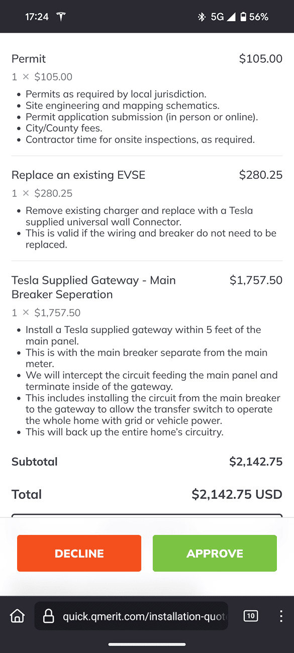

Here is my quote for install $2142. I already have a 14-50 outlet on a dedicated 60a breaker in the garage so for that they just swap the outlet for the charger.

Hopefully your 14-50 conduit has enough room for a comm wire because the UWC needs that in order to talk to the Gateway. That’s the difference between the regular WC and the UWC and how they get PowerShare to work.
