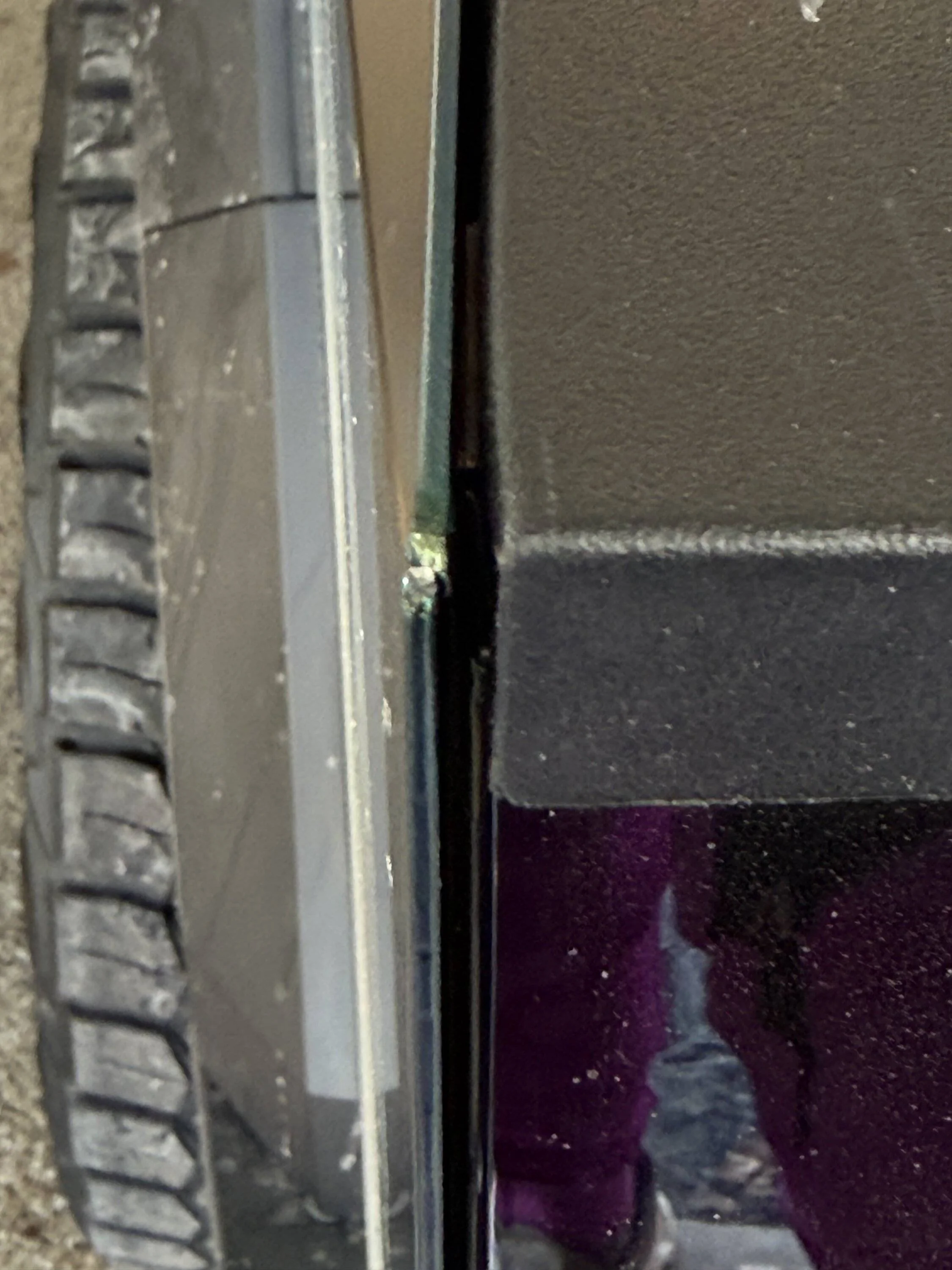

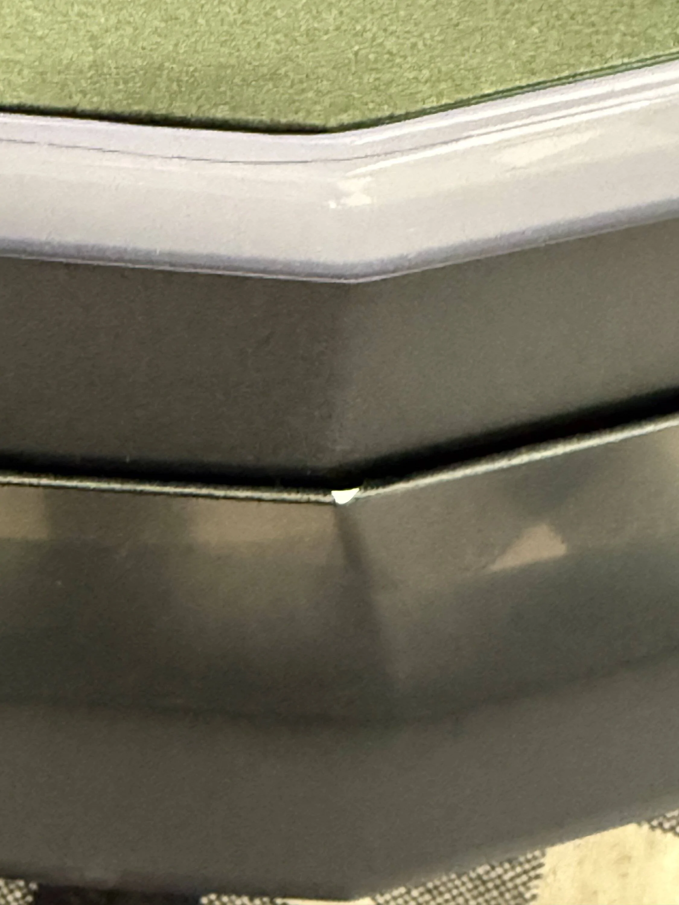

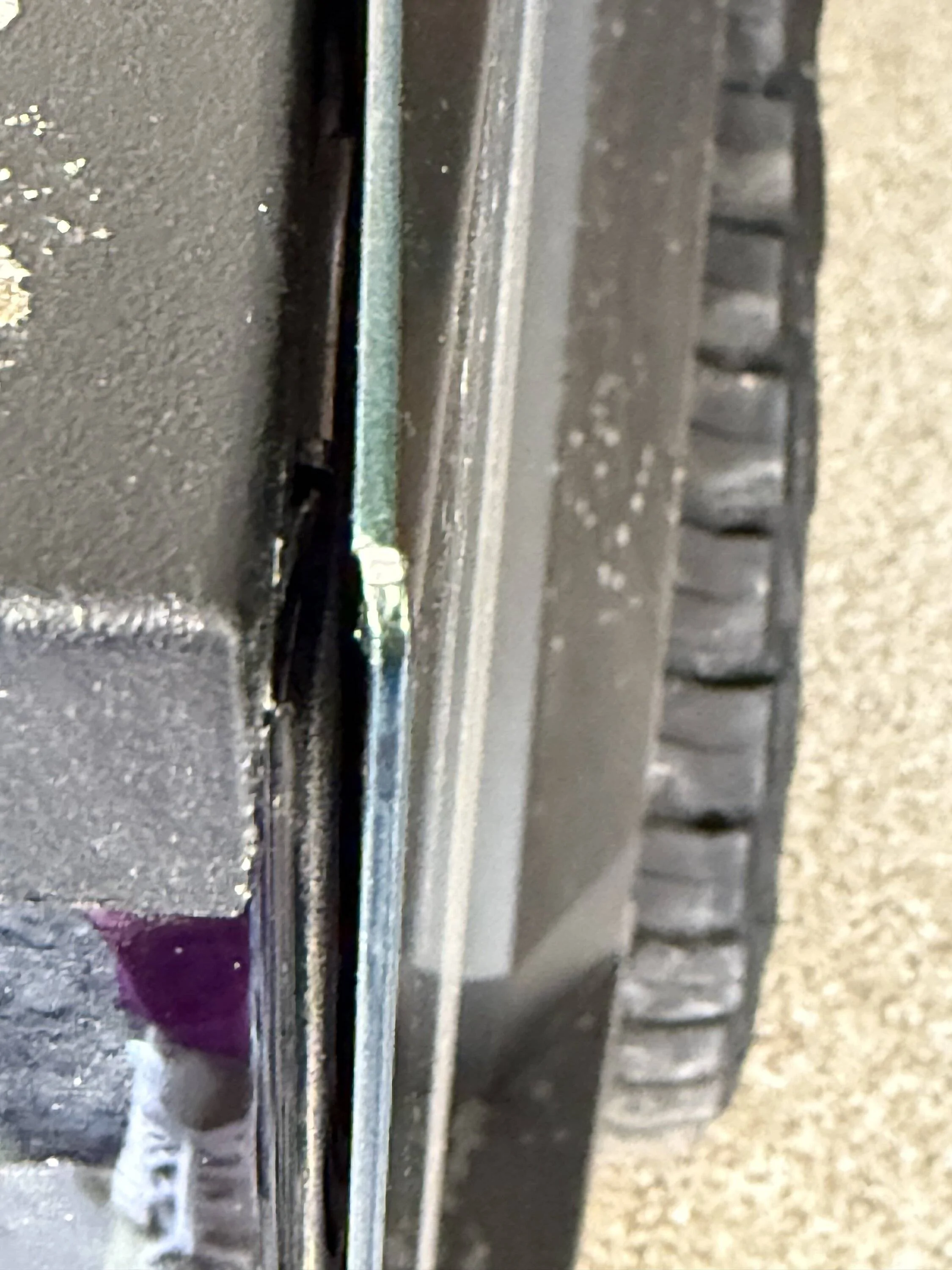

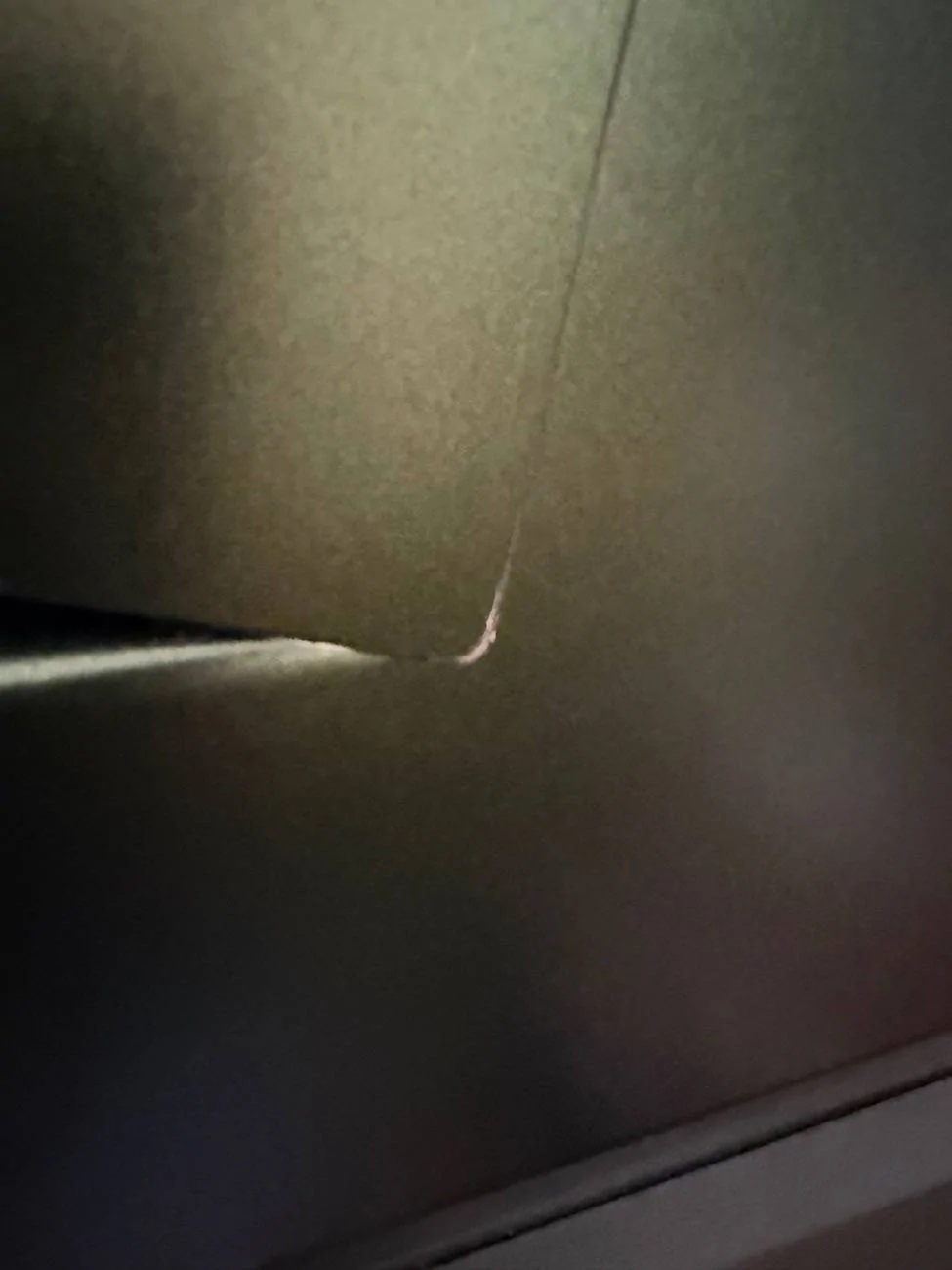

After a thorough second look it seems that the installer cut the wrap at the edge corners in order to bend it thus leaving a small bald spot (.5-1mm) at almost every edge corner. Anyone heard of this before?
For $6k that should not happen! We charge a lot less than that and achieve PERFECTION. So definitely talk to the installer to make things right. Did you try contacting them? What did they say?

I have not yet. He is going to do a 2 week inspection and detail. I plan to tell him then. Here is the work at distance for some additional perspective.

At distance small imperfections are usually not visible. Definitely a beautiful color on a beautiful truck!!! :) As I said, if the shop wants good reputation, they'll make it right. I'd understand something tiny somewhere hardly visible, but all edges showing steel and lifting up is not good. But give them a chance, address it politely with them and ask them to fix it. Maybe they are not ill intended or anything, but just had a bad day or something when working on your wrap - it's human, it happens.

This is not an acceptable installation for a $6,000 job. The visible edges and gaps you pointed out are installation errors, not normal industry standards.
What you're seeing in the photos:
  • Inconsistent Gaps: The space between the film and the panel edge is not uniform.
  • Missed Coverage: The film is cut too short, leaving painted edges exposed to chips, dirt, and peeling.
  • Lack of Wrapping: A premium install often involves "wrapping" the film over the edge and onto the back side of the panel for a seamless look and total protection.
Your next steps:
  1. Do Not Accept The Vehicle. Speak with the shop manager immediately.
  2. Show Them These Photos. Clearly point out each flawed edge.
  3. Request a Re-Do. The affected panels need to be completely redone by a more experienced installer. For this price, you paid for precision.
A top-tier PPF job should be virtually undetectable. Your expectations are correct—hold them to it.
AO-Pete
Pete
May 6, 2024
441
615
