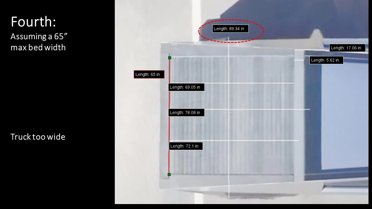

On the point of bed width and out of curiosity: I used my pixel ruler utility on the bed width, and applied two competing assumptions about bed width to see how it affected resulting proportions of other portions of the truck.
NOT 65" WIDE
On one end of the spectrum, I told my pixel ruler to assume that the bed width is 65" wide, between inner sail edge. That 65" bed width assumption is too large, even accounting for a significant margin of error in my point selections for measuring. It results in the truck measuring (proportionally) 89" wide, which is too oversized.

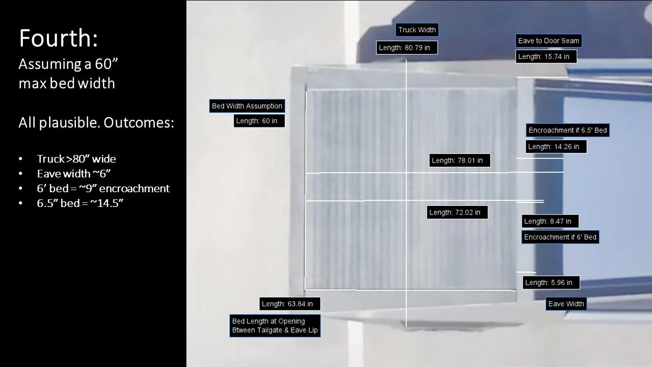

60" WIDE BED - PLAUSIBLE
I next assumed the bed width between sails is 60" wide, and all the results seem plausible, allowing for a margin of error in my point selection for measurement. That said, I would begin to think that the 6.5' bed measurement (not subject to a margin of error) appears to begin to encroach too far into the cabin, but too close to call, really.
Biggest thing to note is that results in the truck being well over 80" width requiring amber marker lights - though, with a margin of error for my measurement point selection (particularly on identifying the edge of those fender flares) it's a hard to rely on that.

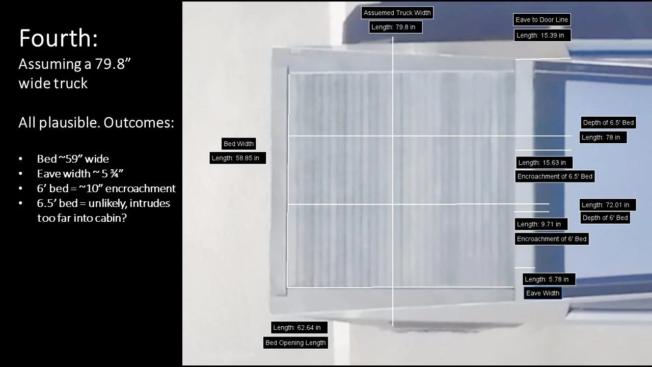

PLAUSIBLE THAT TRUCK IS ~79.8" WIDE
Since I had the measurement utility up, I did one last assumption: that the CT is the same width as normal 1/2 ton trucks, always a fraction of an inch below the 80" amber marker light threshold.
Biggest takeaway is that this assumption results in too much encroachment into the cabin by a 6.5' bed measurement (not subject to a margin of error).
NOT 65" WIDE

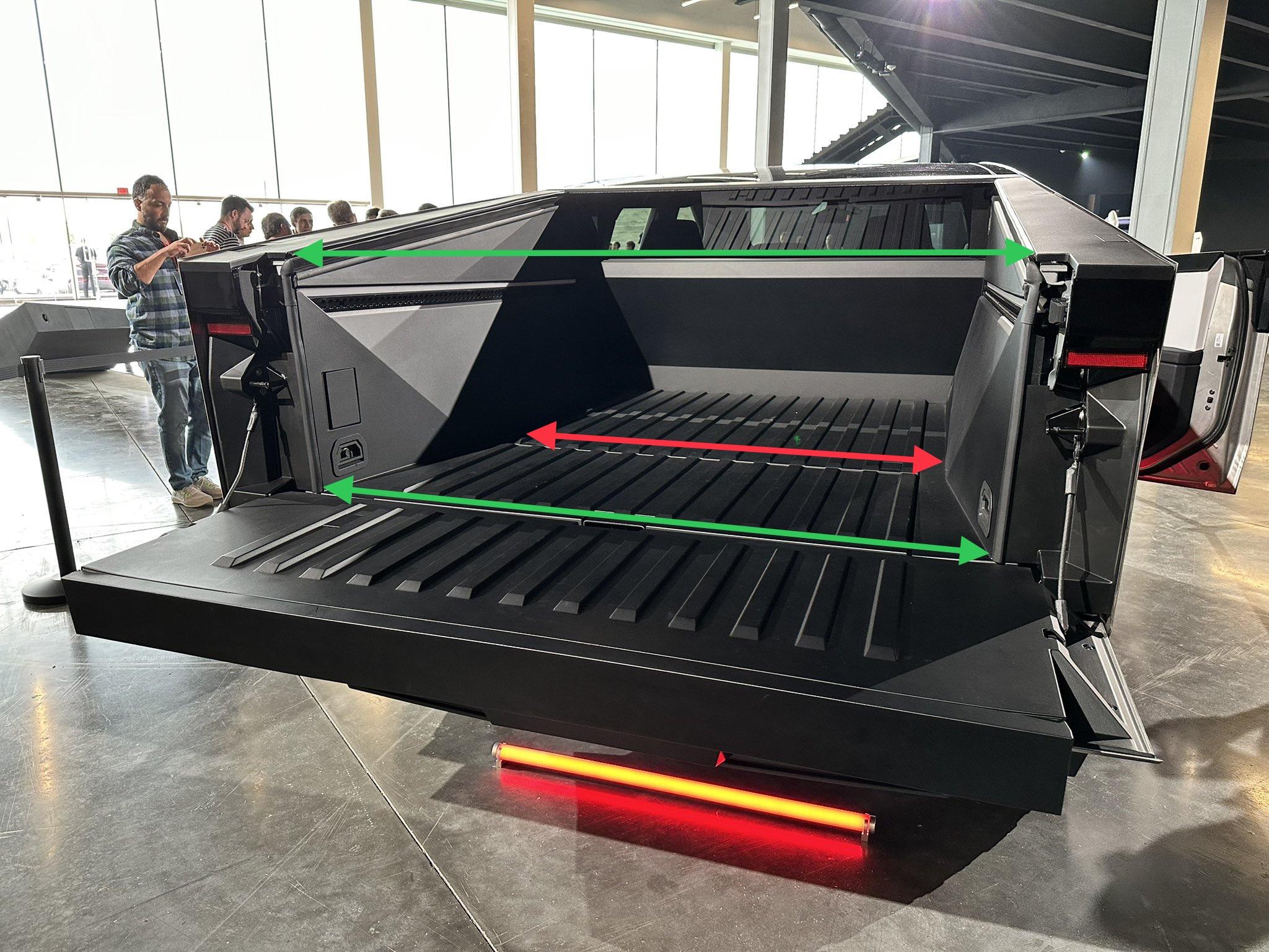

I think its safe to assume 4' between the wheel wells like all other full size pickups in order to carry 4x8 sheet goods.
7,153
13,769
yes, me too, as for the narrowest potion of the bed floor (in red below)
conversely, the bed width I was measuring is at the widest portion (in green below)
