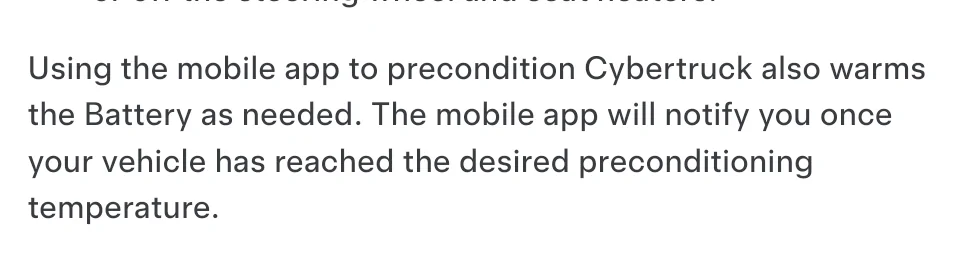

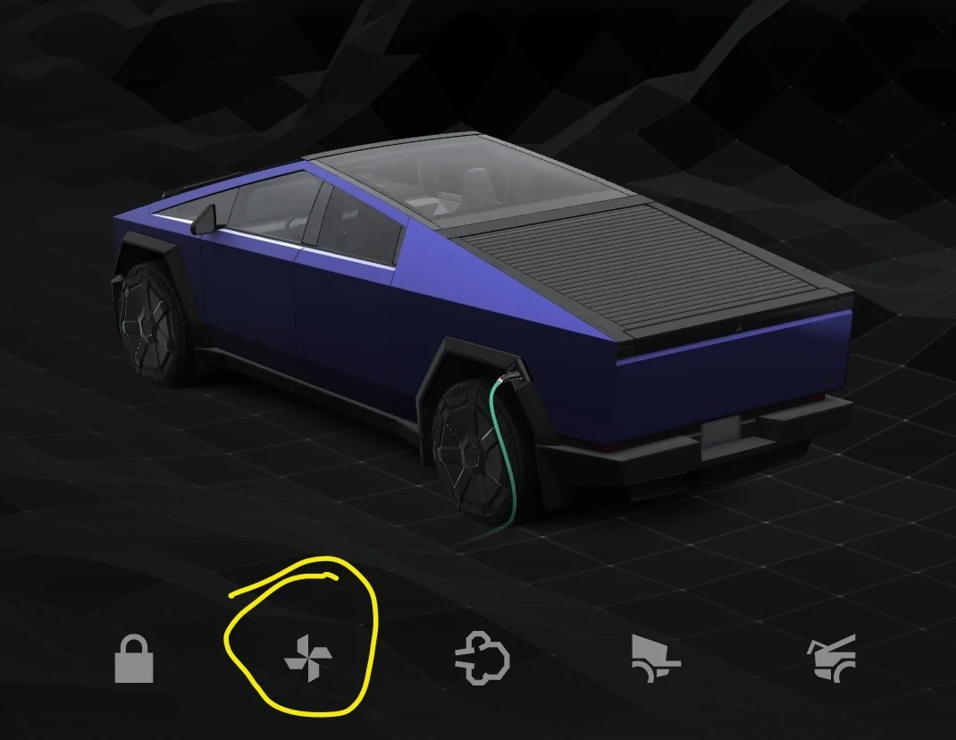

Asking from the app
In the house, planning on a run to rhe charger
What in the app can I do?
nav send to the truck does not do it
So no home charging?
Preconditioning from the app will warm the pack, but wastes energy on cabin heat also.
You can set the destination and just sit in the truck in your driveway, but that isn't going to speed things up in terms of your time.
