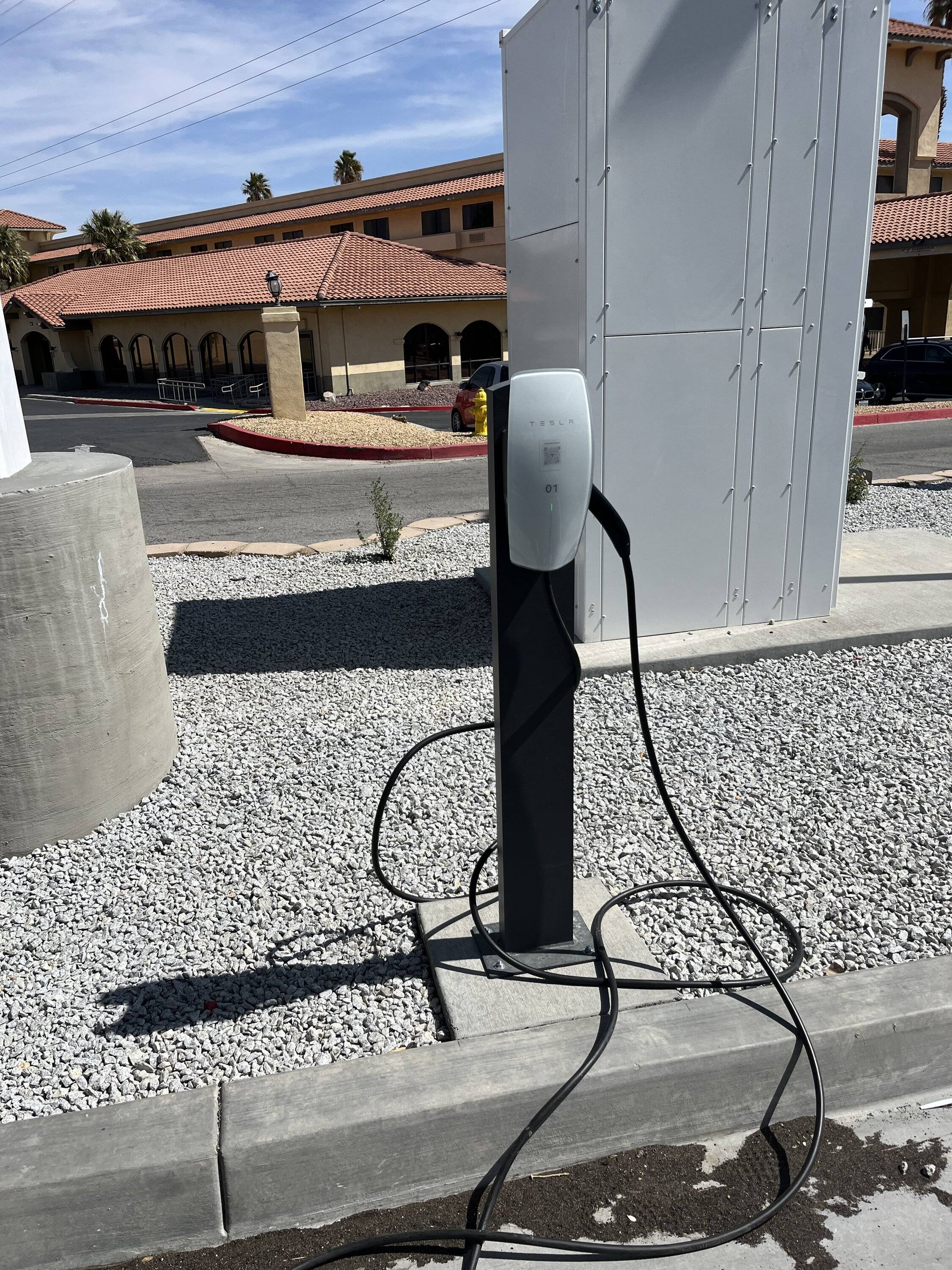

Charging in Barstow with a crap ton of new charge stations but saw these guys off to the side and wonder how much juice the pump?

Looks like a level 2 charger, not a supercharger. So max would be somewhere around 11.5 kw depending on the service. These cant charge nearly as fast due to limitations of the onboard charger, the supercharger bypasses the onboard charger if I remember correctly.
You'd be better to charge on that until a supercharger opens up and then move if possible!

Probably 50amp - looks like regular home charger/cable. Scan tie barcode and see if there are details.

yep those look to be "Destination Chargers" you find at hotels about 10-12kw 40amps x 220v

Worse, they'll max at 48A, but almost always be 208V since they're wired off commercial service. ~15% slower than charging at home.
