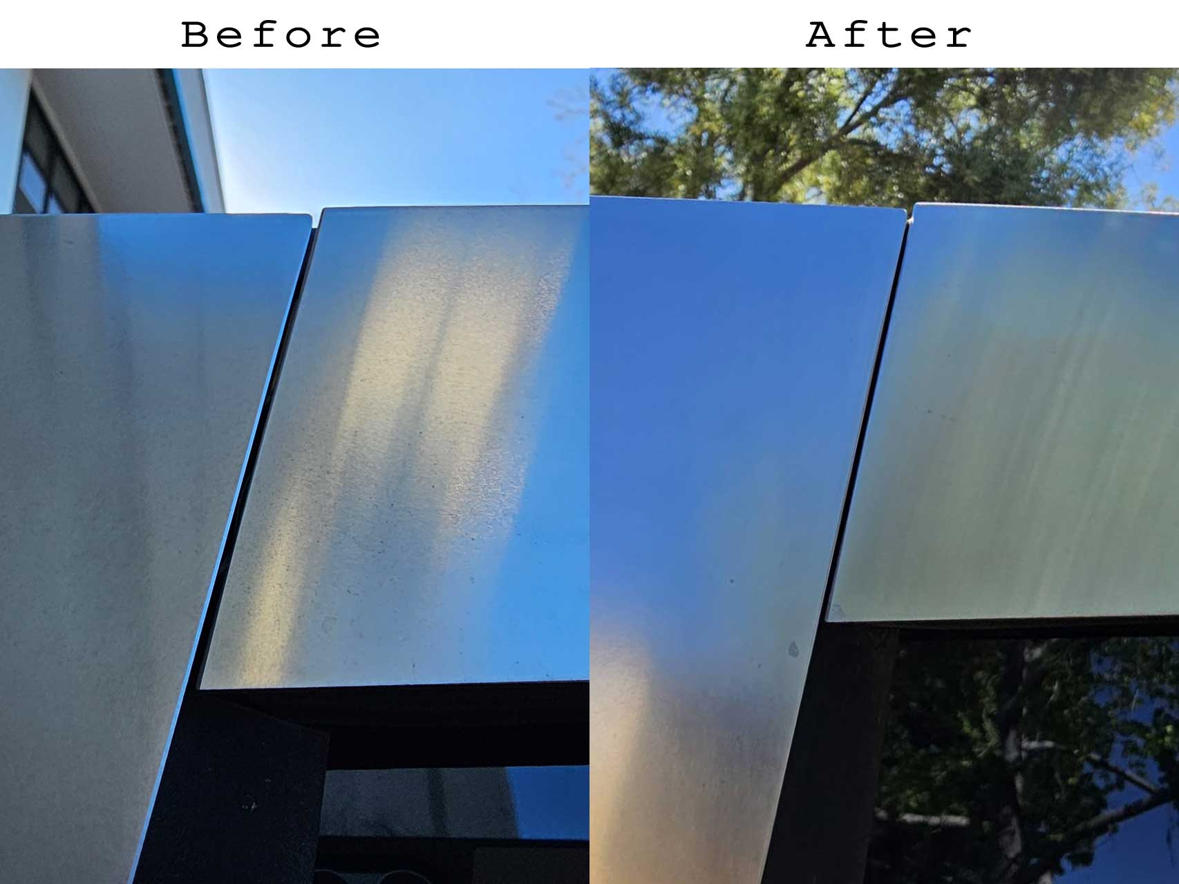

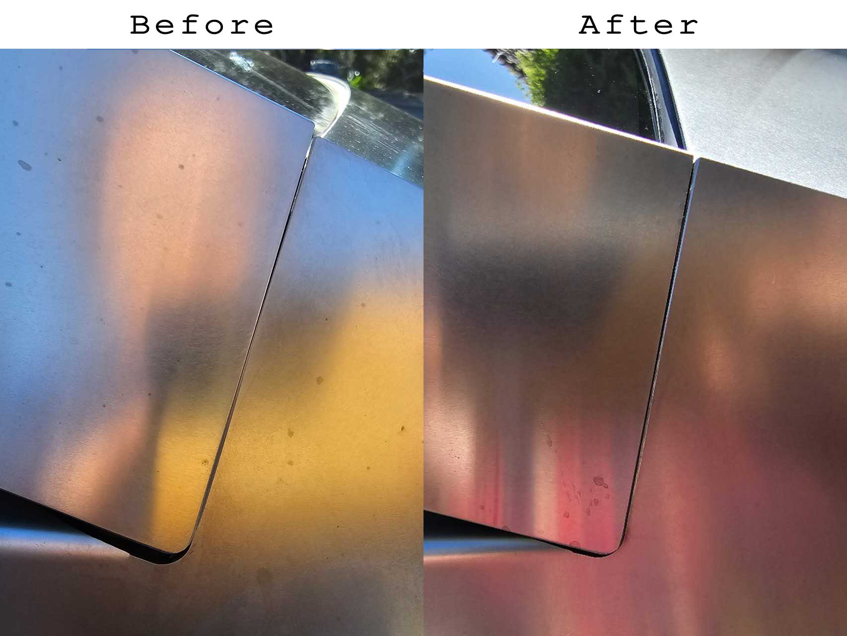

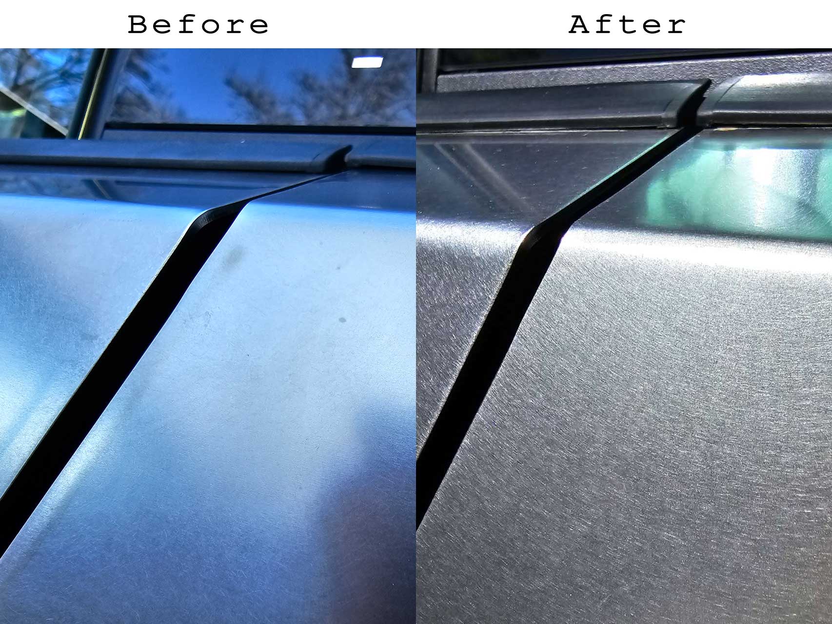

For the misalignments, I was told they have to measure them to determine whether they need repair according to the standard. And repairing them could cause new misalignments at the other sides of the panels, besides may causing new seal/wind noise problems. Here are the results:
Between driver side doors. It wasn't that bad when looked at in real life. It's just the camera angle.

Above the passenger side rear door. I think it is untouched. Maybe it is not misaligned enough.

Above the driver side rear door. I would say improved.

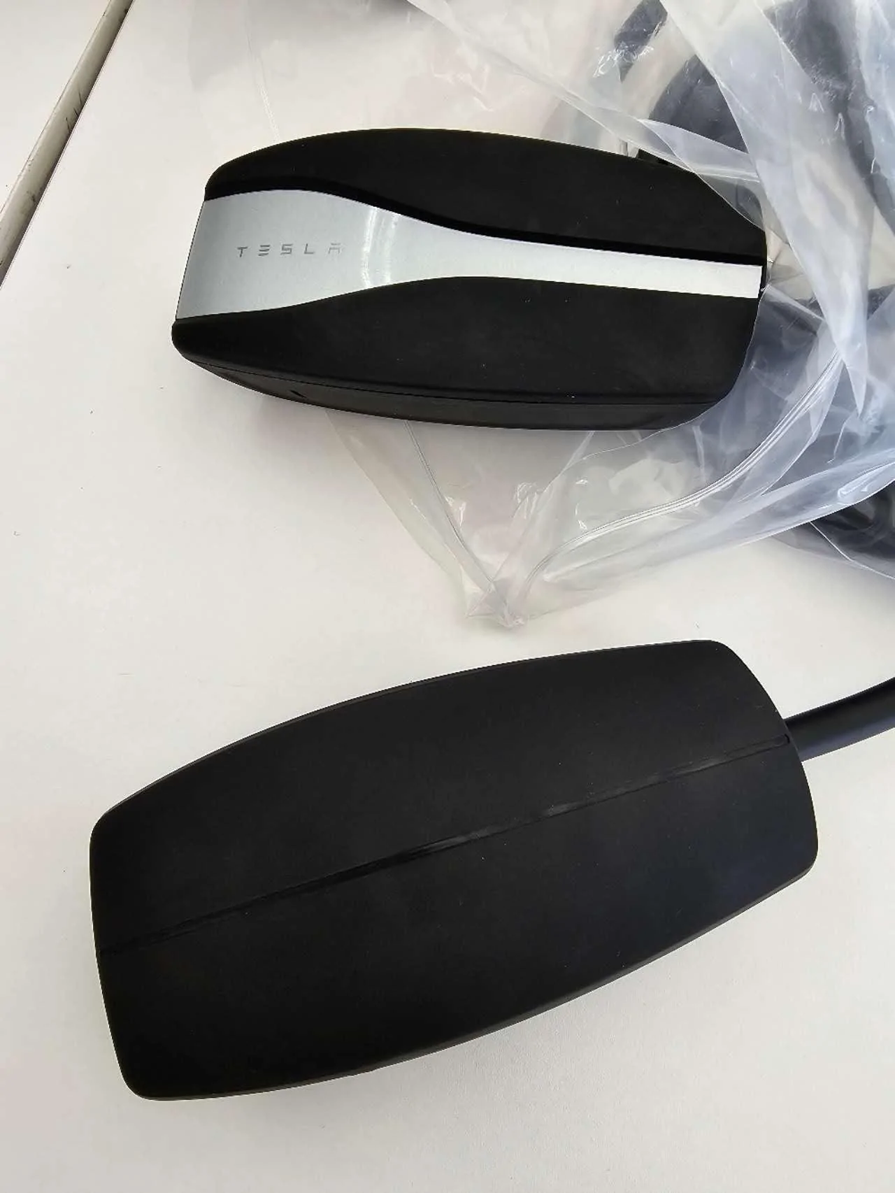

For the mobile charger, only 6A conformed. When I submitted the service request in the app, I was directed to Tesla Wall Connector Support, then instructed to go to Service Center Team to get it tested at a service center. Now it is tested, I was given 2 options waiting for ordering a new one or pick up a non-CT one (The top one in the photo below. I didn't even know there is a difference.).

You will want the mobile charge with the CT it can do power share with another EV car. The white version is a version 2 I think and it goes one way.
