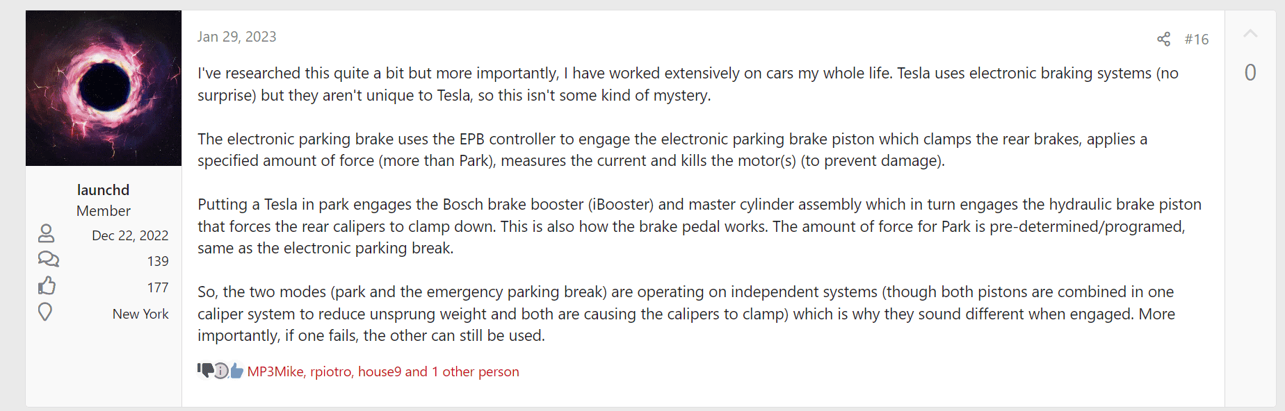

yeah, there is a semantic issue in the manual. this post seems to explain it.
Tesla Cybertruck Question for all the boaters out there -- "parking brake not holding" message when launching / retrieving boat 1720727267451-ph
https://teslamotorsclub.com/tmc/threads/p-mode-vs-park-mode.292373/
Independent clamping systems and different clamping forces.
As referenced later in the thread, there's a separate thread calling out higher voltages sent to the clamping system for the parking brake vs park.
https://www.teslaownersonline.com/threads/difference-between-park-park.11442/page-3
So take your pick of assumptions on how it works, but the system is not precisely the same, unclamping and reclamping the same way when you engage the parking brake.

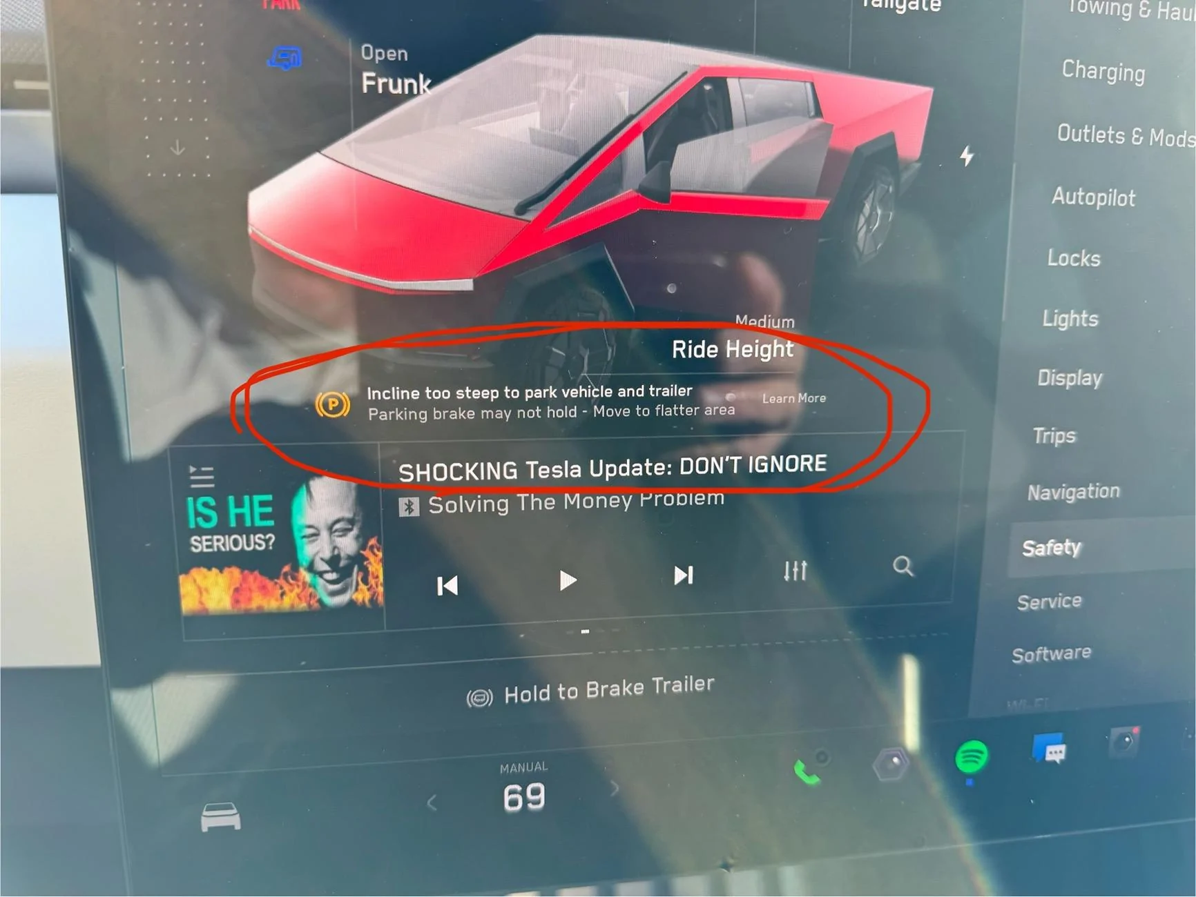

Yeah, I have no trailer brakes so that isn’t an option for me. I just don’t understand why it’s a warning. The ramp is not to steep and my boat trailer. It’s not that heavy. I’ve just been throwing a chalk under one of the wheels.
May 27, 2024
4,580
5,563
The Cybertruck can't necessarily know the weight of the trailer especially since you could load it after parking. So it displays a warning if the braking force could be insufficient.
If angle > EPB_limit then display warning
Where EPB_limit is determined by:
sin(EPB_limit)=(parking brake force)/((Max vehicle weight + max trailer weight) *safety factor)

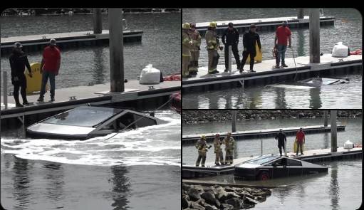

I figured this would have been posted already. Sorry if this is a repeat.
What do you think happened here:
Tesla Cybertruck Question for all the boaters out there -- "parking brake not holding" message when launching / retrieving boat Tesla Boat Launch Fail
I have no idea how that could have happened. I’ve been towing and launching my boat since I picked up my truck in what will be a year, three days from now. I’ve gotten the parking brake message nearly every time and been on some uncomfortably steep ramps without the truck so muck as budging while I’m launching or loading my boat.
It’s almost like that person purposefully backed it in because the truck automatically puts itself in park when you take your seatbelt off.
This is what happens when 1) boat ramps aren't properly descaled and get slick as glass and 2) when people are too embarrassed to use simple wheel chocks.
"hur dur, I don't need nerdy safety equipment"

Across the country someone everyday swamps their truck at a boat ramp, it was just news because it was a cybertruck. Look at any of those reasons why it happened and it will be the same for that truck.
