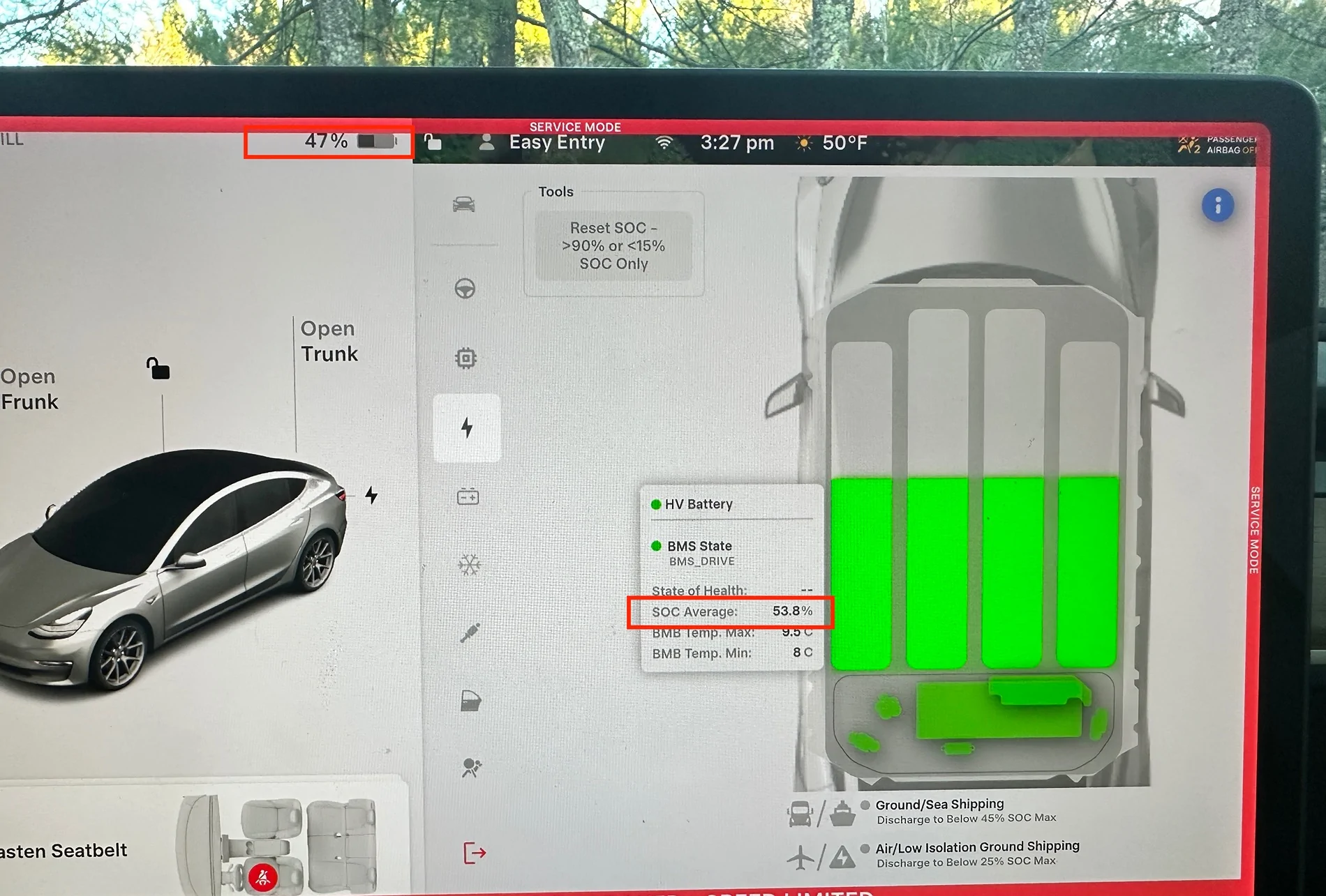

So, one oddity that might point to a bottom buffer can be seen in the service menu. If you go to this screen, it'll show your HV pack, and it gives you a SOC Avg. Here, it's 53.8% and yet my Model 3's SOC is showing as 47%.

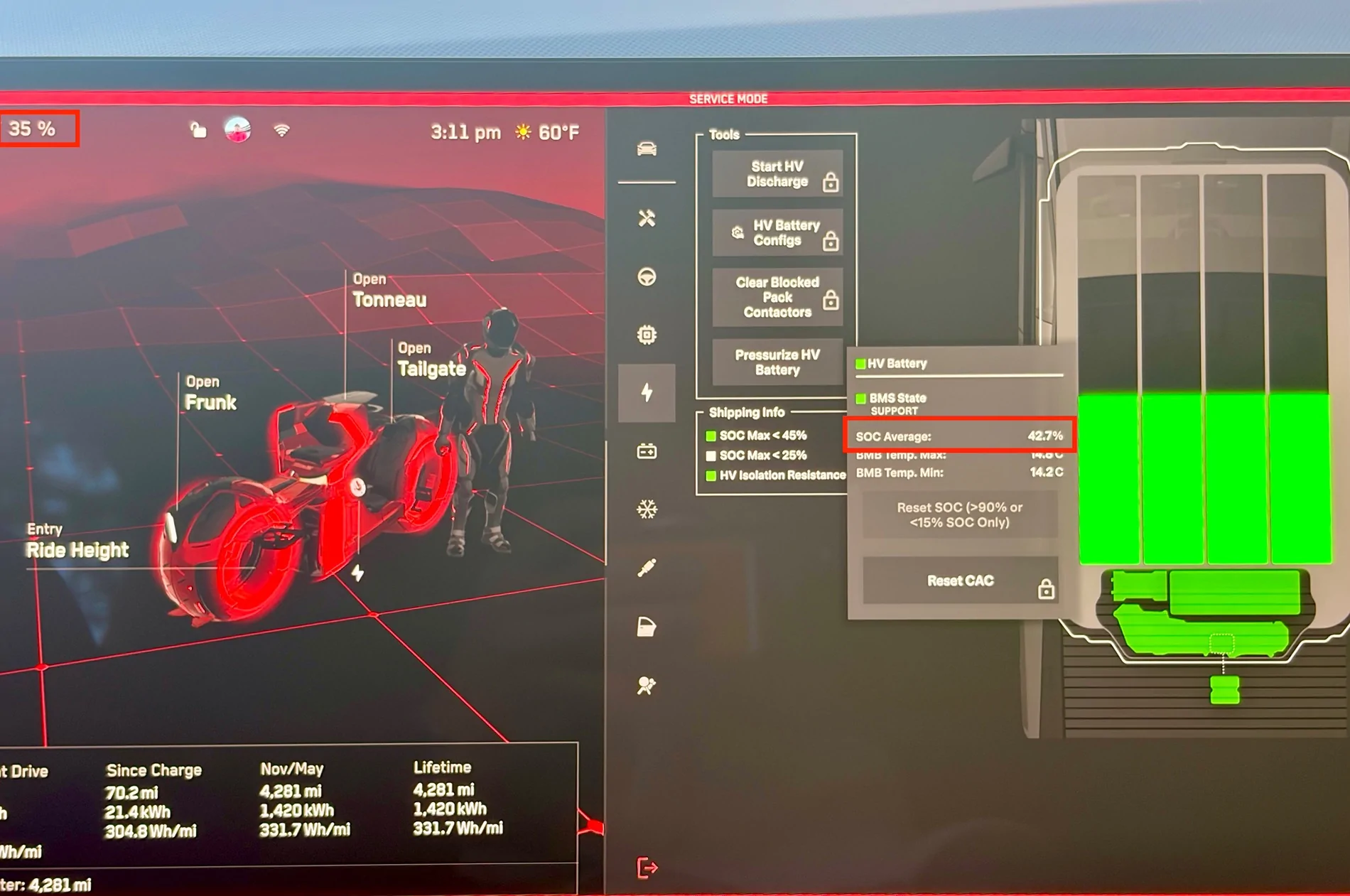

And, yes, there's one on my CT as well. Here it's showing 42.7% as the average of the 4 battery units, but the BMS displays only 35% SOC.

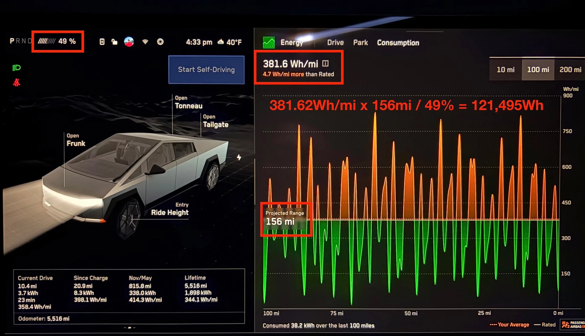

Then, the way I calculate what the BMS thinks my pack size is, is by looking at the Energy Consumption screen. Any mileage range works. Just do the calculation and I get 121.5kWh. There's obviously rounding going on, but close enough:

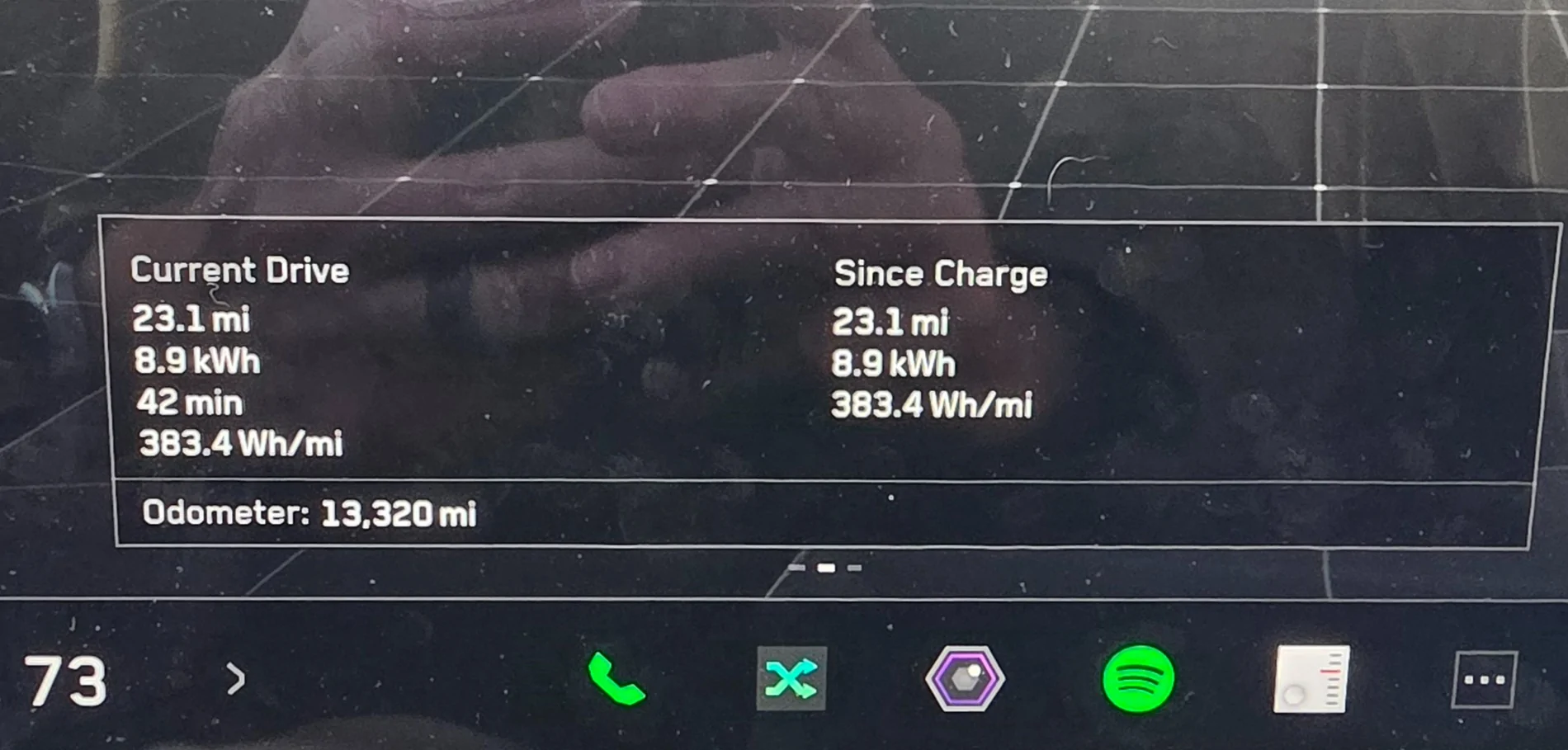

I charged to 80% last night and I am pretty sure I had around 245 miles listed. Seems like it use to be 264 ish miles. It is cold in NC and about 32f this morning. I grabbed this screen for my work drive. Seems like from comments it's right on pare with what folks are seeing. I need to learn more about this and how to monitor better just to understand.
